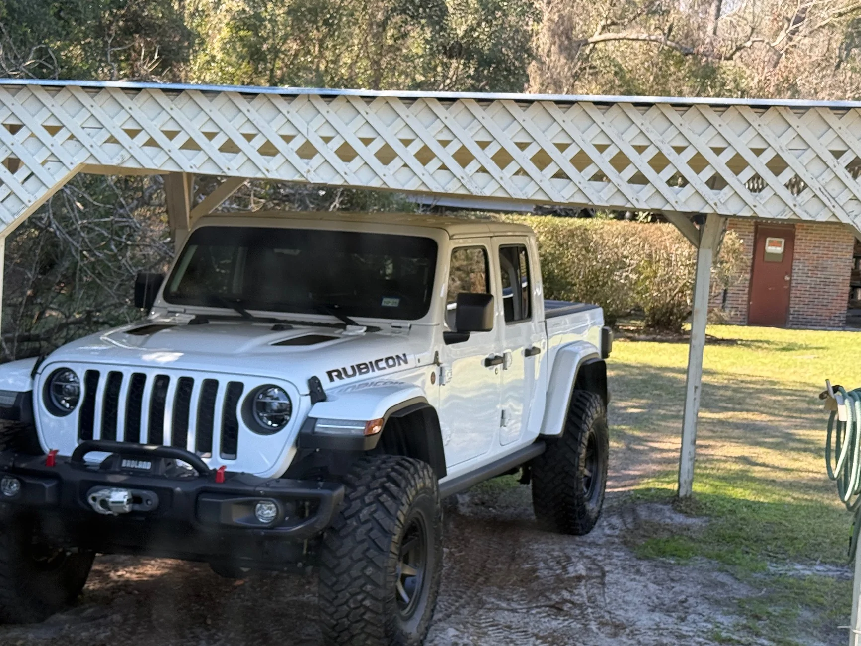

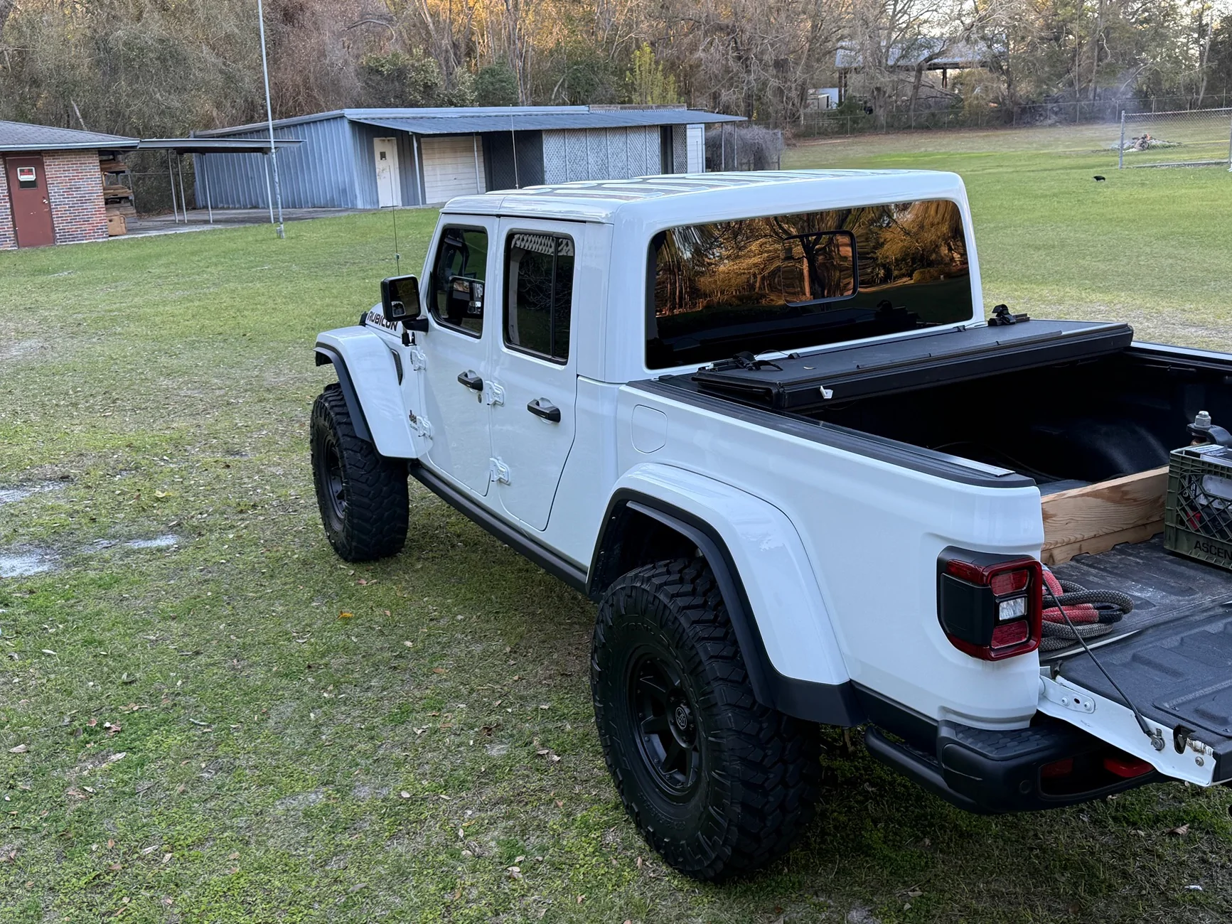

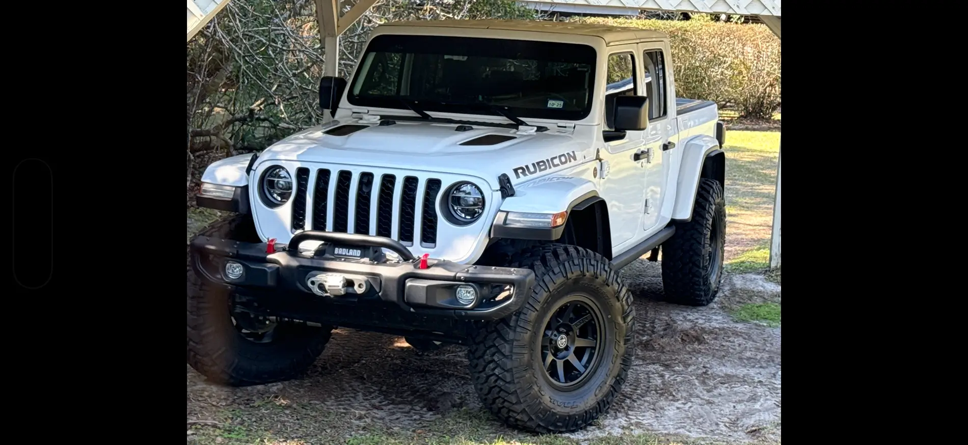

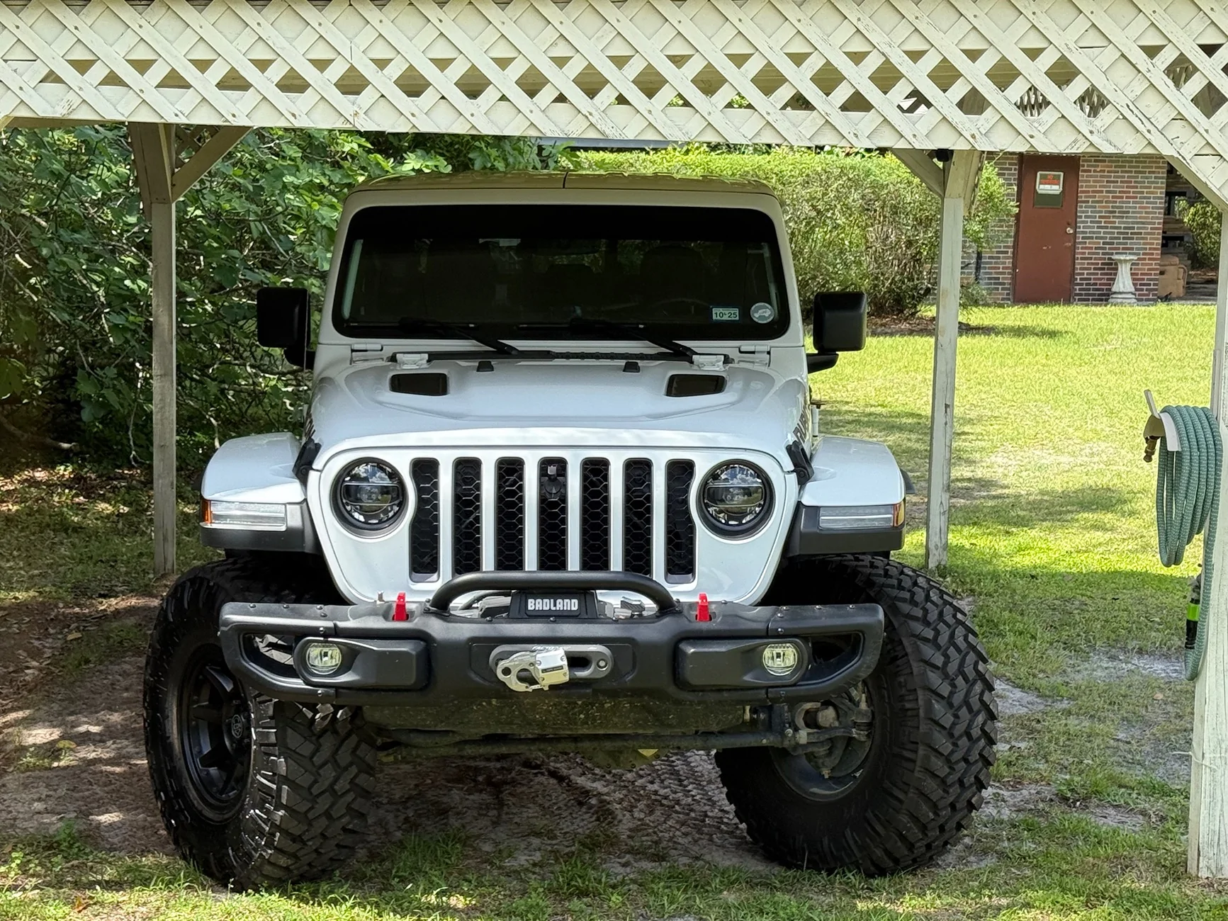

Hi, thank you for clarifying which setup/kit each of these vehicles have.
I like the look of the Rubicon with the 37’s, I have a ‘23 JT Willy’s and I am getting ready to install 37s on it. I believe that the Rubicons come from the factory with about an extra inch of lift versus the sport and willys.
If I were to use the same 3.5 inch lift kit, can I expect the same net height as the Rubicon after it is all said and done or would my JT sit at a lower height than the Rubicon with the same lift kit installed on it?
For reference, this is the diesel overland 2.5 kit with 37’s…
Jeep Gladiator Clayton Off Road JT Suspension Systems IMG_0729
Jeep Gladiator Clayton Off Road JT Suspension Systems IMG_0514
Jeep Gladiator Clayton Off Road JT Suspension Systems IMG_0596
Jeep Gladiator Clayton Off Road JT Suspension Systems IMG_0639
Jeep Gladiator Clayton Off Road JT Suspension Systems IMG_0597
If I’m not mistaken, the Willis comes with standard fender flairs…not the high-line. You would need the 3.5 lift for 37’s or source you some Rubicon take off’s from the interwebs.
Pretty much! The only difference is if you have the non-Rubicon style fenders you would be able to run 37s with the 3.5" kit, and if you did have the Rubicon style fenders you could run up to 39s!

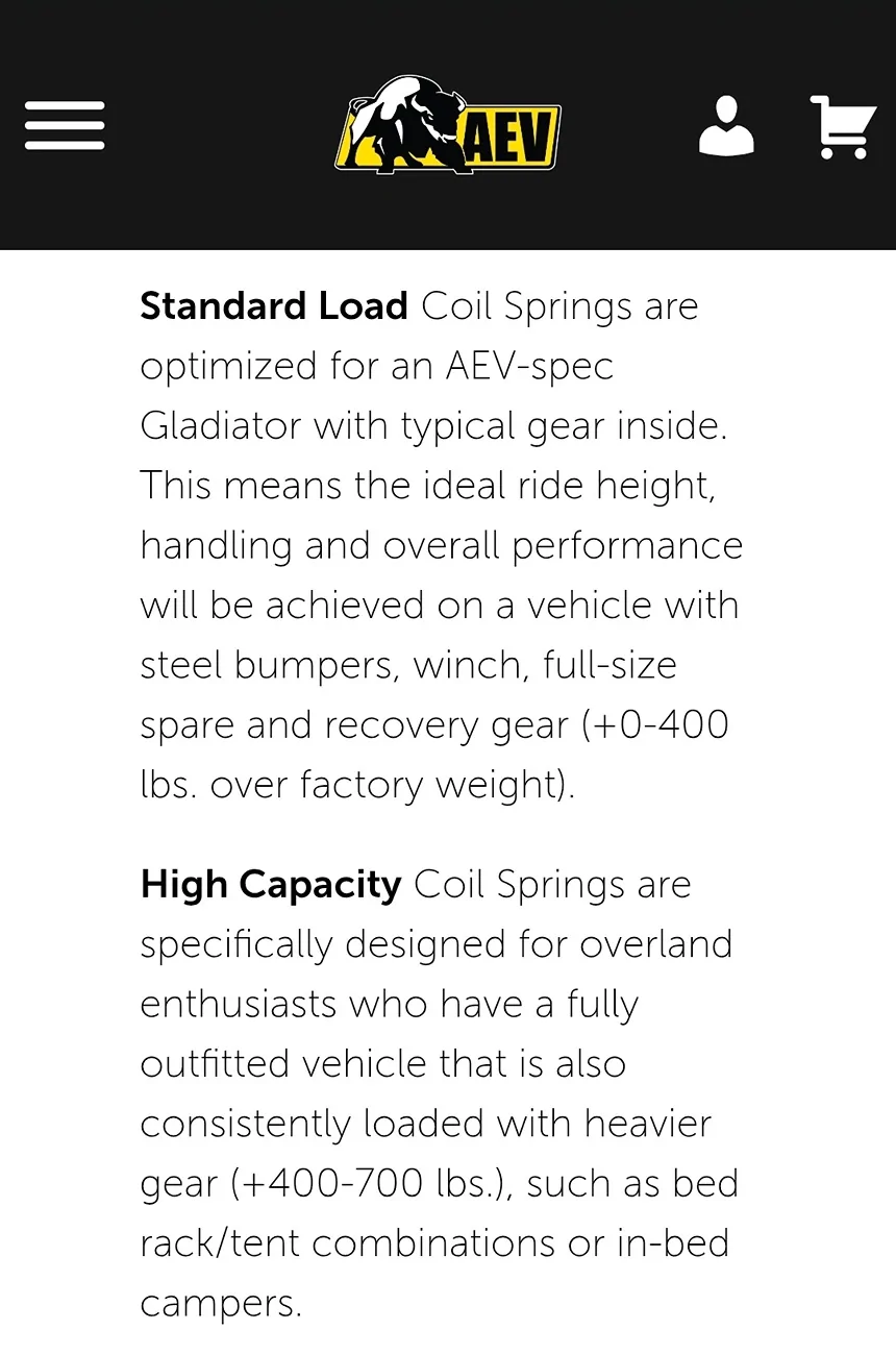

It’s really not reading into much. Aev advertises that it will “increase payload by xxx pounds”
That's not the way I read it. I see it as they suggest one set of springs for up to 400 pounds of continuous cargo weight and the other set for 400 to 700 pounds of continuous cargo weight.
Jeep Gladiator Clayton Off Road JT Suspension Systems Screenshot_20250811_205622_Chrom

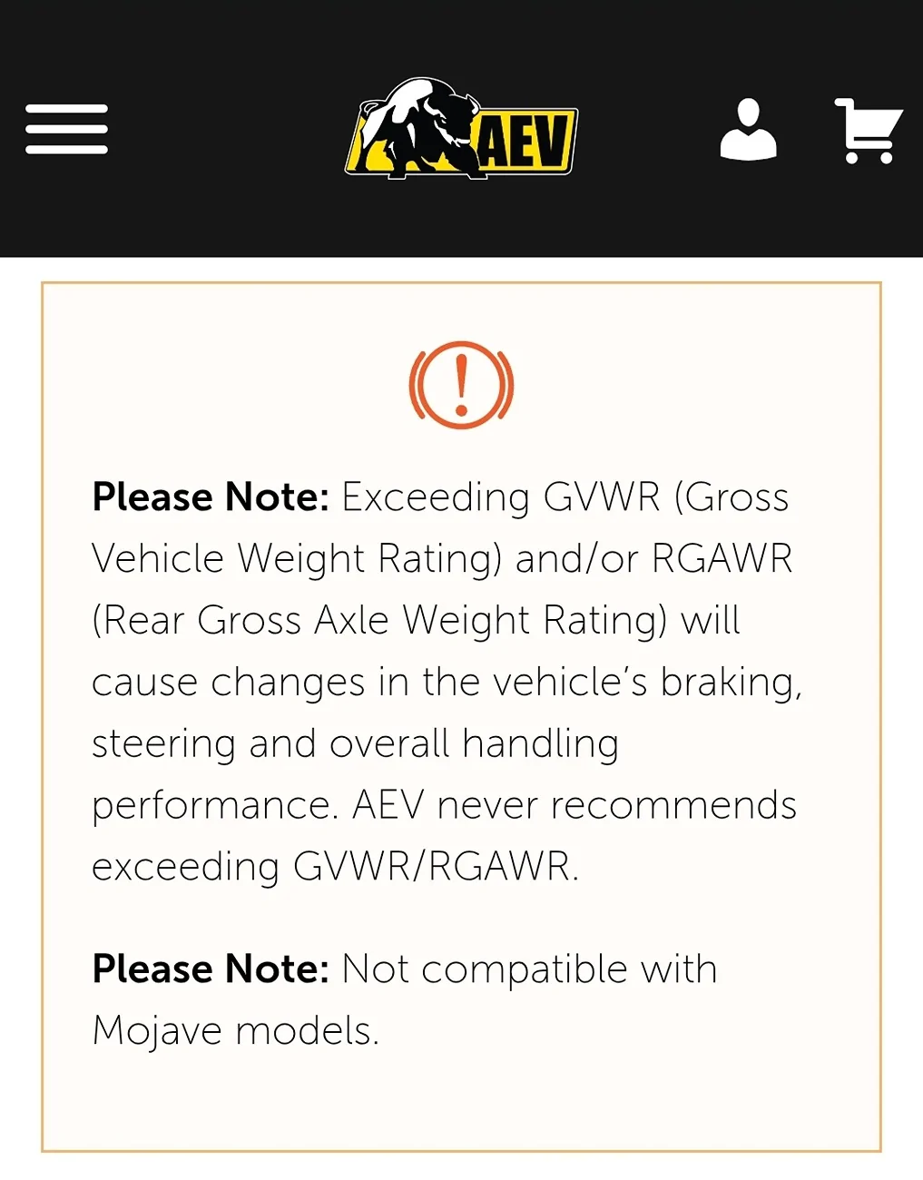

Plus this👇 is right below that☝...
Jeep Gladiator Clayton Off Road JT Suspension Systems Screenshot_20250811_205353_Chrom
I don't believe any spring manufacture would state their spring add payload above and beyond the vehicles stated ratings.
You’re right. I know I read it somewhere, just not sure where. Maybe it wasn’t AEV.
40,498
54,011
Right - it does NOT add to payload! It's like when I resprung mine for the snow plow and for the added weight of the power steps and steel bumper and winch. I did NOT increase the payload ability, in fact, I took away from the weight I could add to the truck on a trip. But I made it handle a now heavier truck better. Stock springs are for factory curb weight. Add to that - winch, bumpers, steps/rails - you have to rethink the springs.
You proved my point - they can't change the payload capability - only how it handles permanent added weight - it's now a heavier truck and frankly, even the factory would have used different springs!
