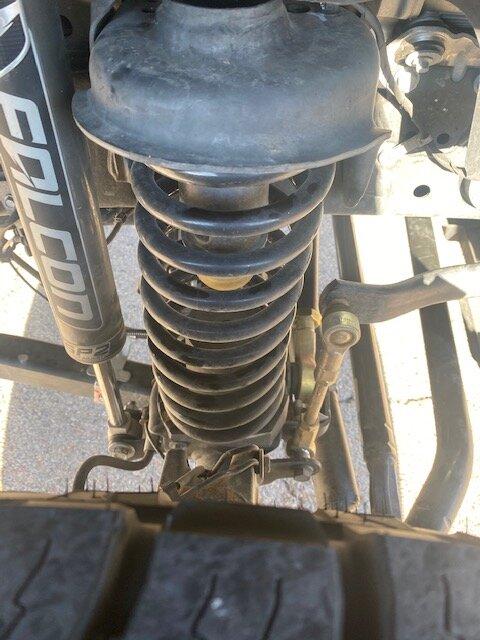

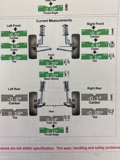

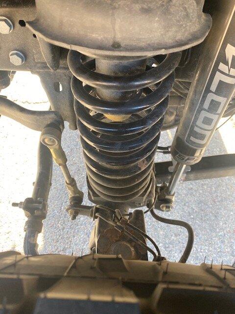

I will definitely call here in a little bit. I will attach some pictures of things that might help. I did torque everything on the ground I even bounced on the front end to try and set it, Ive really just been struggling to find the lingering culprit. Ive noticed one of my front springs looks bound up but i dont know if that would be the issue, Im also still using a stock tierod is that something that could help improve the feel.

that one spring looks funky. Not certain how that plays into your issue but it doesn’t look right. Should be straight like the other. I wonder if it’s seated correctly.
I have the same setup as you or close to it and ride fantastic.

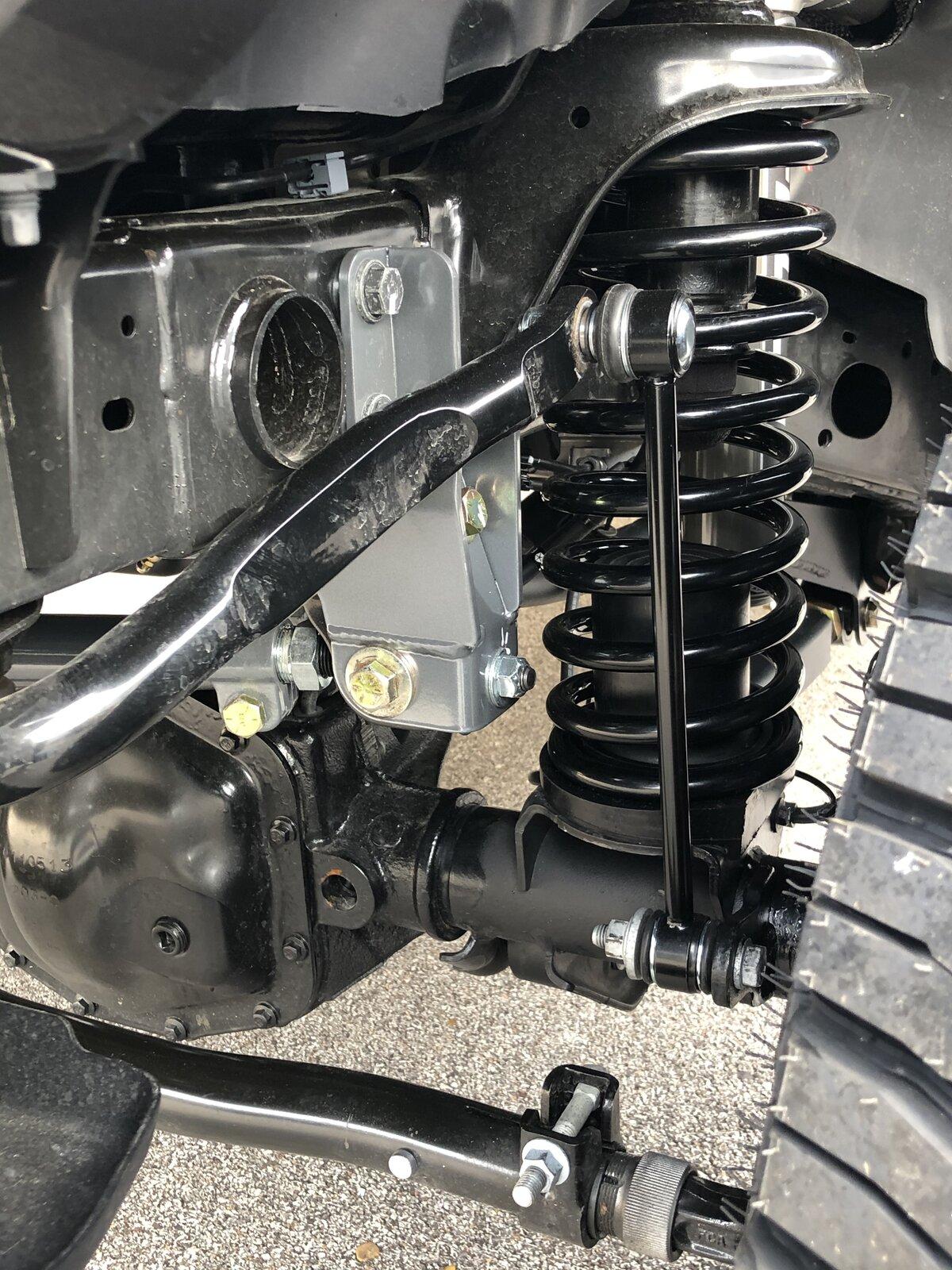

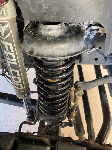

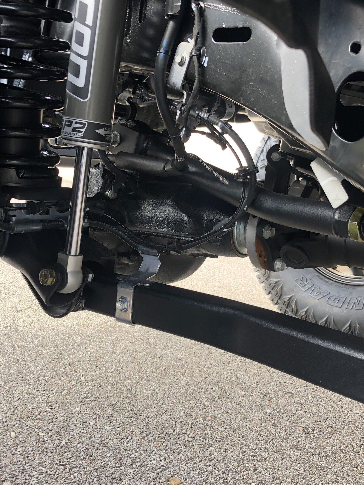

Update Fixed the spring issue yesterday one of the little rubber nipples didnt want to go in its home which was causing the bowing. :facepalm: When I took the swaybar endlink off I noticed there was a lot of pressure on that side almost as if that endlink was a little longer than the other side would this binding be enough to cause a vibration in my steering wheel or would it not make a difference at all.
That's great, those coils can be tricky on the JT's, most of the time it not sitting correctly in the perch is what causes bowing issues on these vehicles. As far as the end link goes, I doubt it was causing too much of an issue as the end links are adjustable and it shouldn't have been too far off from the other side. If the suspension feels like it's bound up it's most likely stemming from an issue with the control arms being installed incorrectly.

So how does it ride now? The swaybar endlink looks short
Definitely rides alot better now Ive gone through and loosened the track bars and shocks and re torqued everything. still have the slightest amount of bumpsteer, But i think that is just because i need to adjust the length of the front track bar.
