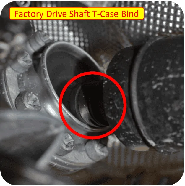

i was under the impression that pinion angle was more important than caster all things considered...
It is if you have a single u joint at the differential. Not as important with the Rzeppa joint (stock differential). But like why so serious posted… make sure there is no binding at full droop.
