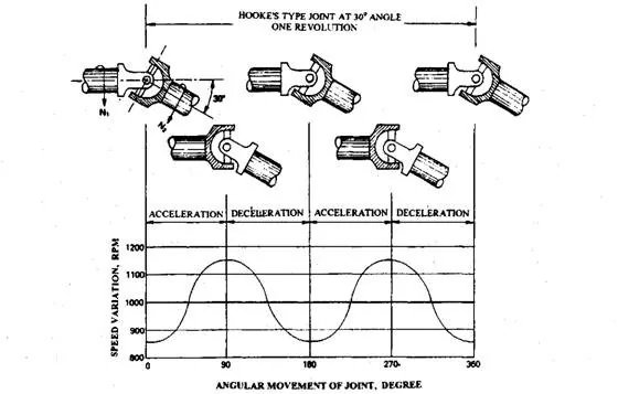

This is why if you have a single cardan u-joint you want to minimize the angle at which it operates, keep the pinion lined up with the shaft as much as possible -
Jeep Gladiator Rear pinion angle ujoint-image0023
And the above is why when you have a cardan joint at each end of a shaft, they need to be in phase and as close as possible to the same, but opposite, angles so the rotational speed differences cancel each other out.
It's not a concern on CV joints as there's no difference in rotational speed as the shaft turns.
But it's a huge thing on cross type, or cardan joints.

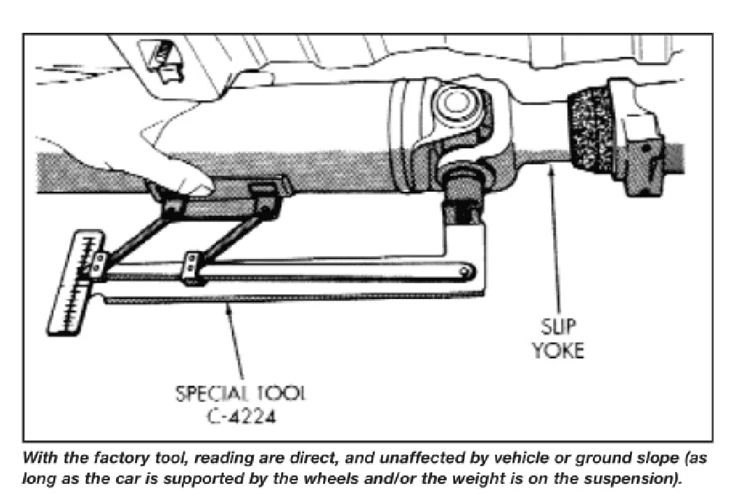

I've got magnetic electronic angle gauges, and from my time in the shop in the 1970s, I have the Miller tool we used back then, and this scan of the instructions -
Jeep Gladiator Rear pinion angle 1686494607879
Pinion angle is important more as it relates to its relationship with the driveshaft - and that can be more or less critical based on the types of joints being used.
If that rear joint is a cross or cardan type and the only one on that shaft, that angle is very important.
