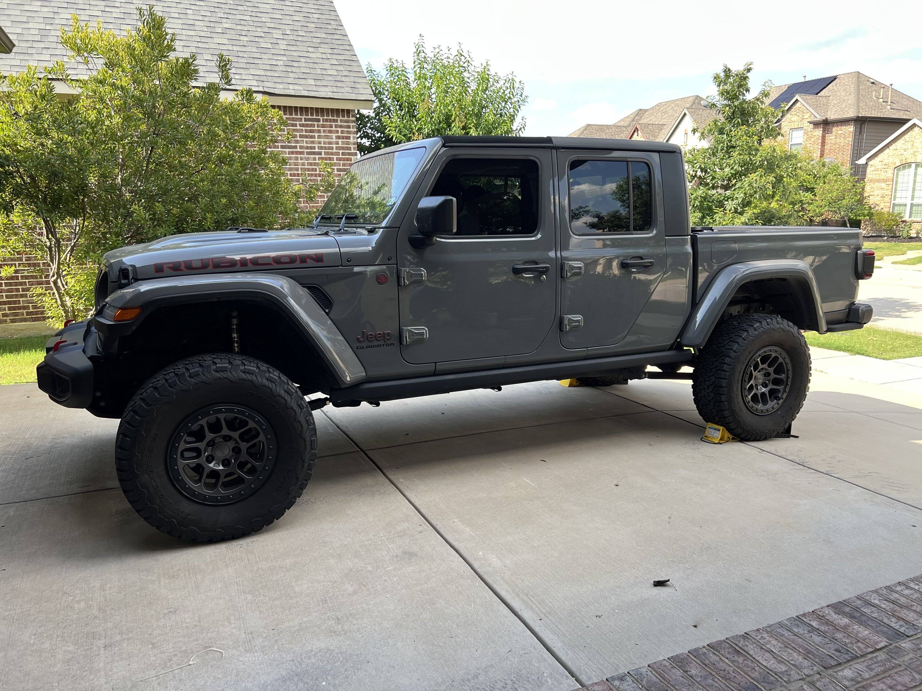

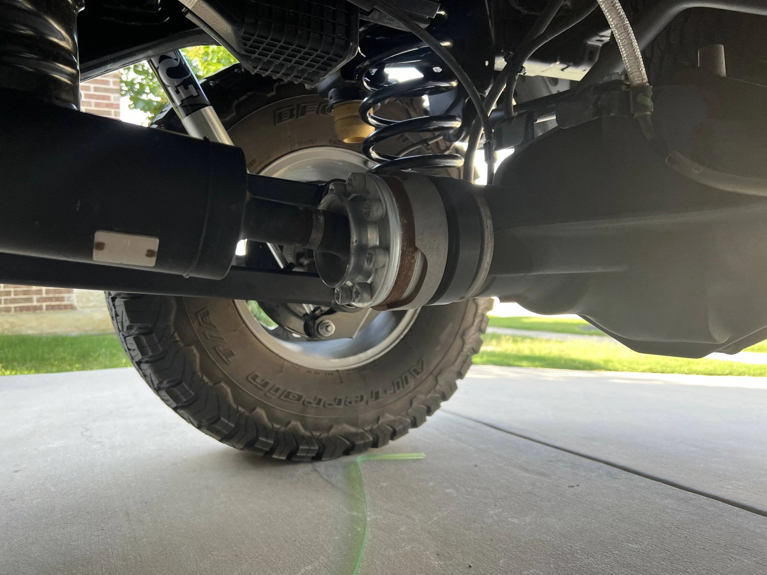

Lift installed. Didn’t help driveshaft angle as stated. Will use tomorrow to do an eyeball alignment.
As far as the rear goes you use the uppers to rotate the pinion and the lowers to center the axle in the fender right? Am I more concerned with the wheel in relation to the fender or the spring not bowing at all at ride hight? Or is this the same thing?
Thanks for all your help everyone!

Of the spring is currently straight, and you’re happy with the wheel in the wheel well, do both together, equal measurements. Shorten lowers, lengthen uppers. I’d start with 1/4ā€.

Funny story, after getting the lift all installed I pulled the wheel chocks and rolled the gladiator back a foot. Driveshaft to Pinion angle is perfect without touching anything. Torqued it all down

Measure rear flange on transfer case, this angle should match flange on rear diff. So if transfer case flange at 5 degrees rear diff should be 5 degrees or within 1/2 degree +-. Some minor offset or difference is okay. Looking at your original photo diff is low in front.
