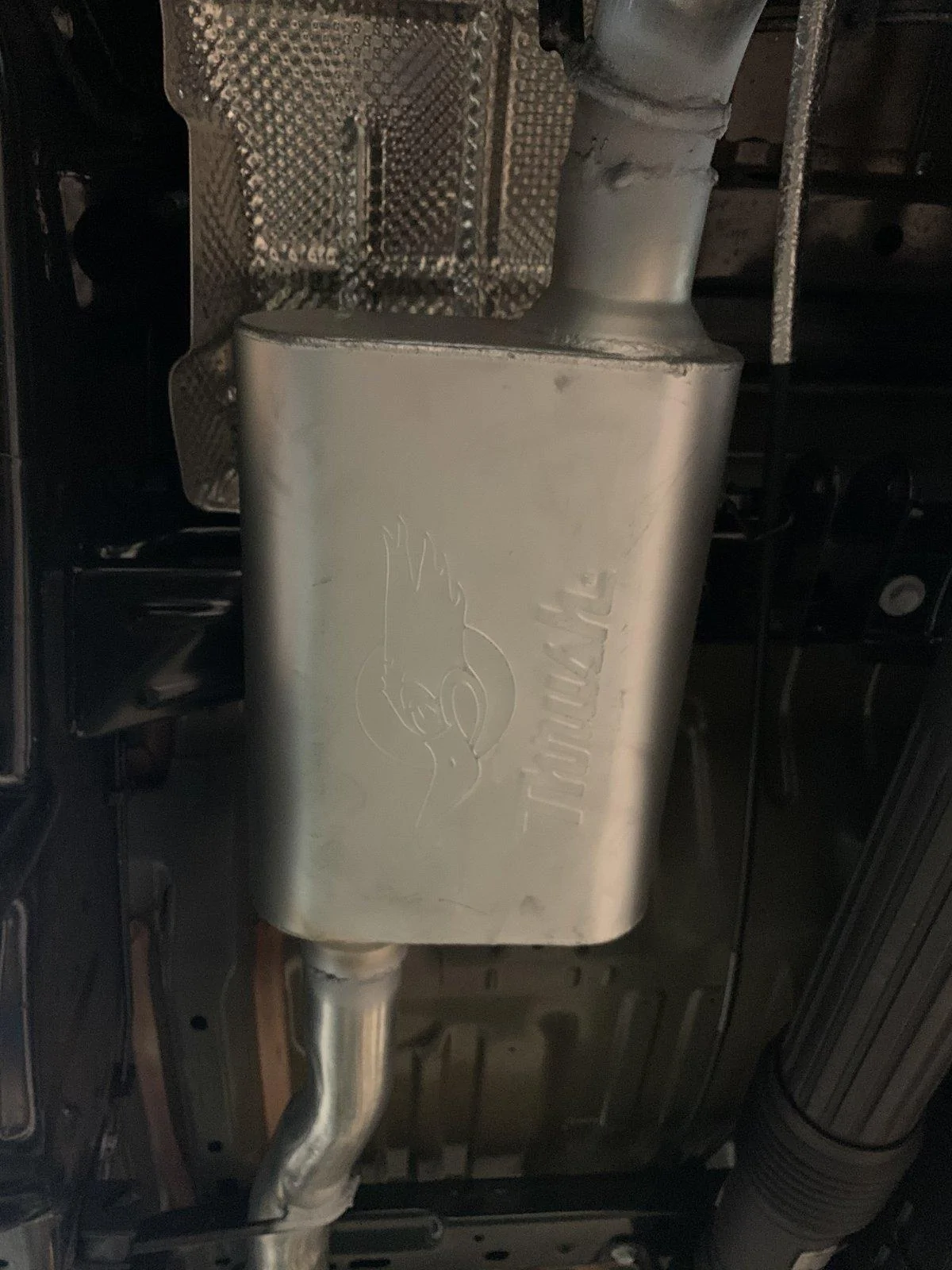

I decided to go with the Thrush Welded 17659. In their sound clip, I know it was a V8, but it seemed to hit the notes I was looking for... that I thought I would get the best tone/note out of the Gladiator... for what I wanted.
I thought it was only fitting to go with Thrush as they have been in the business for 53 years, a longevity and staple just like Jeep with an excellent history. It has the same inlet and outlet as the factory set up... and is a two chamber muffler. I was afraid if I chose a straight through muffler it would be too much for this application. I might have one of those built later, depending on how this turns out. I will try two options with the Welded... a few feet out after the muffler, and exiting at the rear axle.

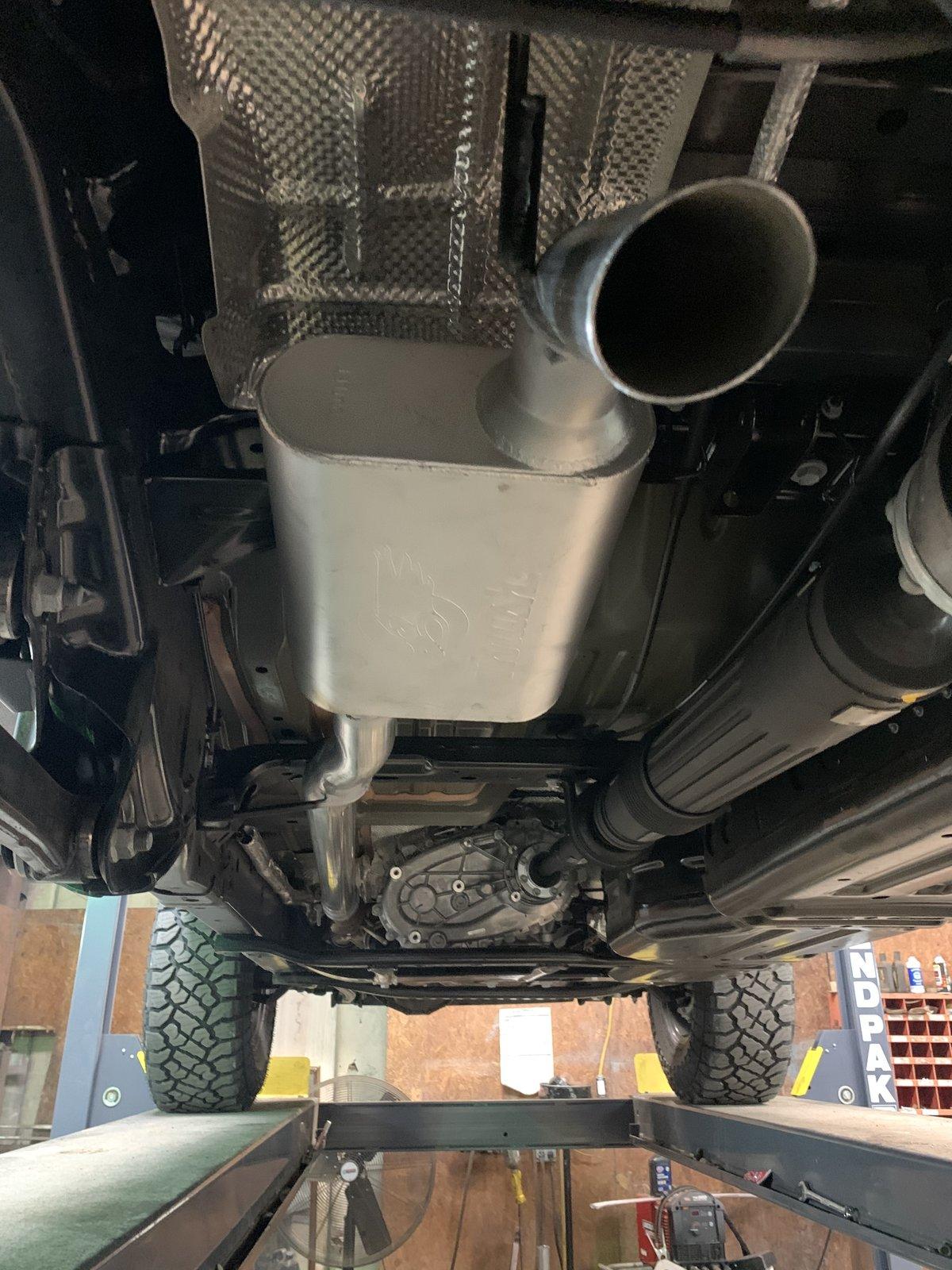

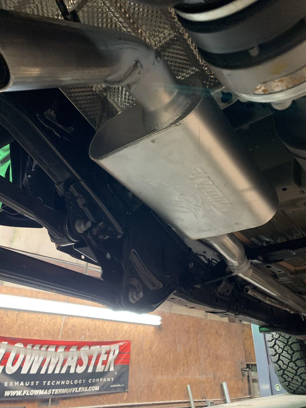

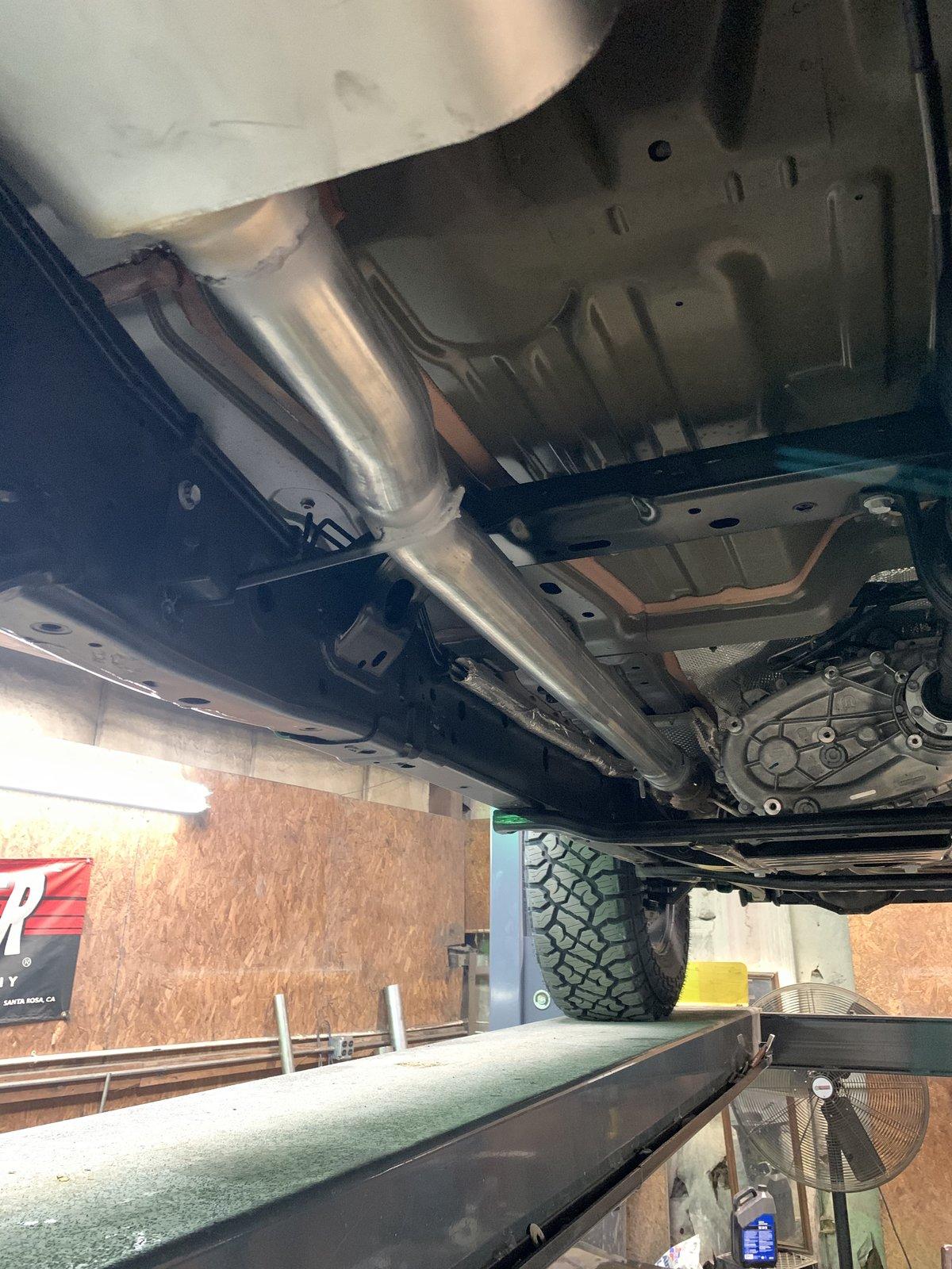

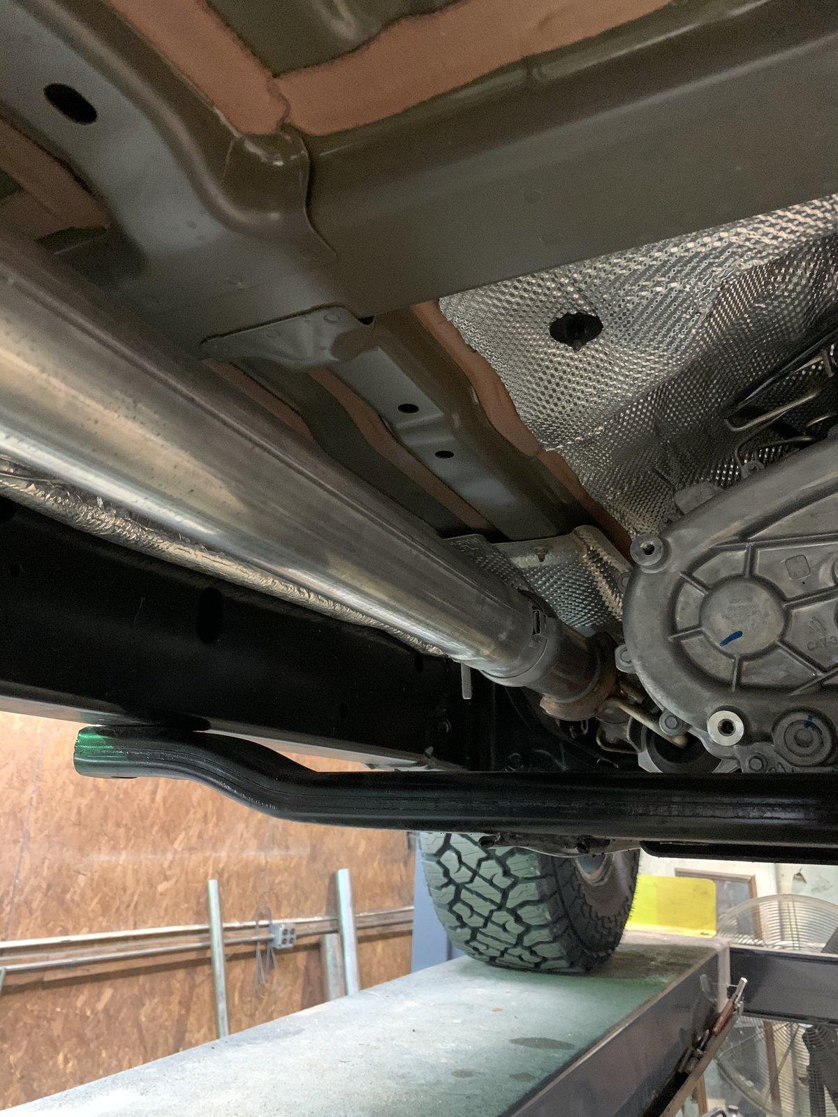

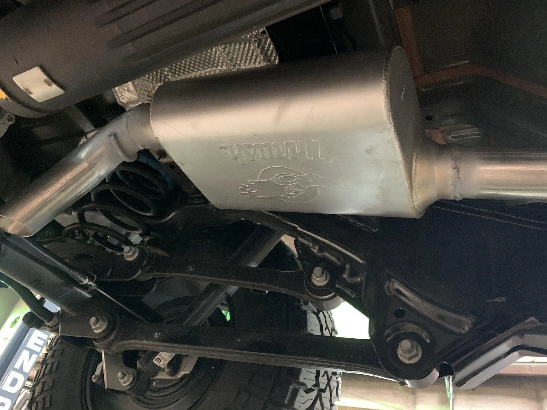

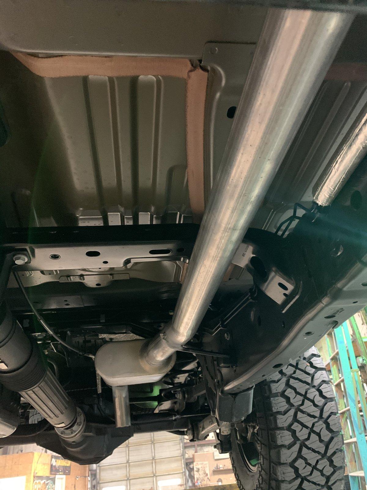

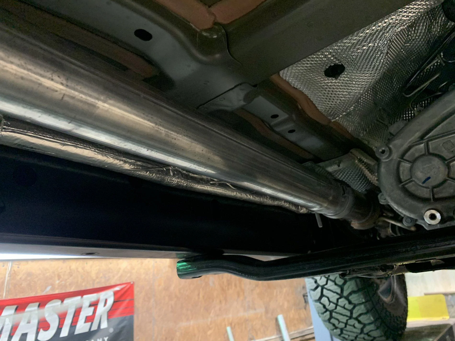

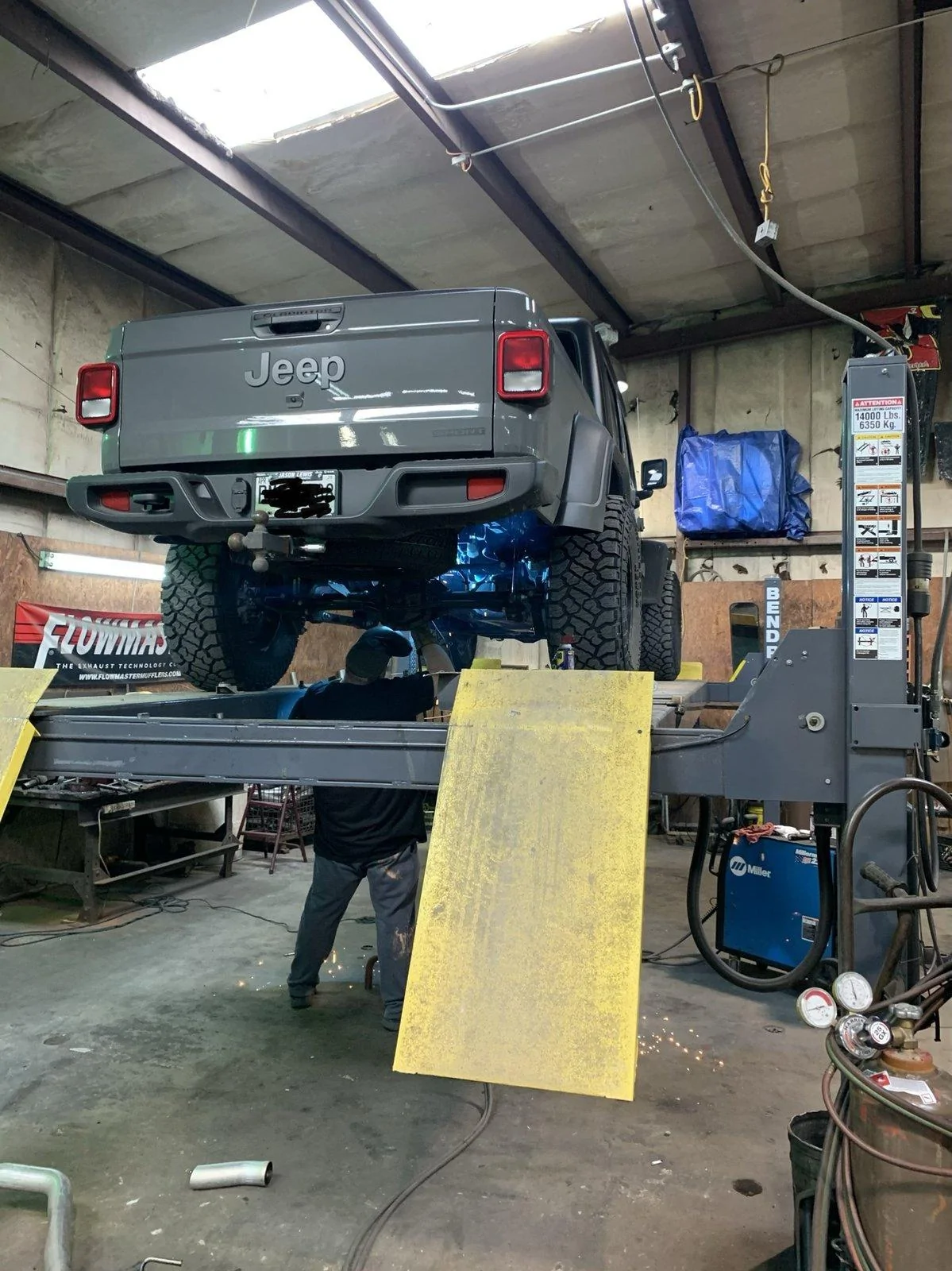

Several pics... really deep sound. Only slight drone in certain gears... at high speeds very mellow/calm. When you open it up it sounds great! Mean! Very aggressive but very mellow.

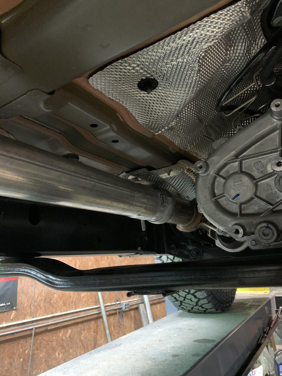

They told me it would be more beneficial to put the muffler where the stock one was... for heat shield purposes. I agreed. I dropped it right at the rear axle. .. it’s tucked up there nicely, and the pipe to the inlet is up nicely as well.

I've always liked thrush mifflers.
Some of your drone maybe from the dump vs an out the back exhaust. I had a dump on a Wrangler for awhile and it would echo off the ground. When I ran it to a behind the rear wheel angled out that drone drastically decreased.
