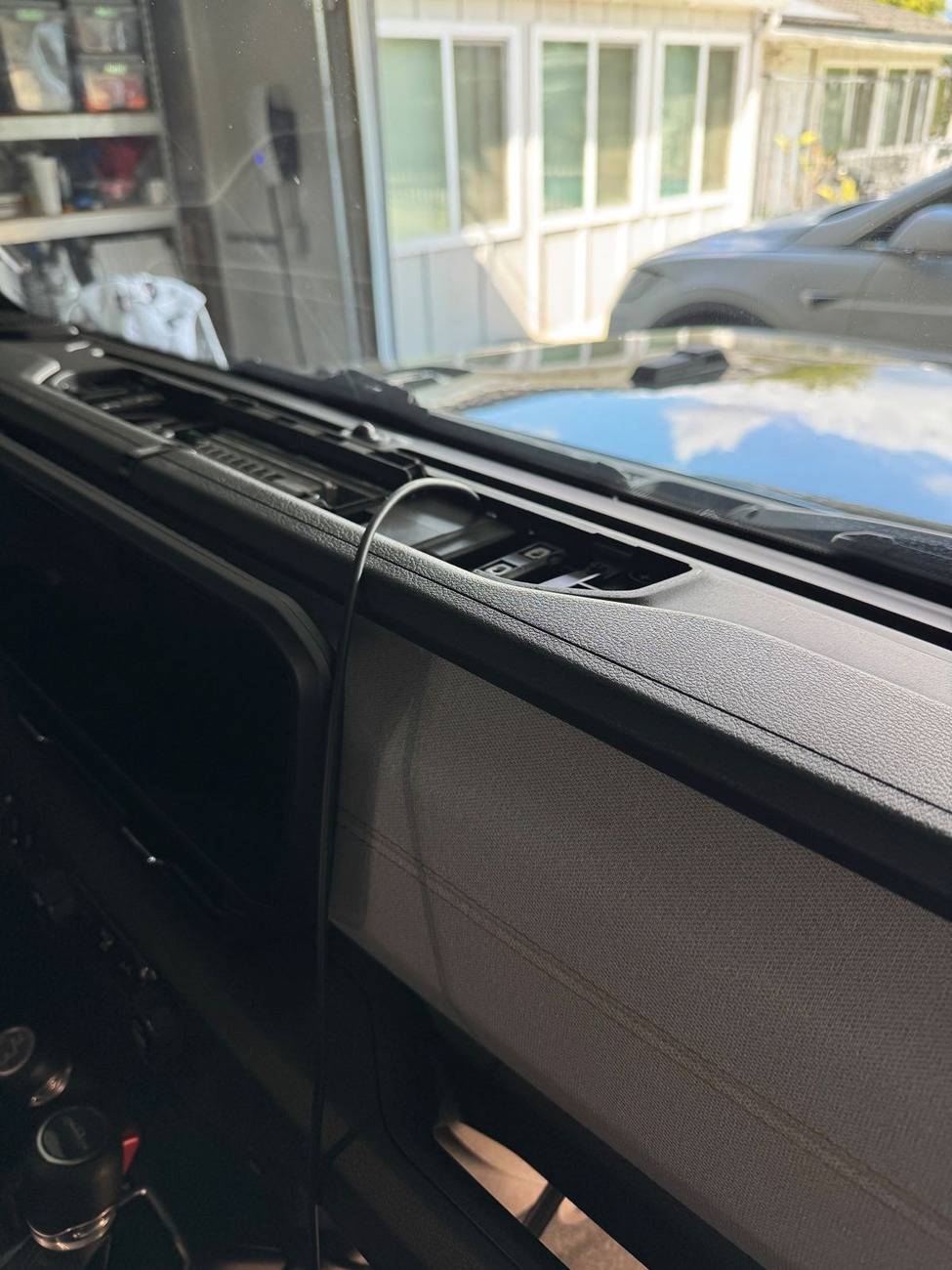

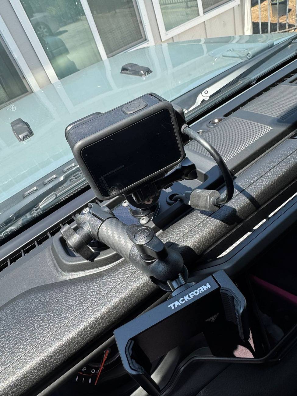

You can fish wire fairly easily from the top down to the 12V power source or the glove box area where the AUX cables are (if equipped).
There's a lot more space on the left side for hole placement and wire management than the right side. The picture below shows a USB wire pulled from the right side to the area below the glove box, but I ended up fishing a wire from the left side to the same area.
You can remove the screen to access the panel below that has the cigarette power module. They sell an adapter you can plug behind it to give you +/- leads without affecting the 12V source.
There's USB access to the media module on the right as well using adapters but I don't recommend it. It's primarily used for integration and doesn't have enough amperage to power or fast charge a lot of devices.

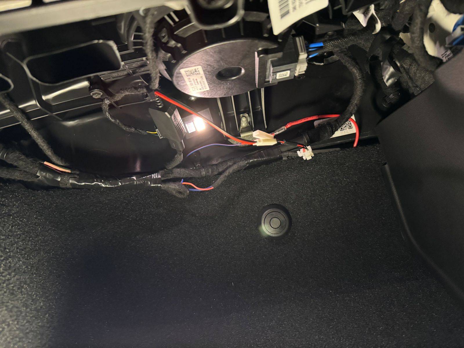

I believe the screen does not need to be removed. You can remove the panel below the screen to get to it but it's a pretty long horizontal piece with hidden screws. There are a few videos out that kind of show how -
The AUX group is a huge convenience. There's a constant 12V and ignition power source bundled together if you want direct access to the battery. There's a group of dedicated ground bolts near the right door connector, and another bolt that gave me good ground under the carpet near the middle.
AUX 1 and 2 have 40 amped relays and AUX 3 and 4 have 15 amped relays. You can find the wiring bundle behind the glove box to the left and taped up.
For AUX 3, I put a smaller fuse in and have 2 USB buck converters wired in with some 2 pin connectors I had on hand. (https://www.amazon.com/dp/B0D4HHSP7Z?ref_=ppx_hzsearch_conn_dt_b_fed_asin_title_1). I used 5ft USB cable and had plenty to work with when I fished it through.
I put a Kicker Hideaway sub on AUX 4.
Found a picture I took with the glove box removed (taped aux wires to the left, buck converter/USB around middle)

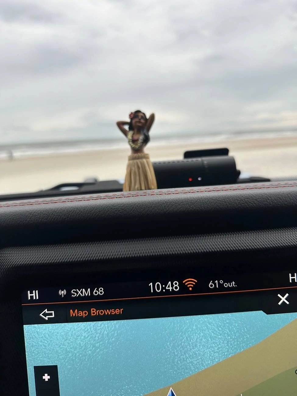

I really like that install, with the ACC I'm having a hard time finding one that doesn't block the windshield view. Which model do you have? Any chance of a pic of what the camera sees in that location?
MikeSalt
Jun 11, 2023
136
291
St. Augustine Beach
2023 Mojave
Paramedic/EHS Director
I have the 590.
