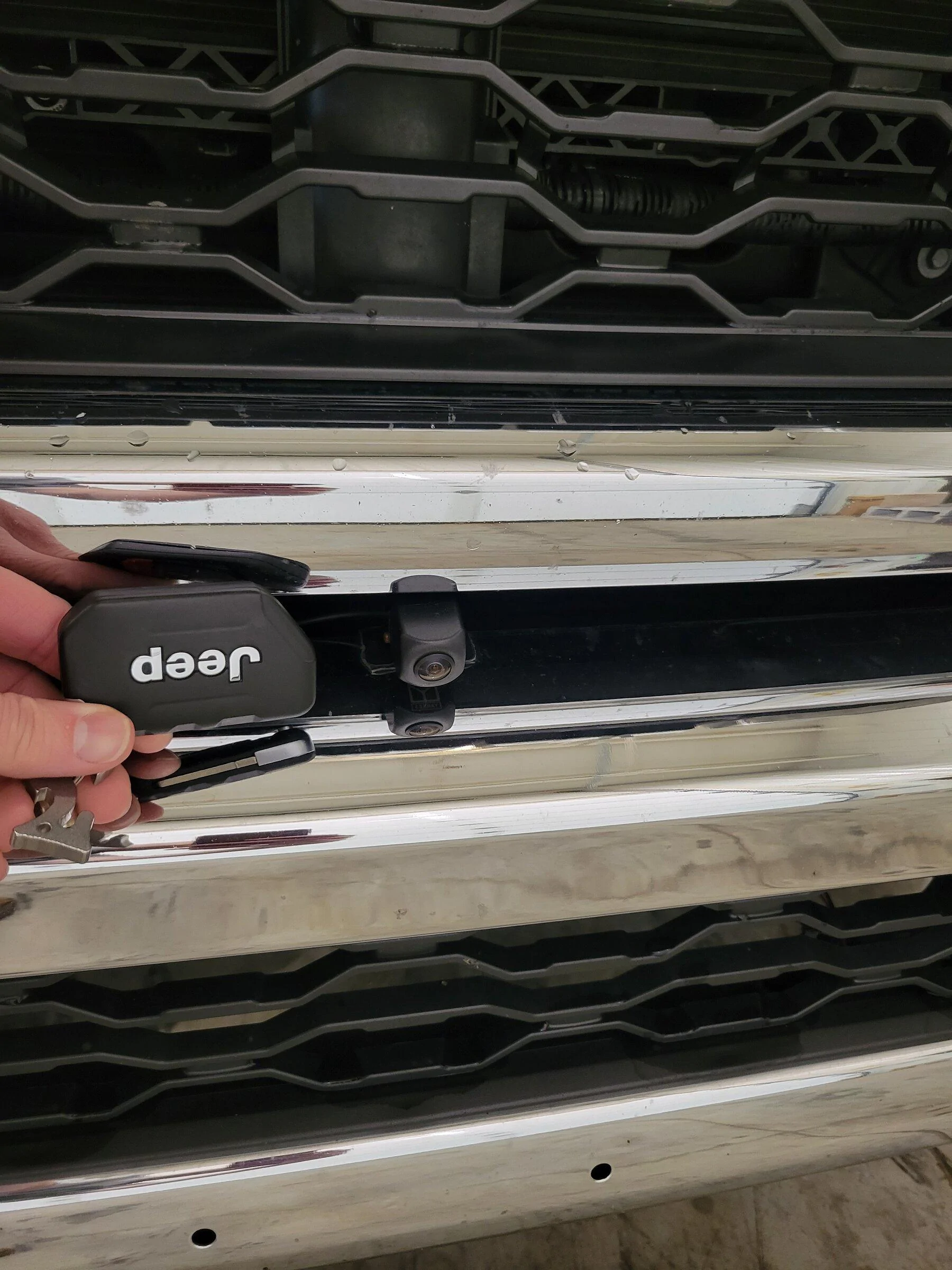

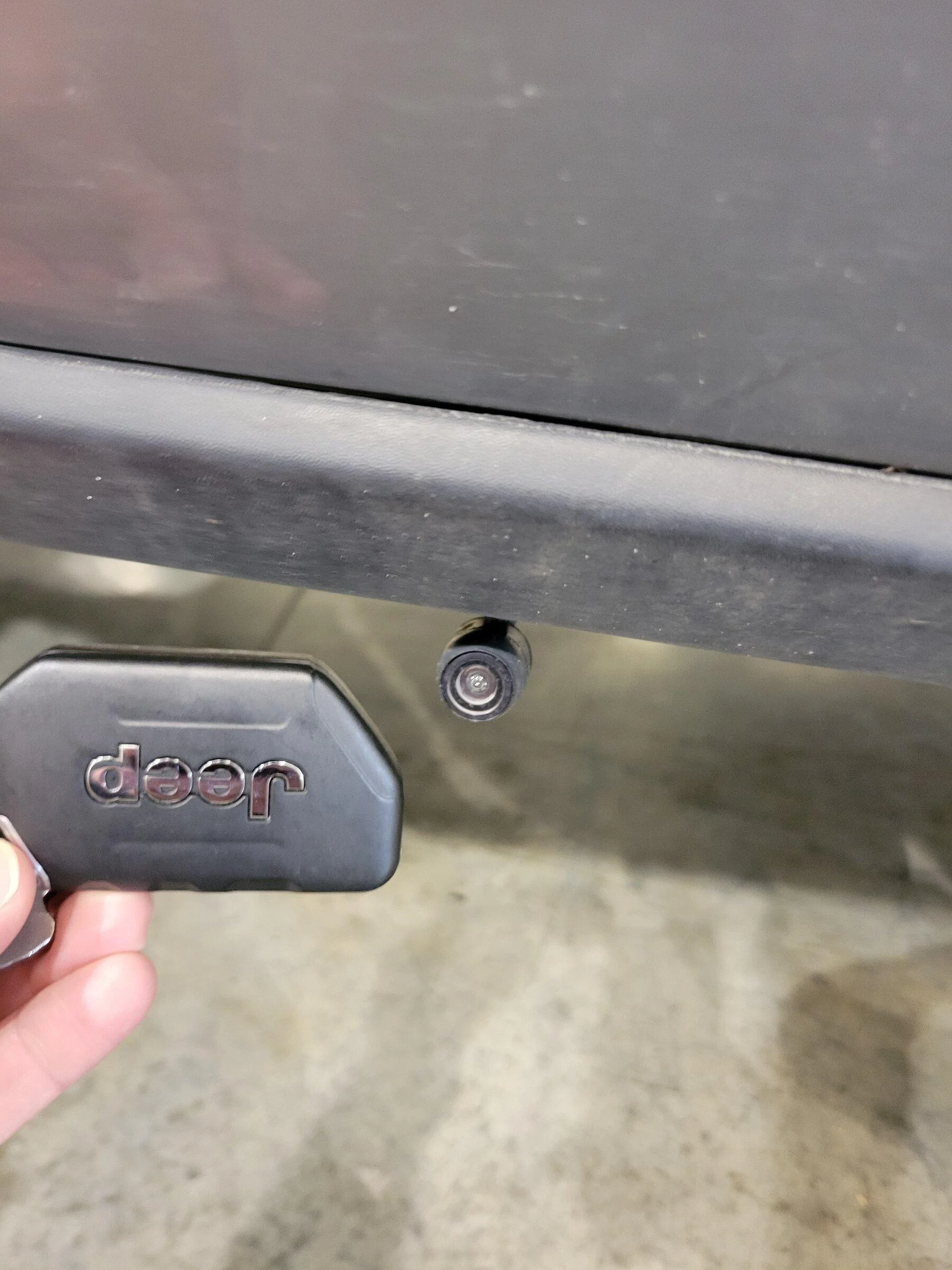

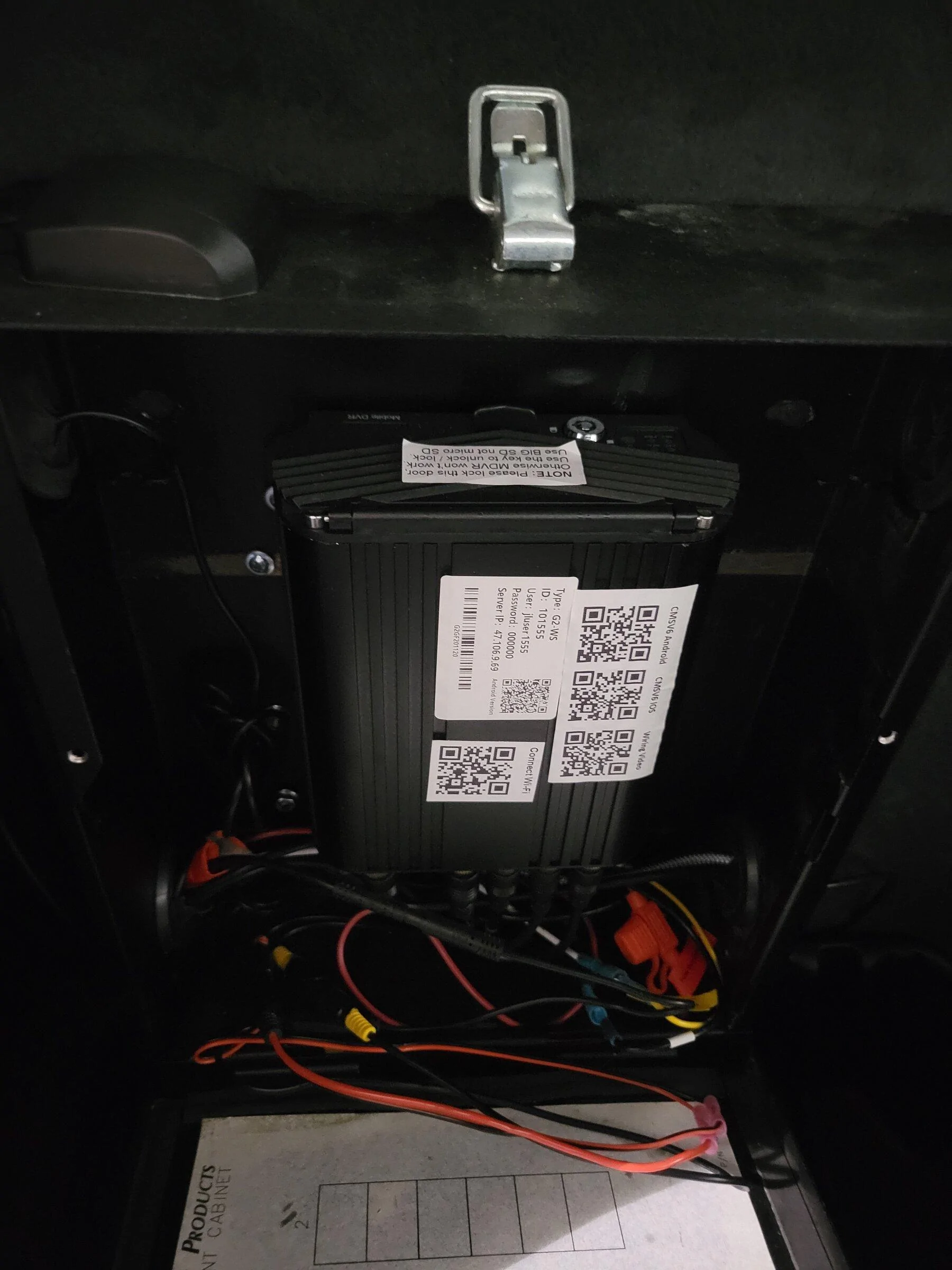

This is a simplified post because I only have 2 minutes, but I did this in some commercial trucks last year. Get an automotive DVR, monitor, and 4 cameras. You get full 360 degree viewing and you can mount the cameras so you can see the ground as well as what is in front of you. The cameras in the "build your own" option are small, roughly as big around as a nickel. The system has been through snow, ice, 100+ heat, etc and working like a champ. Works great to have video proof if you are in an accident and it can be configured to record on motion if the vehicle is off (theft).

I am putting one in my Gladiator in about a month, have a couple of other upgrades ahead of it. I am going to mount my DVR behind the rear seat. I have never had one get hot at all. I used them in security vehicles where they had to be mounted in a fully enclosed locking metal box. Pictures from one of the trucks attached with my FOB for size comparison.

Then you can mount your monitor or slide it under a seat when you don't need it. You can buy longer video cables so you can put the monitor wherever you want. Hope that helps!
