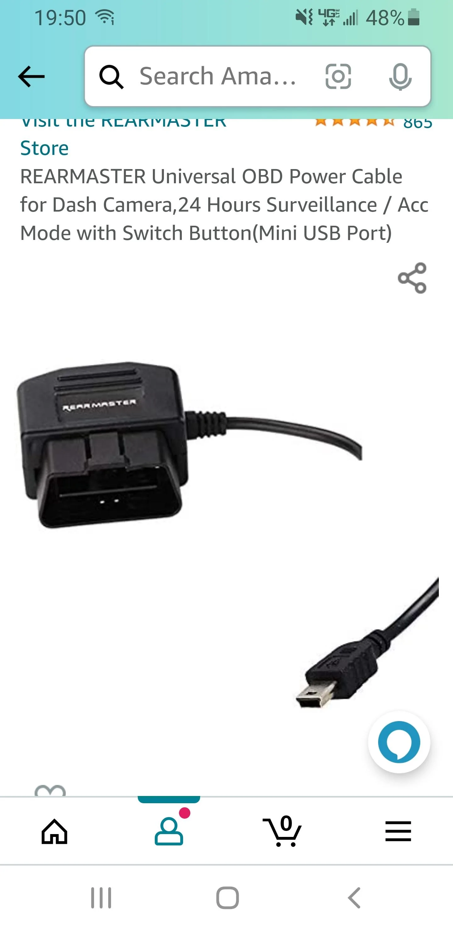

I use the obd2 port. It has an alway on power source and an ignition power source. I bought the cable off of Amazon.
Do you have a link for that part? I like this option.

They make a micro usb, one like the picture and type c. Basically what ever you camera requires. I have one in my truck that hardly sees any use. So I turn the alway on switch off So I don't kill the battery. On the JT, it stays on unless I know it will be parked for a while.
