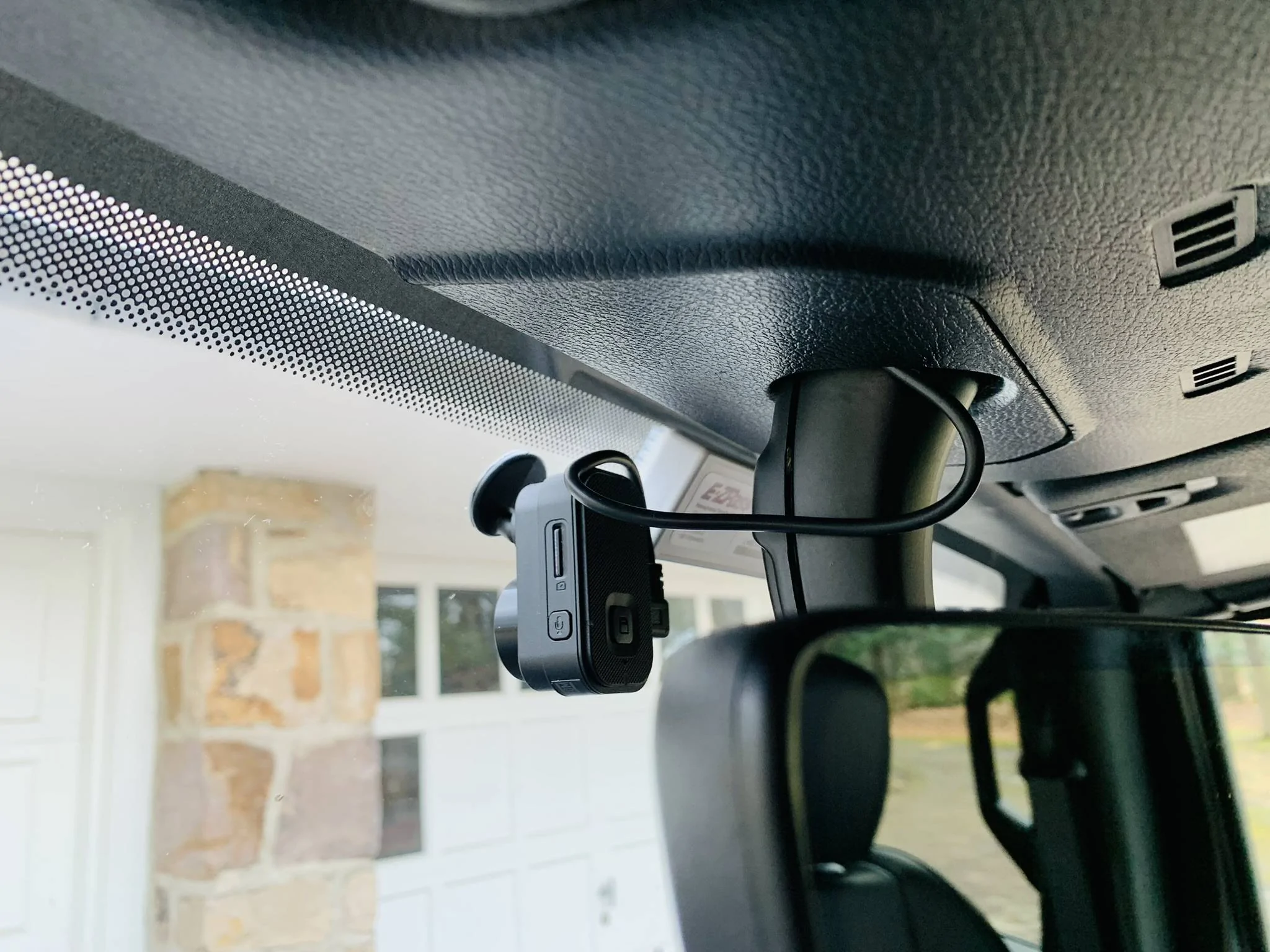

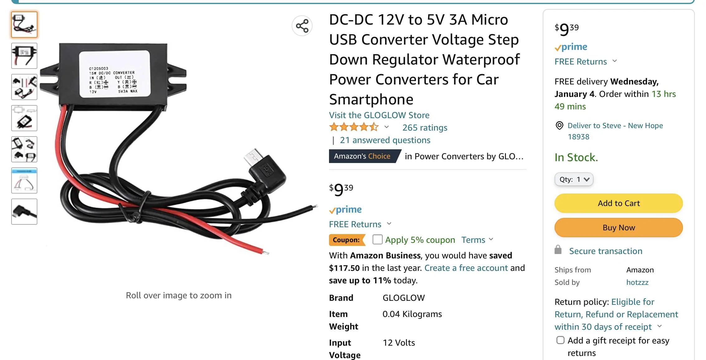

Hate having to run wires behind trim & also take up valuable power outlet space, so picked up this 12v to USB converter, identified a power wire for the mirror that’s on the accessory circuit & tucked it up behind the trim above the mirror. Just a short length of USB wire that comes down to plug into my Garmin mini camera. Works perfectly & was much easier & cleaner than stuffing/routing a long wire behind trim to get to an available power port.
Can you post a picture of your set up? Thx
Sure, but I’d rather not pull down the trim to show the technical portion. The module is rather small & fit nicely up above the trim above the mirror. Used a meter to identify a wire I could draw power from. Overall a pretty simple install.
Awesome, thanks. I just wanted to see how the finished product looked. Looks pretty neat.

Garmin mini 2 is what I use. Power is routed down under the trim to behind glove box. There are six wires behind there that are used for your accessories. 4 are for the aux switches and 2 are keyed to the ignition. I used one of wires that are keyed from the ignition. I used that 12v to 5v step down mentioned above for power. I found out the hard way the dash cam doesn't like 12v power. Works great. It's small enough to hide behind mirror so it's not in your way.
