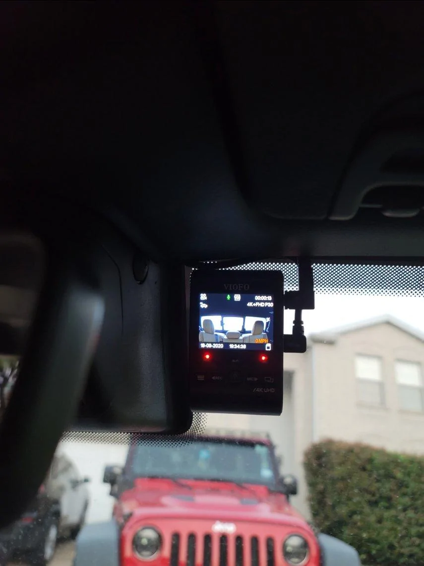

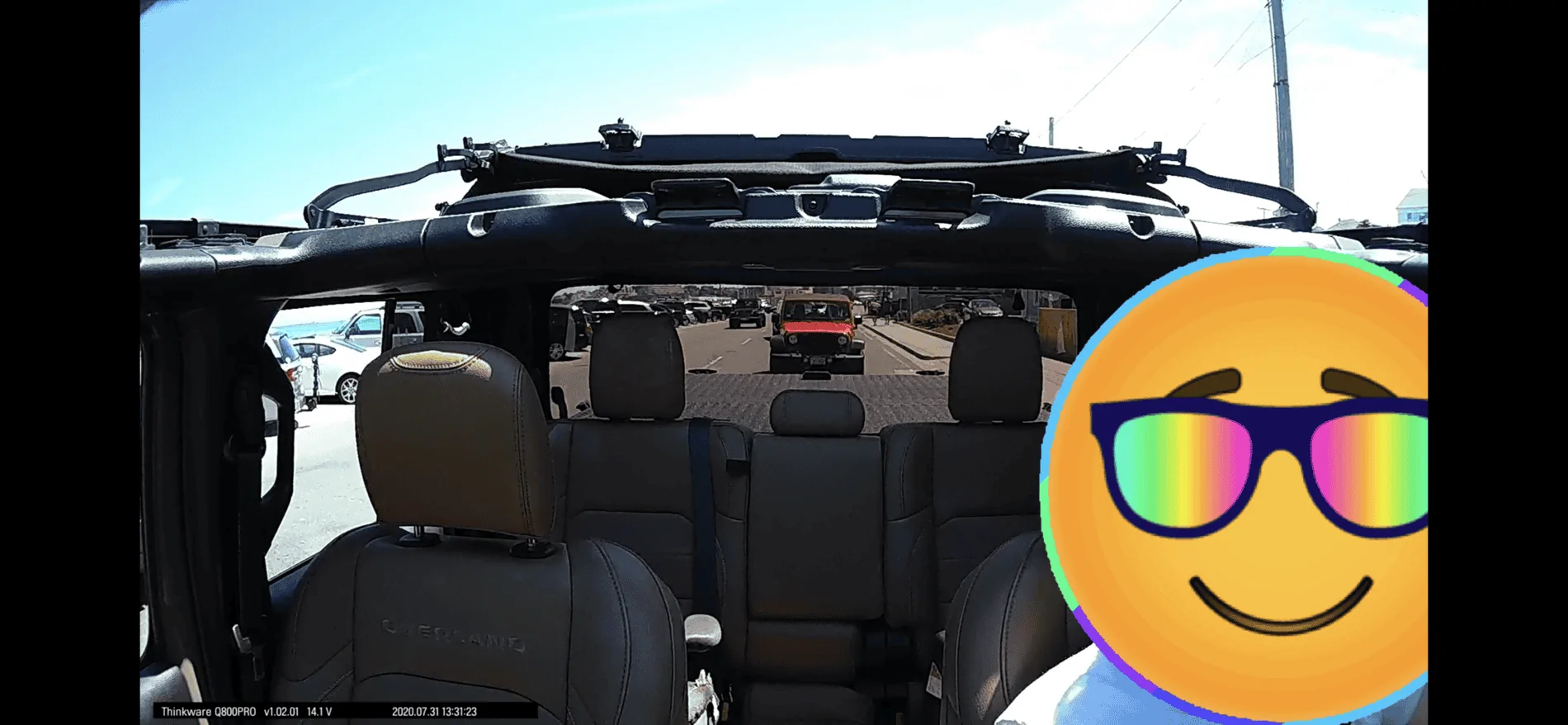

Can you post a picture of your rear cam view?
I'm trying to decide if I want the rear cam for looking inside the vehicle, or just outside.
Jeep Gladiator Anyone have pictures of rear dash cam mounting solution? 56345178-A274-4065-AC18-F368B7711AEC

I have seat covers on all my seats so I just shoved mine into the rear passenger headrest cover. It can see pretty well (it aims a little high) and doesn't really need adjusting. I don't have anyone sit in the back but if they do I just tell them to sit behind me. I put it on the passenger side because the window opens the other way. I also don't have to move it when I take the roof off either, nor is it intrusive in any way. I routed it through the plastic pieces on the roll bar.
