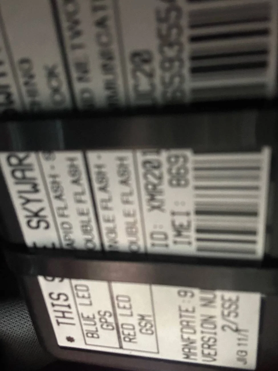

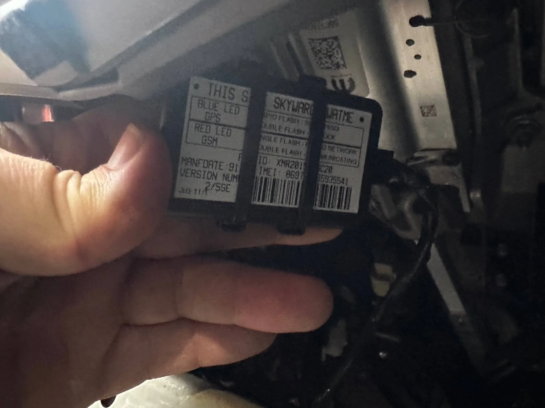

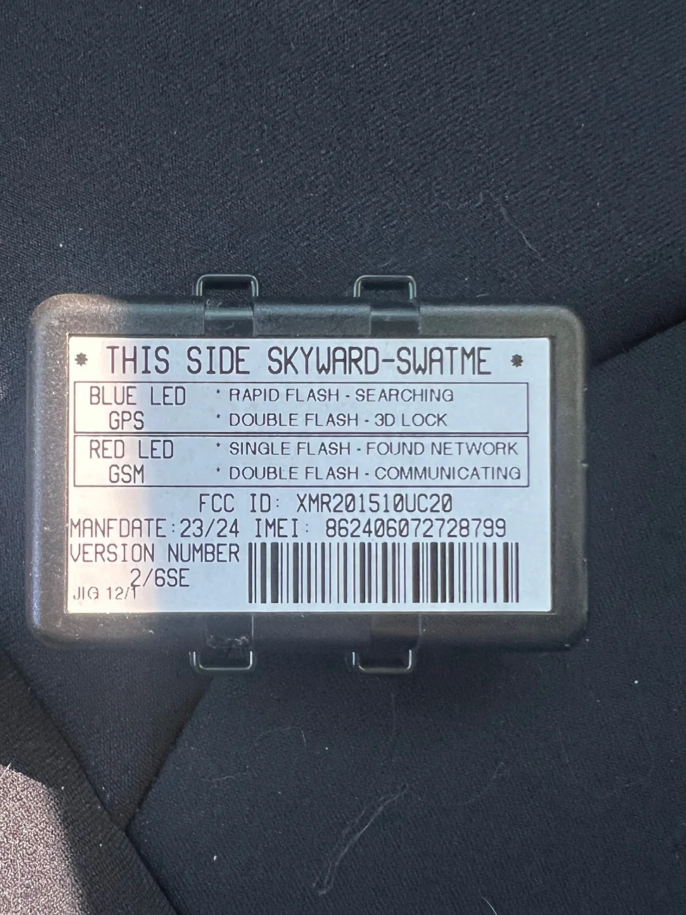

I found a similar item but when I unplug it my Gladiator wont start. Please check out my thread for the details. I need to find where the 20 pin connector goes. This damn thing won't let me turn off the horns when I lock/unlock my truck.

I bought it used from a dealership. I have no idea if they put it on or if the previous dealership did. I just want to remove it so the horn stops honking with the remote and it still starts.

Update - I called Karr and they are sending a tech on Tuesday to remove the unit. We'll see if this works. No charge.

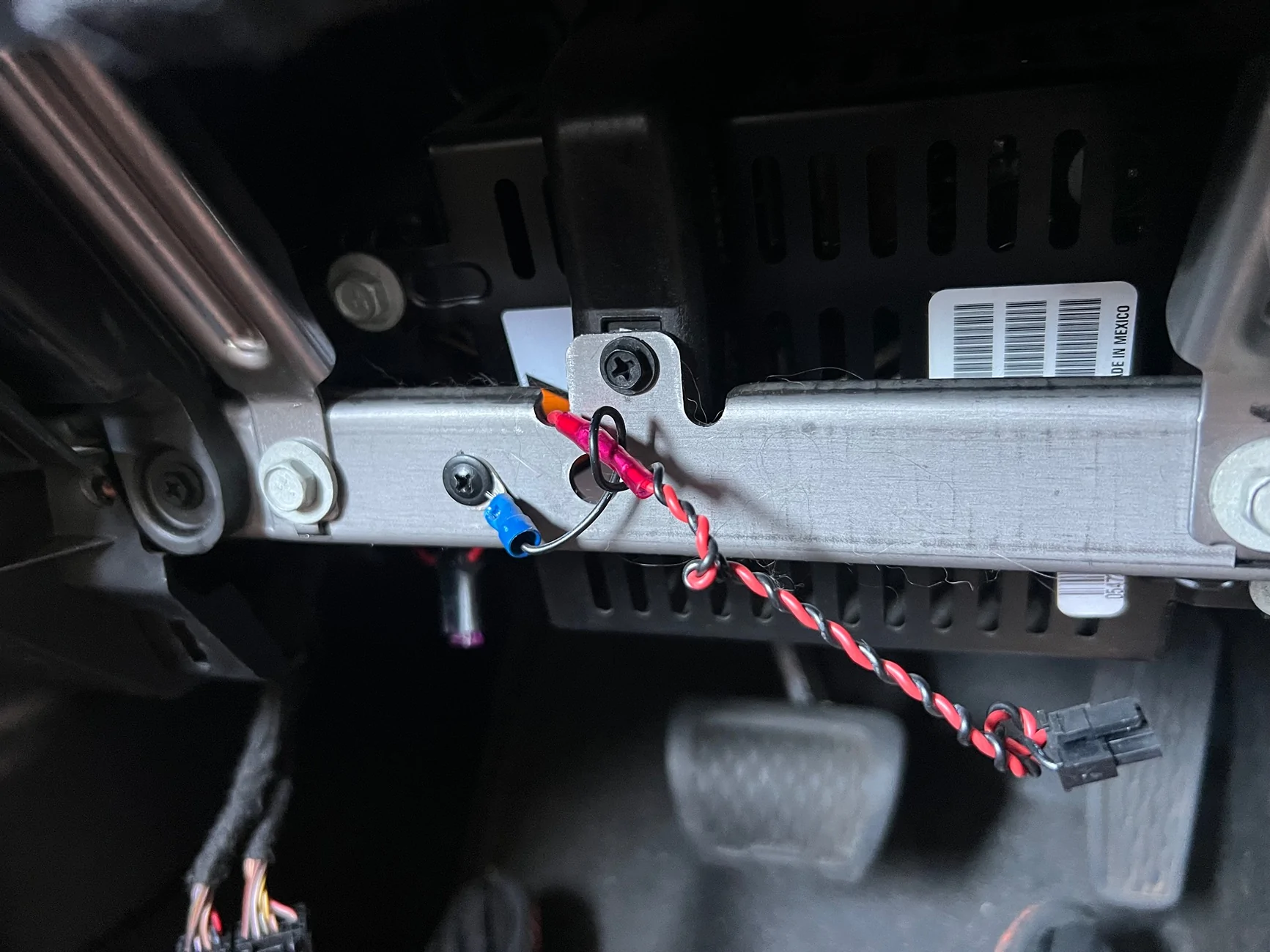

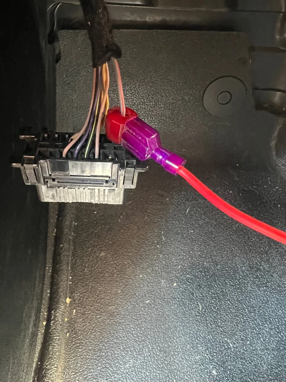

Update - it's fixed!!
Handful of wires from the GPS harness were T tapped into the stock harness. He unplugged those and reconnected the starter wire from the GPS harness to the stock harness. No more honking when locking/unlocking the doors!!!
