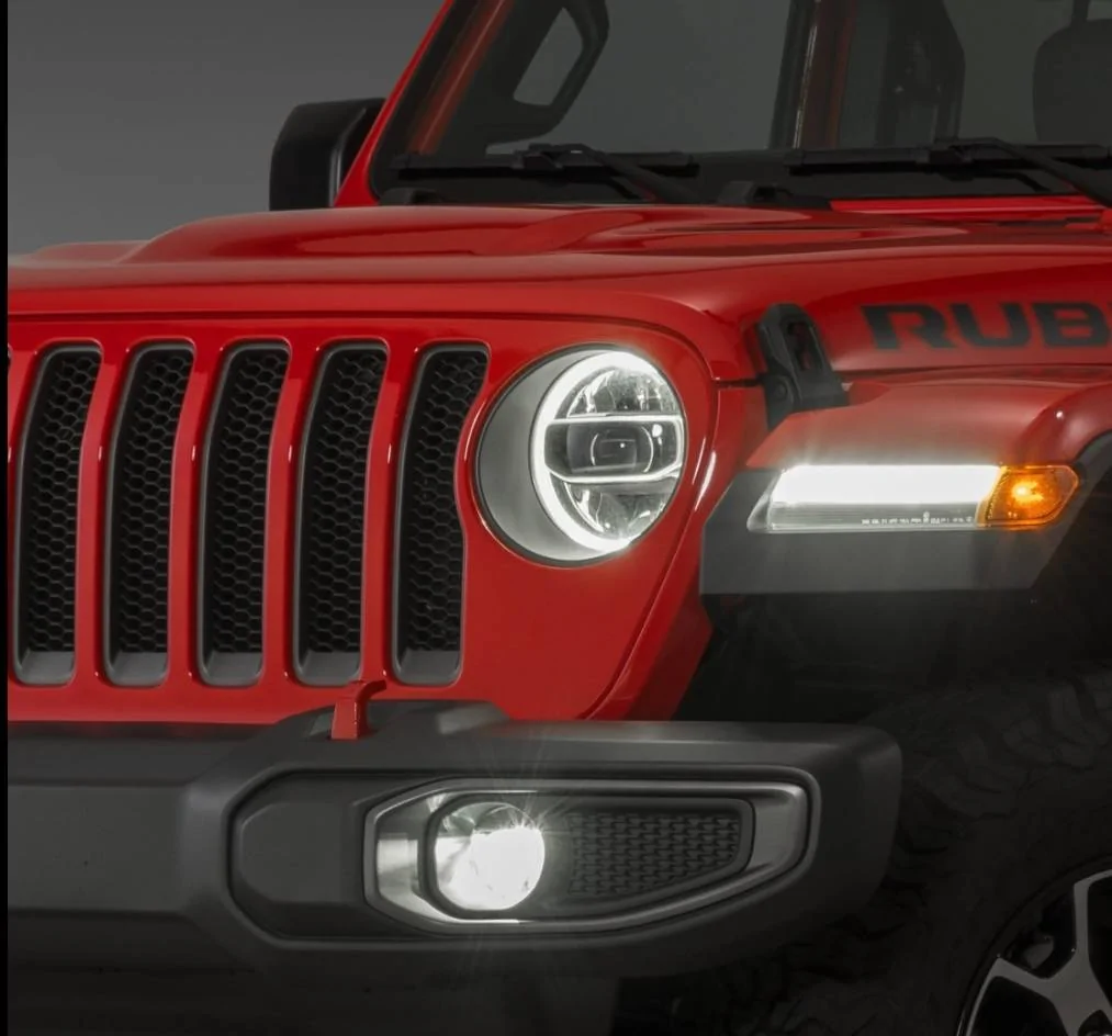

Sales code will turn on three Diagnostics settings which will cause hyperflash and turn signal out messages in the dash.

Again with the depin - it doesn't seem to be necessary for them to work fine. I just hated the codes and the thought of the fault sense from the DRL assembly being connected to the wrong pin on the BCM ( halogen side marker control ). I am probably the only person who has done it and no one else seems to have issues after enabling the LED DRL settings while leaving Diagnostics to OFF.
You can also just cut the wire and tape it off on the DRL harness side.

When you switched from Halogen to LED for the fogs, which codes did you change? I did a search on my Jscan and only found one code to change. I think it was LED fog present, if I recall correctly.
