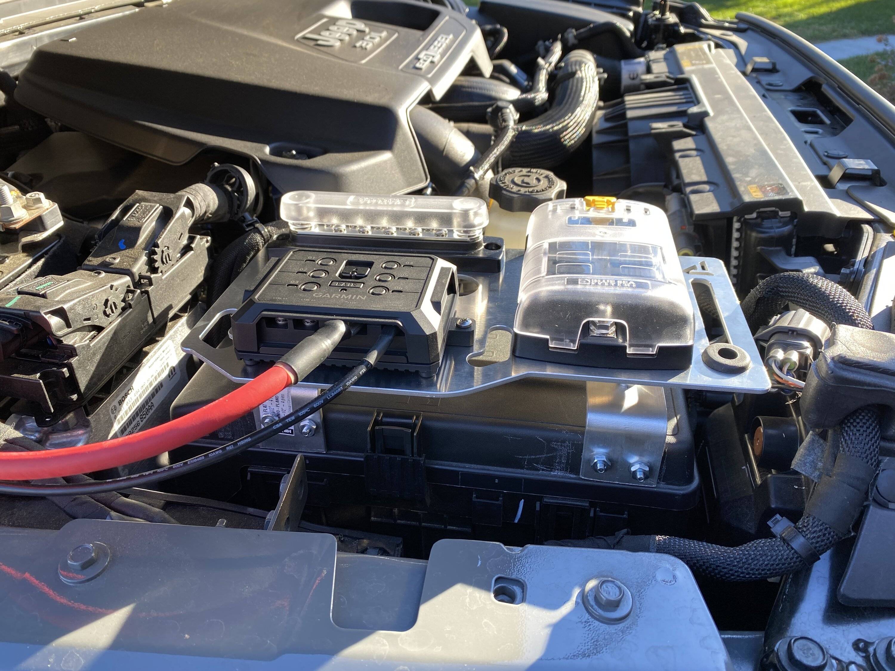

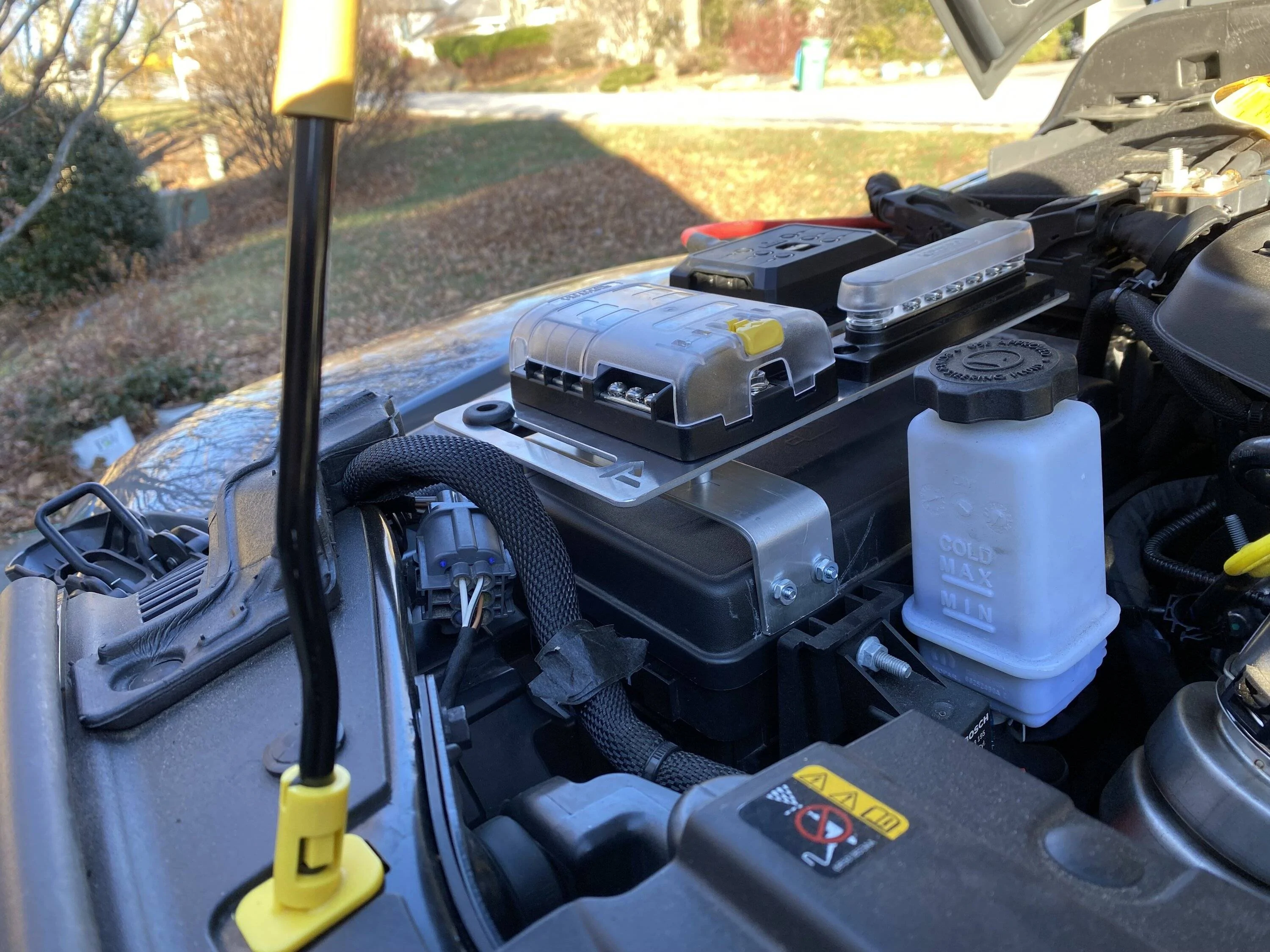

So I finally decided to go with a Garmin PowerSwitch to control everything when I get ready to install. I installed the PowerSwitch using a Powertray universal mount. In order to mount the tray I made a couple of brackets out of aluminum flat bar that I bolted to the fuse box lid. If anyone has any questions feel free to ask.

Looks clean. Once it’s all wired up, ho do you get to the fuses?

I can just pull the lid off. Worst case scenario I may have to disconnect some things.
