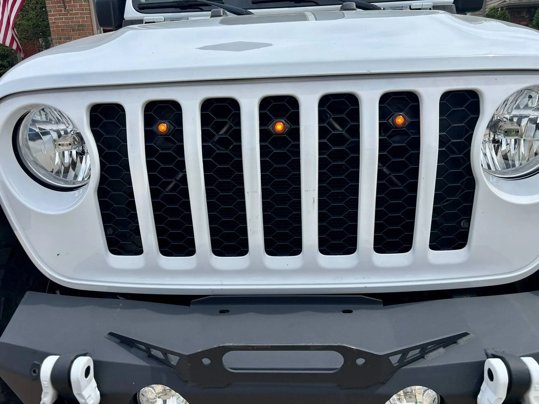

Noticed tonight that my drivers side DRL bulb doesn't work and neither does my quadratec pre-runner lights that plug into the drivers side fender light harness. Haven't had the chance to pull anything apart yet, but looking in my owners manual, I couldn't find any DRL fuses anywhere. I doubt its a fuse since the passenger side DRL works.
First thought is that it could be the "T" joint where the Q-tech grille lights plug in at the fender but then I would suspect that the blinkers and running lights wouldn't work, but they do.
I'm wondering if the DRL bub blew, would that also cause the grille lights not to work? I don't think so since power to the grille lights is upstream on the DRL bulb.

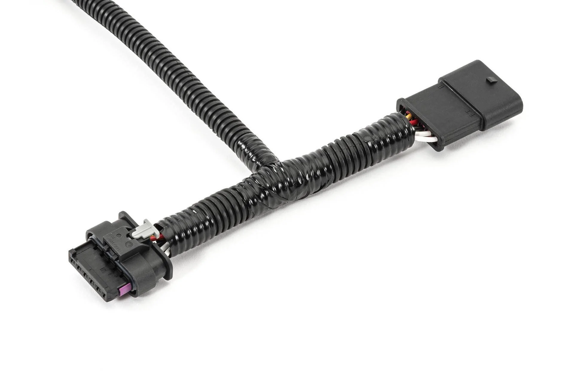

The Quadartech lights are plug and play with that 6 way connector on the drivers side. so no splicing no fusing ect.
pulled the T connection out today and all pins look good. The side marker and turn signal lights still work as function.

I honestly don't care about the DRL's but I want my grille pre-runner lights to work. So not sure why or what would cause them to not turn on when everything on the drivers side (blinkers, running lights etc) work but not the DRL bulb. Hoping its something stupid like a bad DRL bulb.

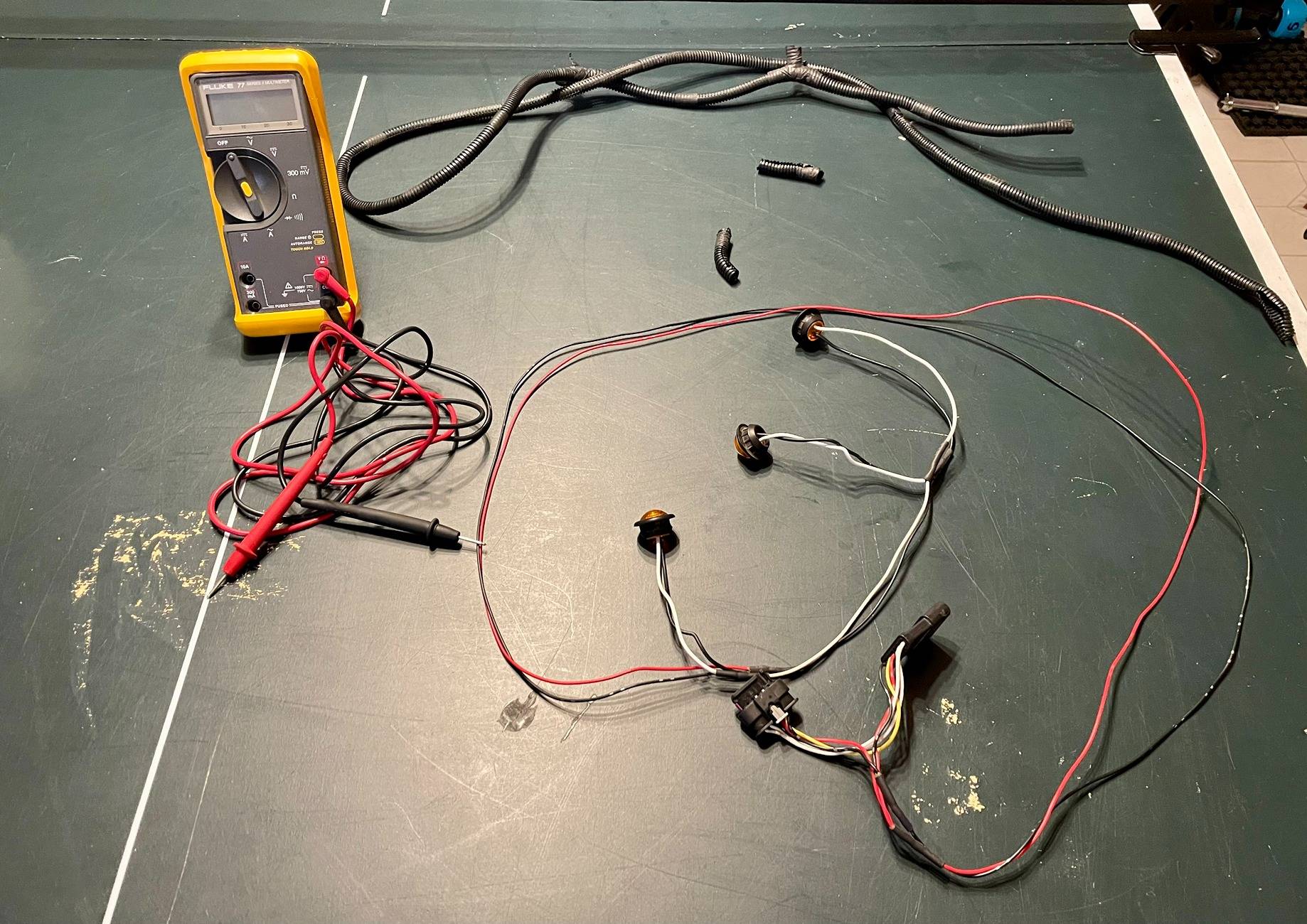

Update: Ended up replacing the DRL bulb with no luck. So the problem definitely lies in the Q tech harness someplace. Pulled the Q tech harness out and installed a new one today. Everything now works again.
However, when I did a pin to pin continuity check between the 2 connectors and all 3 LED bulbs back to the inline's in the harness, I found no short nor any open circuits. Everything has continuity from each bulb back to the inline connectors. So I have no idea on why this harness failed or was causing my drivers side DRL to quit working. I plugged and unplugged multiple times to make sure the connectors were fully seated and even the CPA's were engaged so I know it was tight.
The Q tech harness comes with a 3 year warranty but of course I was out of it by about 7 months. BALLZ.
Oh well, out $50 bucks but everything is working again as it should. Just bothers me that I can't track down the failure.
