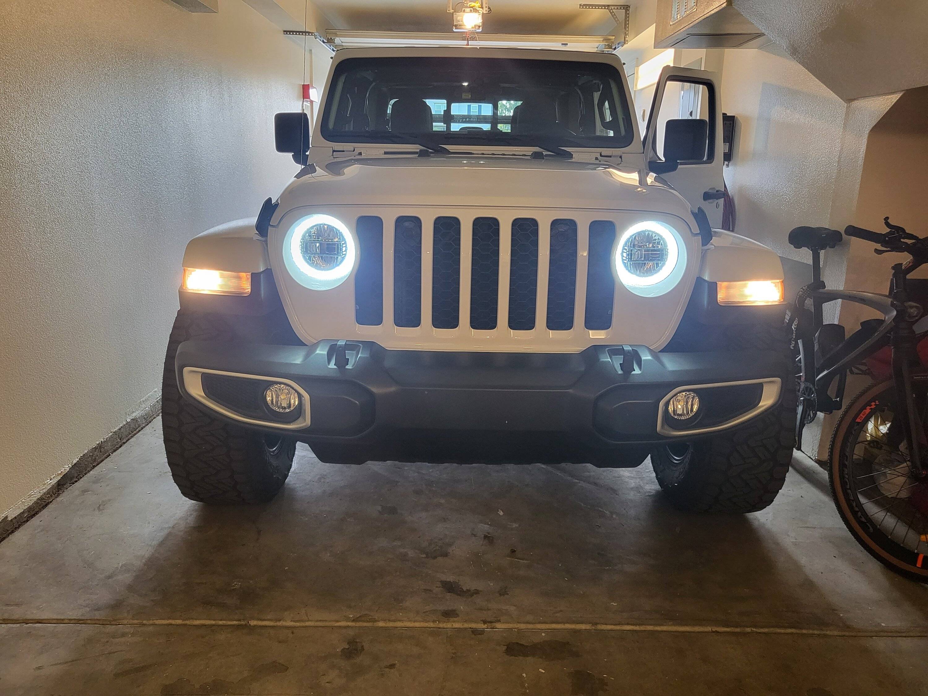

I just installed a new set of LED headlights. Bought TRUE MODS 9" Round LED Headlights from Amazon. The lights look amazing. Just one slight problem. I noticed that when the headlights come on, the driver side DRL is off and the passenger side is on.
Jeep Gladiator DRL issue with aftermarket LED headlights 20230408_073311

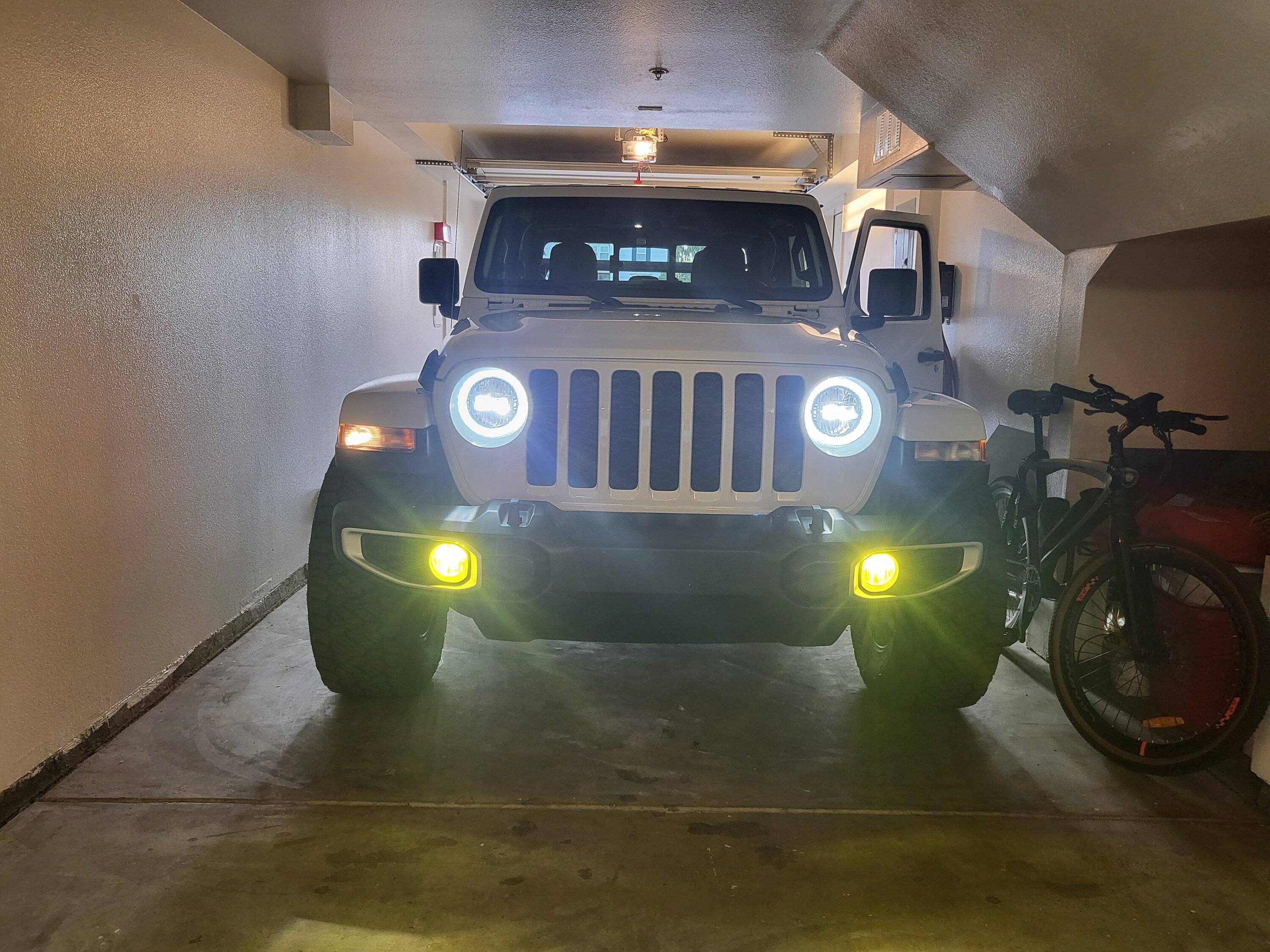

When the headlights are off everything is normal. What could be the issue?
Jeep Gladiator DRL issue with aftermarket LED headlights 20230408_073404

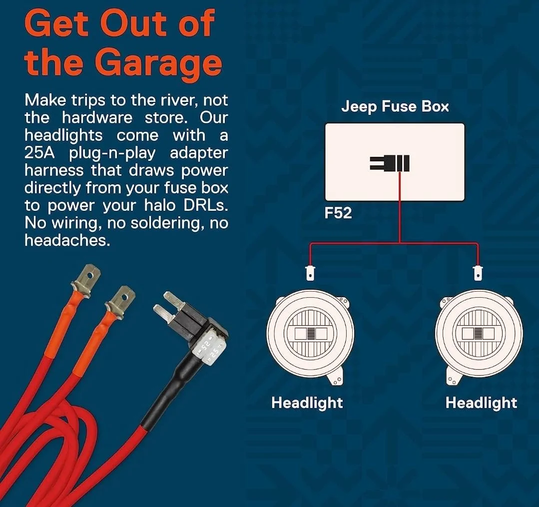

I ran the adapter harness it came with to Fuse 52. I'm thinking of taking the DRL bulbs out. LOL! :LOL:
