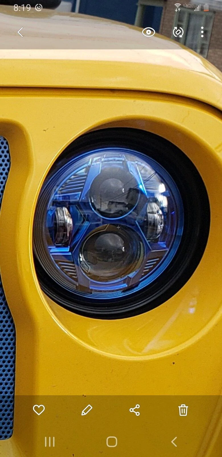

Yes there 7" led vs the 9" factory. Thats why I bought the correct brakes. I know I might be confusing some of you with this. The brakes worked. The head lights look great. but the is 1" gap from front to back not around. Its almost like I need a couple of washers & a longer bt to move them forward so the rubber seal rests on the grill. (If that makes sense

Are you sure you got your grille actually clipped in around the bottom? Bang it a few times around the bottom after making sure the clips are lined up.

Haha, yeah took it on & off twice banging it in to make sure.

So I was right about the 7" lights but wrong about where the gap was LOL.
OP, are you positive the brackets are not flipped (driver to passenger)?

If you live where there is snow, that gap is a feature. It will give the snow a place to go instead of accumulating in the headlight pocket and it will expose the headlight surface to some heated air.

I did the same with the Oracle 7". Bummed about it but oh well. I'm thinking about using washers as spacers to close the gap. My issue is Quadratec advertised like they were meant fir a JT. If they would have said JK lights for a JT I would've spent more to get the right sized light.

Wow I I saw these on quadratec but didn’t realize it reccessed the headlight that far
