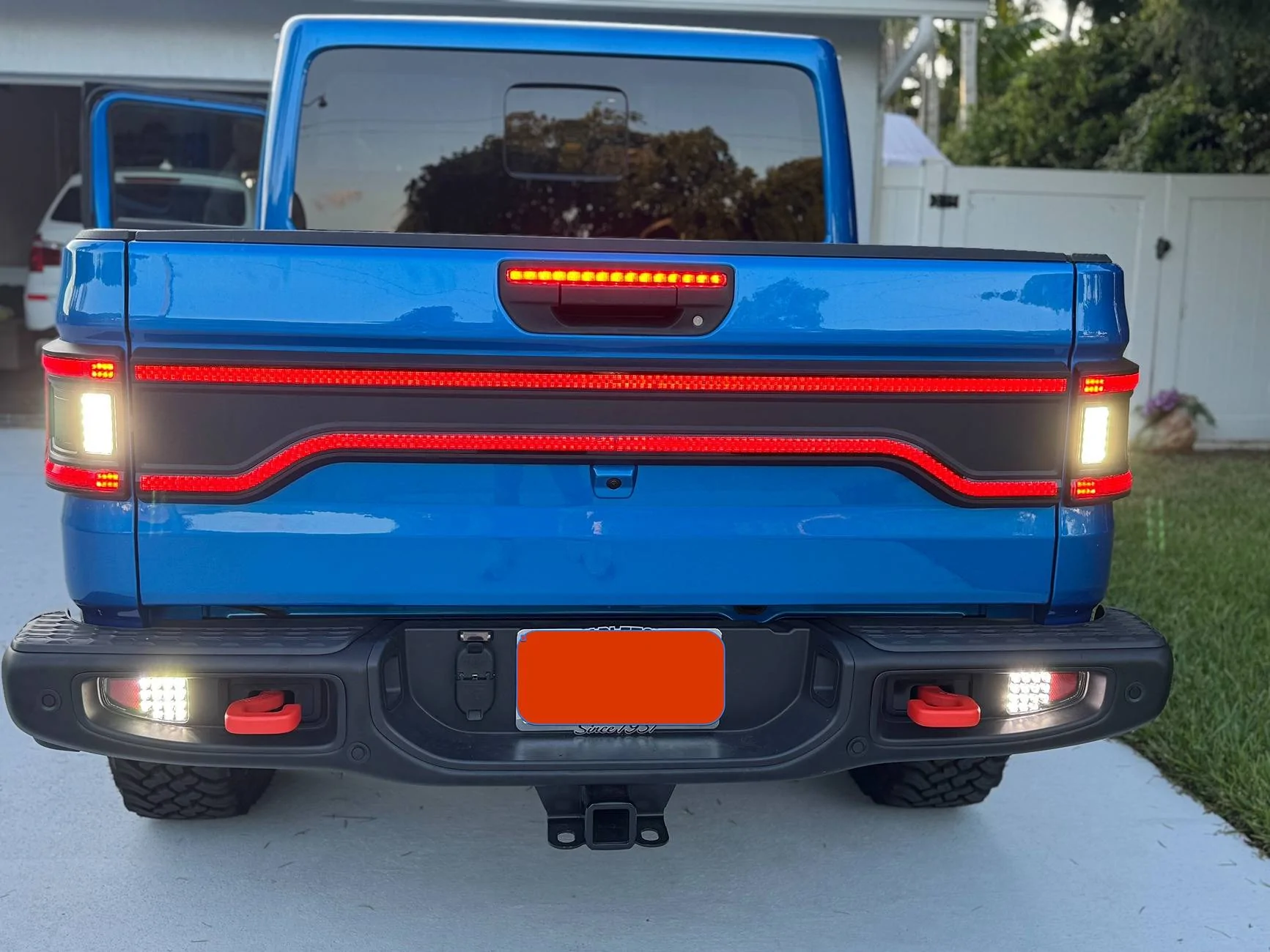

I had LED headlight option but halogen tail lights. I opted for Oracle flush taIL lights. Came with resistors to install without reprograming but I purchased JScan and the dongle plus extension wiring in case I
Jeep Gladiator I want LED Tail Lights - Do I need to reprogram (Tazer, etc.)? I have LED headlights. Jeep Tailgate latest
wanted to do other projects in the future. I reprogrammed and have had no problems at all with my new taillights.

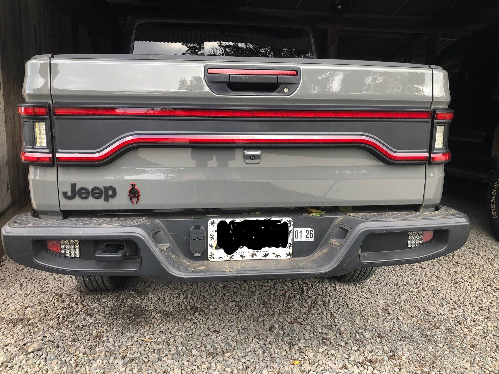

Did you look into the Oracle Reverse lights? Flyboy2109 has a picture of them installed. These reverse light are awesome. If you live in the USA, you can point the rear north and light up Canada!

Beyond liking the look, my nieghbor says by back up lights are brighter than my headlights!
I thought the halogen 'mouse ears' looked cheap on my nice Jeep.
