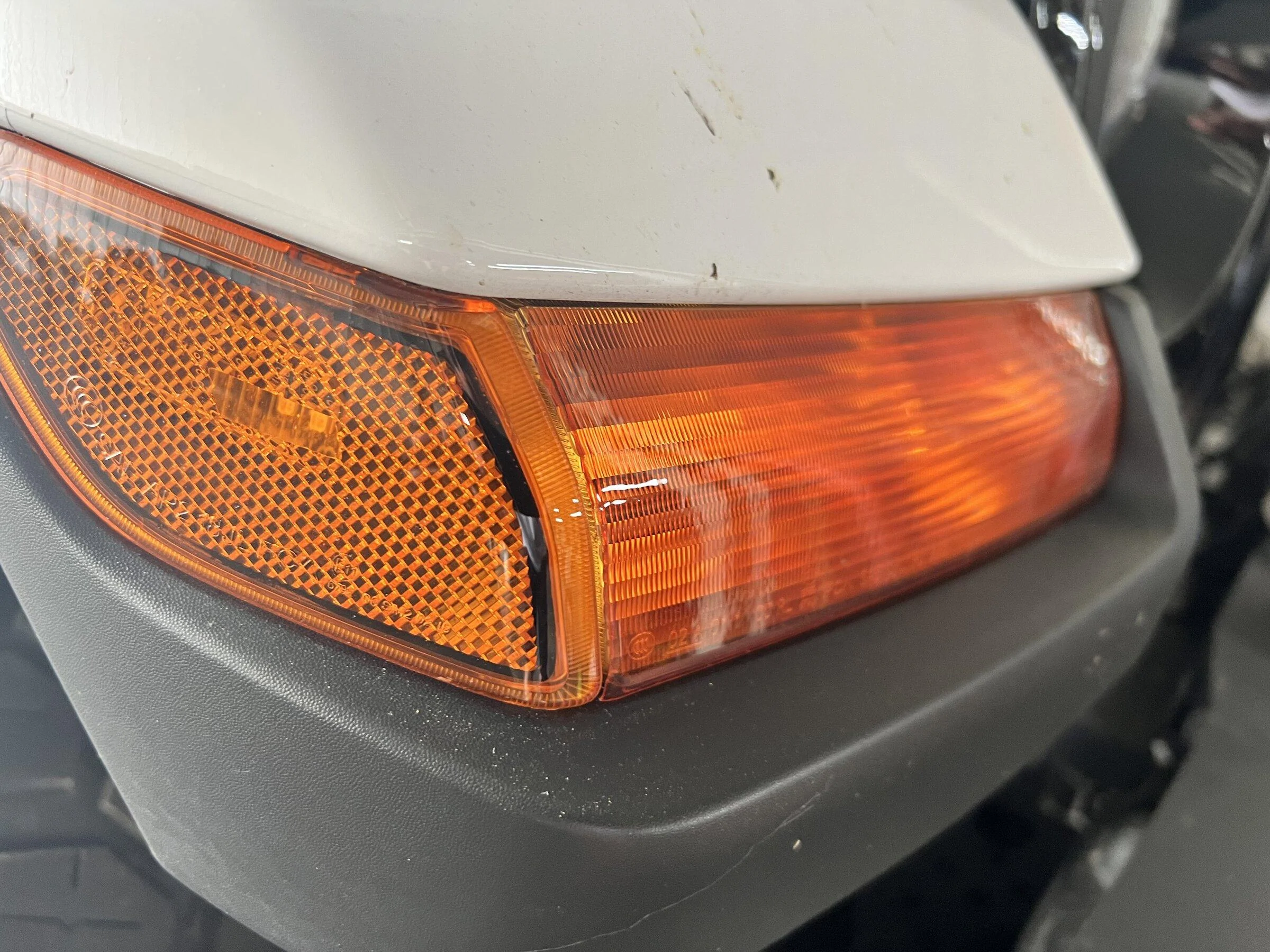

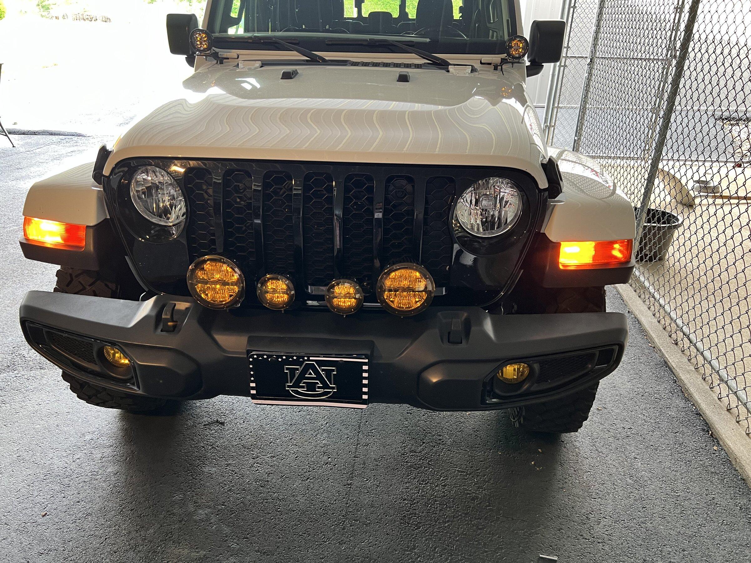

I used the lamin-x Film on mine. Got it from Amazon in a universal sheet and cut to fit.
It’s really thick , a lot thicker than a window tint . Sticky as hell . Better get it on right the first time or you will need to recut another piece.
I like the look and think it will last awhile.
looked everywhere for a lens replacement but don’t think they exist.

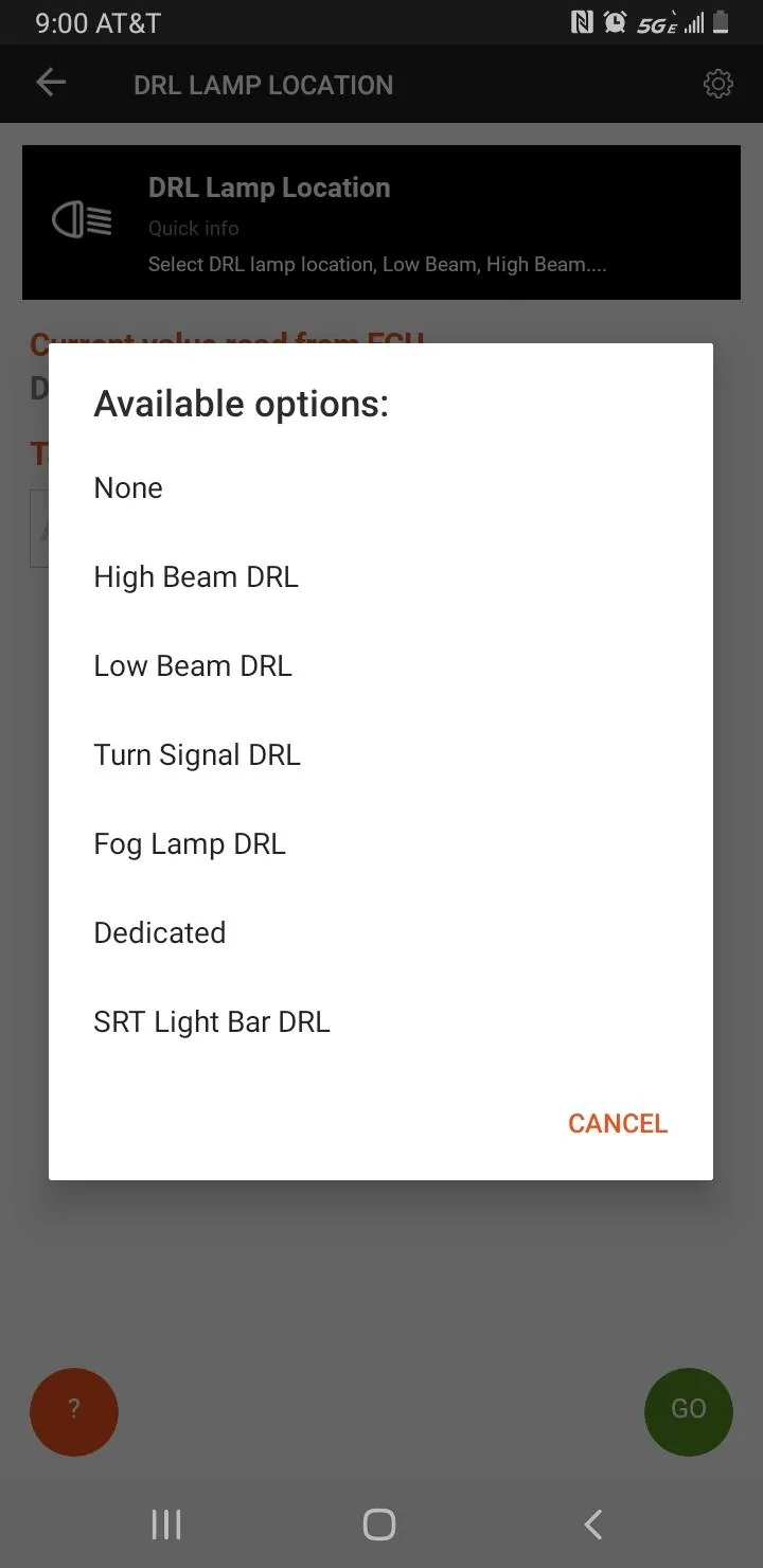

You can change the DRL setting in the computer to Turn Signal (amber) using the JScan set up. I ran my Wrangler like that for a while. Screen shot of DRL options in JScan app.
Jeep Gladiator DRL led color change? Screenshot_20220504-210013_OBD JScan

Got the big sheet. Cut down close to size then slowly trimmed it to fit. It’s like tint film, has a backing on it you peel off. I saw in the reviews people said you could manipulate it after putting it on like window tint . Didn’t work for me. Wasted one whole sheet trying. Ended up cutting it as close as possible to size and starting in one corner slowly pressing it on like you would a cellphone screen protector . Then used a razor blade to trim it up a little .
no air bubbles but it is so thick unless it was a huge air pocket you wouldn’t see it.
I like how it turned out. If anything happens to it I will do it again.

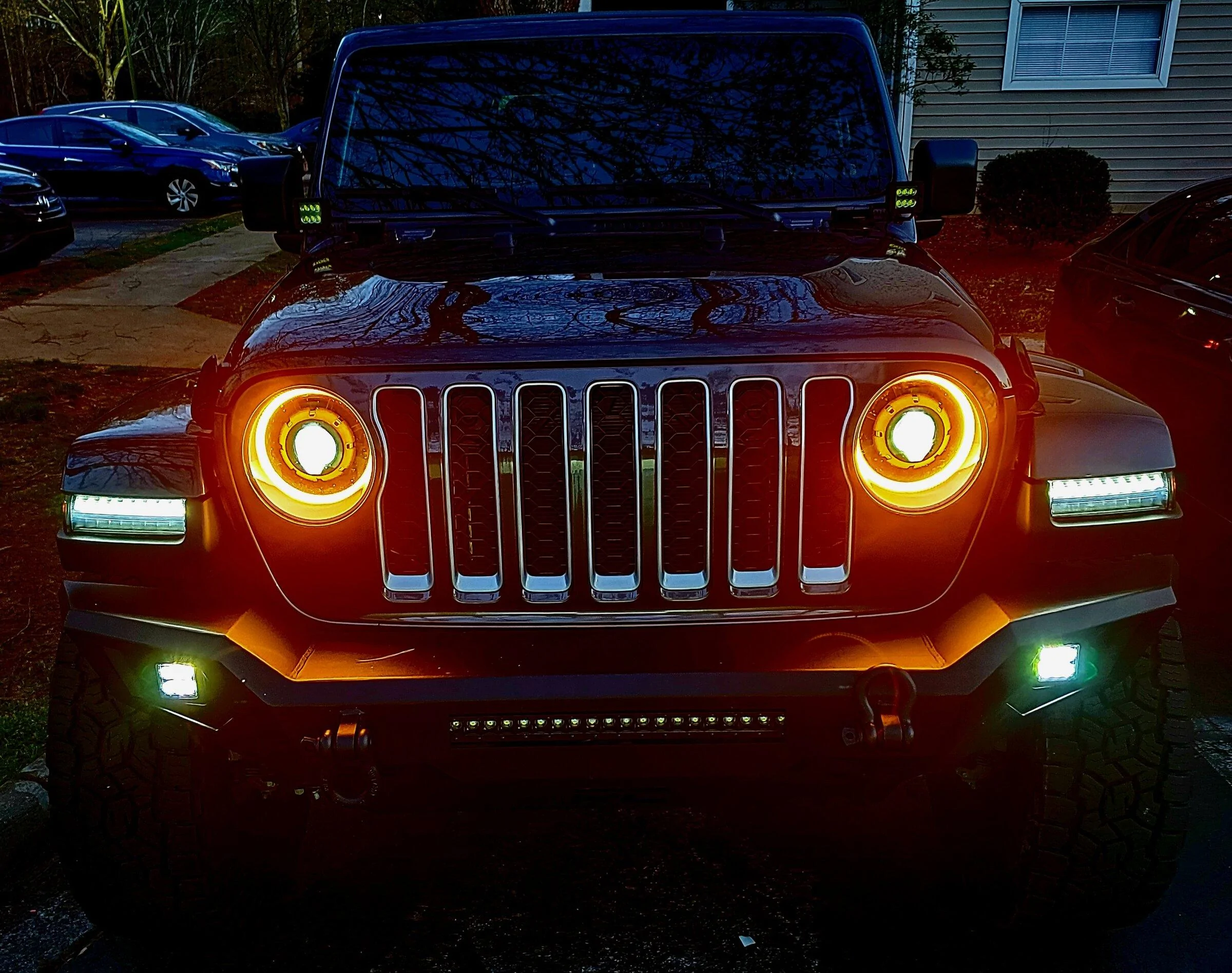

I had the choice to wire up my halos as white or amber, and I chose amber. I like the contrast with the white DRLs. All aftermarket stuff though.

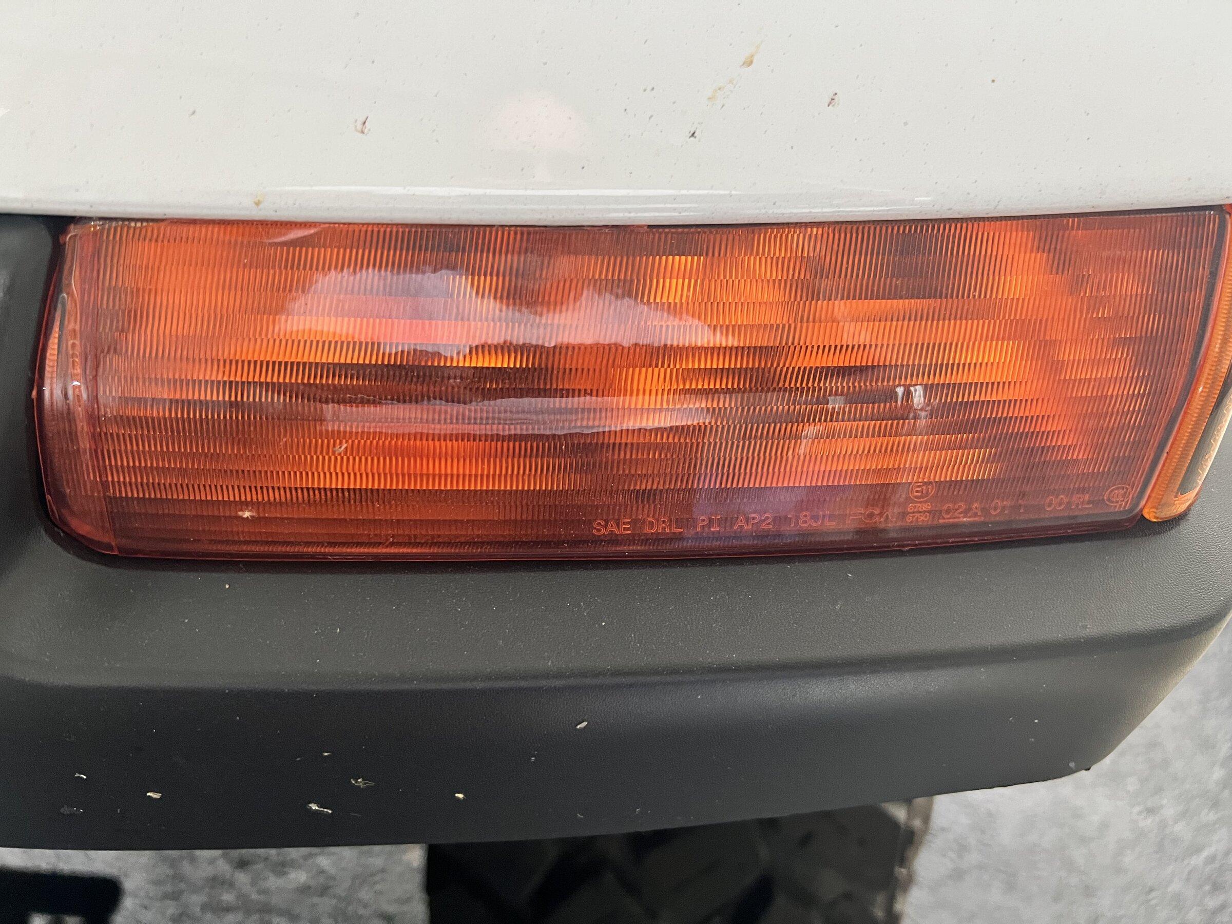

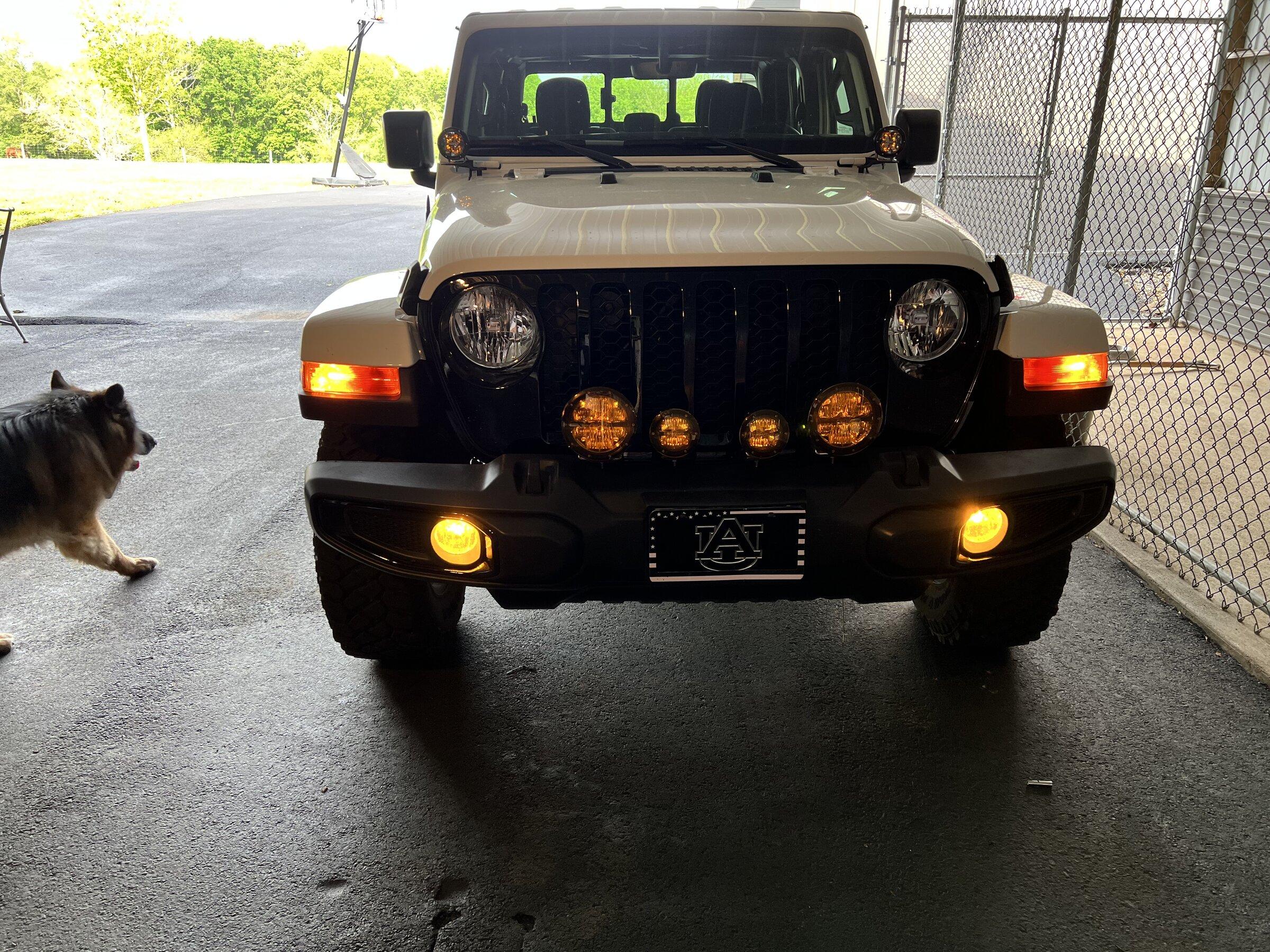

Here is a close up of it . I can’t tell it’s not factory other than it’s a little more Amber than the side makers

2 - if you have JScan you can switch the DRL to "Canadian" which uses the fog lights for DRL (or change the DRL location manually as suggested above)
