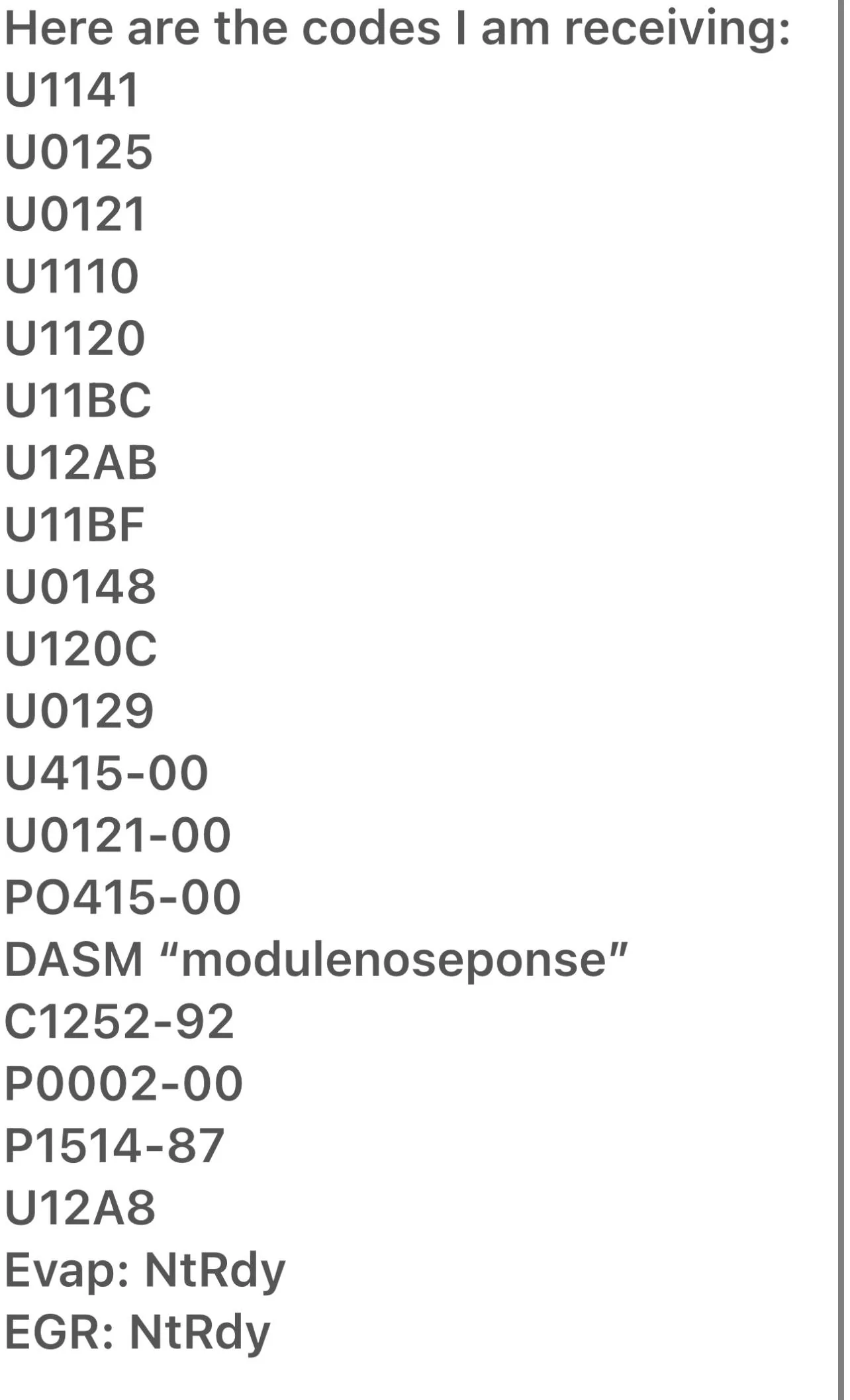

Very sorry to poach on this forum guys but this information looks really promising at helping me diagnose the codes I have been getting. I am going to drop the glove box and begin checking connections and adding dielectric grease to each connection. However, in addition to this, someone advised I look at the AUX battery and that it could manifest many of the same problems. I hope that exploring these two options will sort it out but was hoping someone here may offer some advice that I haven't looked at.
I have a 2020 JTR 3.6. The mods I have are an AEV 2.0 spacer lift, BFG KO2 37x12.5 R17 (factory wheels), AEV steering damper and AEV Geometry Correction Brackets. Until a few days ago I was using the Tazer JL Mini to configure everything.
I sent Tazer back for a replacement because I was getting multiple codes while driving that I believed were related to the Tazer failing even though I had 10 months without issues and upgraded the software as new versions came out. I removed the Tazer this past Thursday, unmarried it, disconnected the negative battery for 15 minutes then reconnected negative terminal and followed all of the instructions ZAutomotive told me to.
Today while driving it sans Tazer, I got all of the same error codes plus a new shiny one called “Service Shifter.”
This has been a constant situation for the past two months but progressively gotten to be more frequent and apart from being a major cause for concern it’s also been hard to pinpoint and a major pain in my a$$!
While driving I would get the ABS, Traction Control, Blindspot unavailable, Brake light and loss of power steering. When I pulled over and put the Jeep in Park, I couldn’t get it out of Park. Without the Tazer I also don’t know how to clear the DTCs. I shut the engine off for a couple minutes and was able to shift into Drive but the “Christmas tree” of lights remained…eventually after slowly creeping along the back road home all the lights went off except for the traction control light and the check engine light. The “Service Shifter” warning was most troubling as was the loss of power steering.
I’m getting the following codes and could really use some help from anyone with knowledge on what this issue could be caused by.
