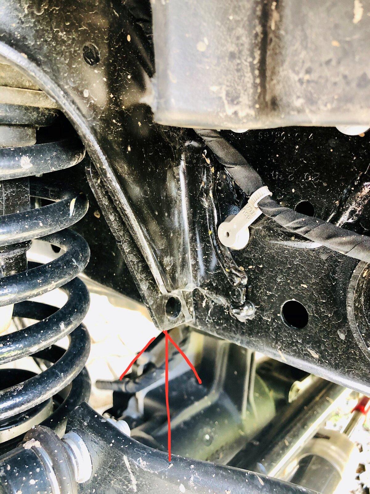

EU Overland is very different form US Overland.
EU Gladiator got not only Mojave hood but also Mojave cast iron knuckles on front axle and Mojave reinforced frame!
This means that if you want to use Synergy Front Track Bar and Sector Shaft Brace than you have to cut this coil bucket gusset.
Jeep Gladiator Euro Launch Edition Gladiator EU Gladiator 1
I wonder if Synergy will make Mojave specyfic brace. This would be nice.

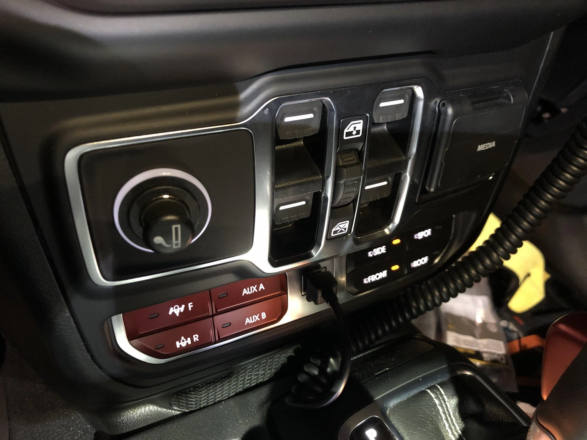

I managed to put my hands on a set of LASFIT switches.
I really like the clean look and way how it works.
Looks like factory and also switch backlit is on only when lights are on. Like factory switches.
Locker switches can work in two modes.
Safe mode - only in 4LO - if no 4LO, swith will not activate and gives warning beep. If activated in 4LO and changed to 4Hi it will be automatically deactivated.
Normal mode - as a normal switch
Central RJ45 port fits my CB Radio for even cleaner installation.

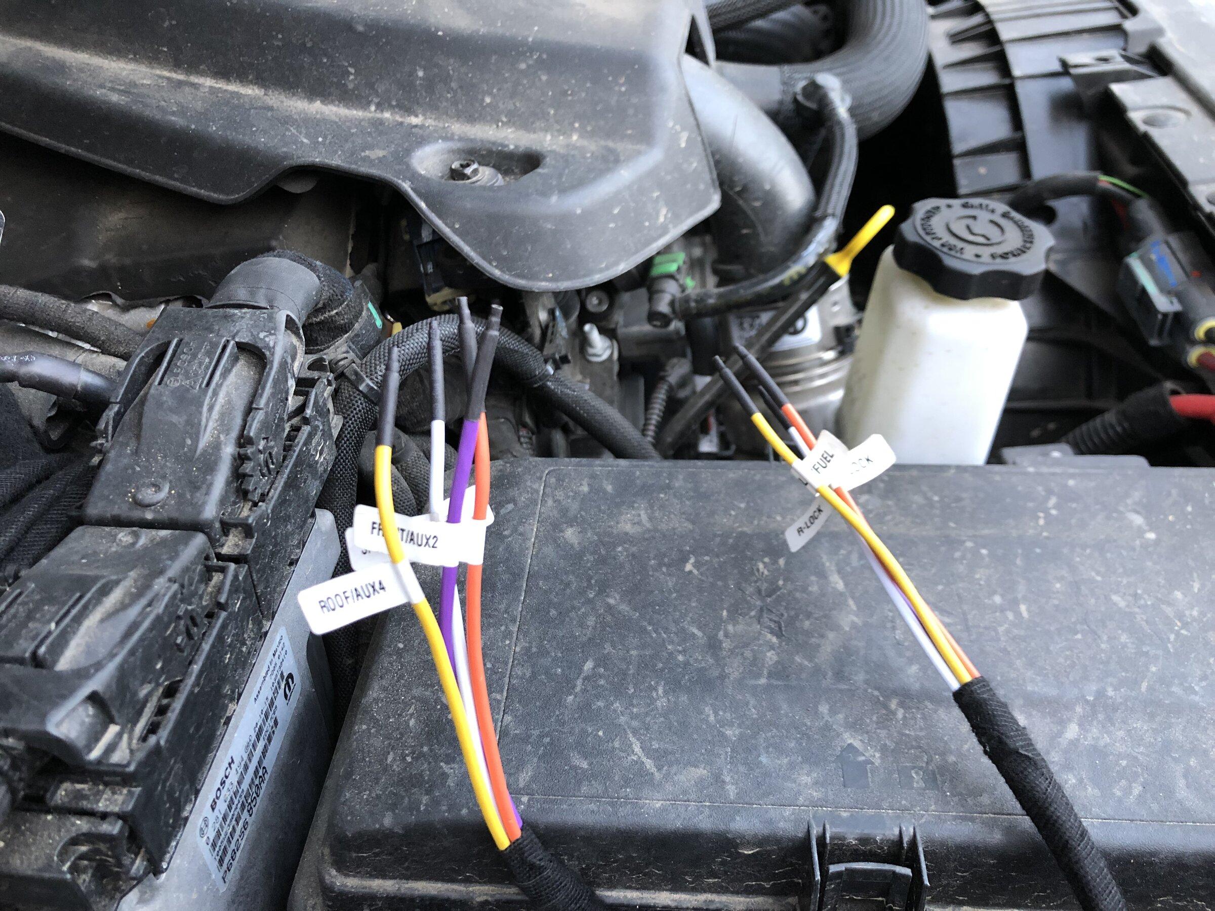

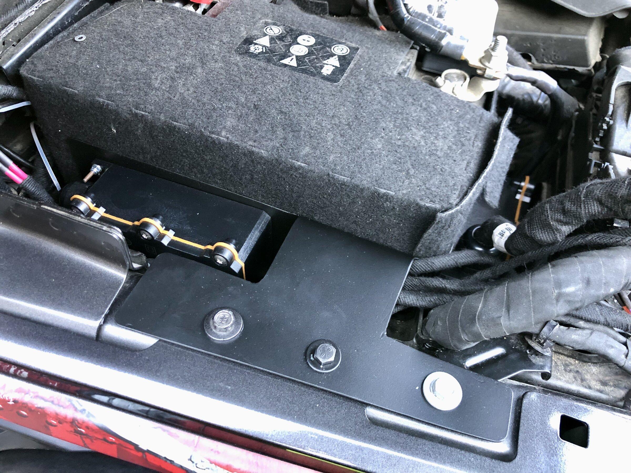

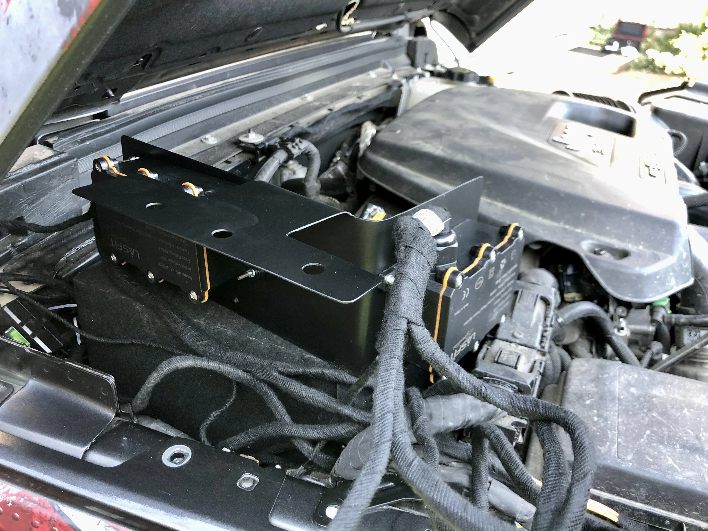

Lasfit Diesel setup:
This set is designed fir gas models so i had to be a little creativeBiggest challenge was to find place for relay box so that wire harness will fit. Place where it should go was not available and also wire was impossible to install as it was designed. I changed the side and found perfect locations. Some play with angle grinder, black paint and I am very pleased how it turned out.
