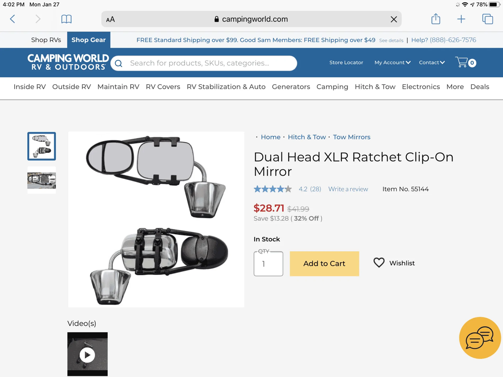

Yeah, we could use clip-on mirrors, suction cup mirrors, strap-on mirrors, etc. But to quote another forum member from a discussion on trailer brake controllers last year, "that's so 90s". It's the principle. We shouldn't have to do that on trucks that cost this much and are advertised for towing.

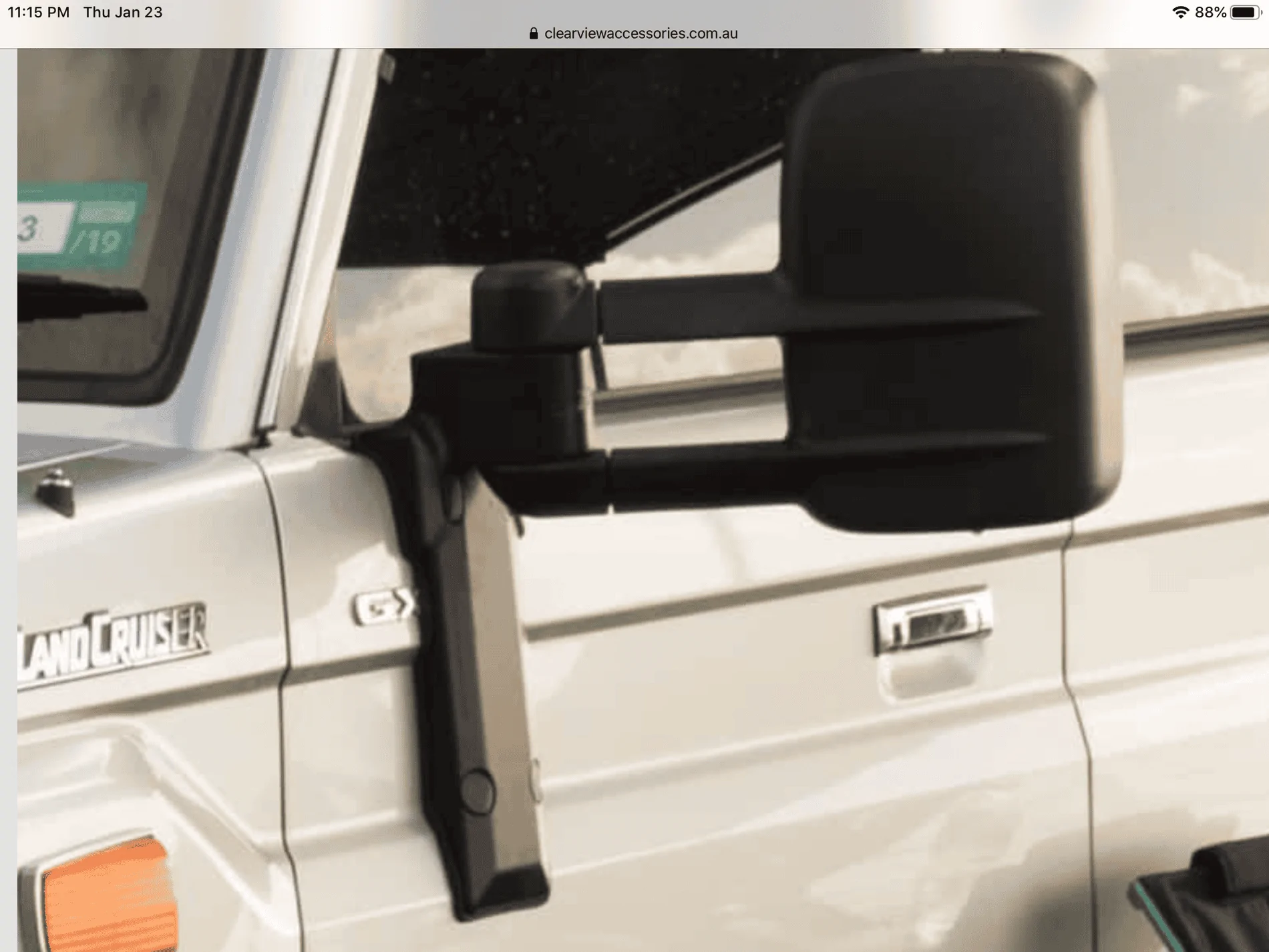

I'm going to hold out for a Mopar or aftermarket full replacement mirror that allows proper range of adjustment and field of view.
I wouldn't hold your breath over this as none of the manufacturers care to listen to their consumers on details like this. They only focus on what gets them media coverage. Clearly whoever designed the Gladiator doesn't use a pickup like a pickup. I don't have an issue with that, but as you said this pickup was marketed as a pickup and should have the pickup basics......

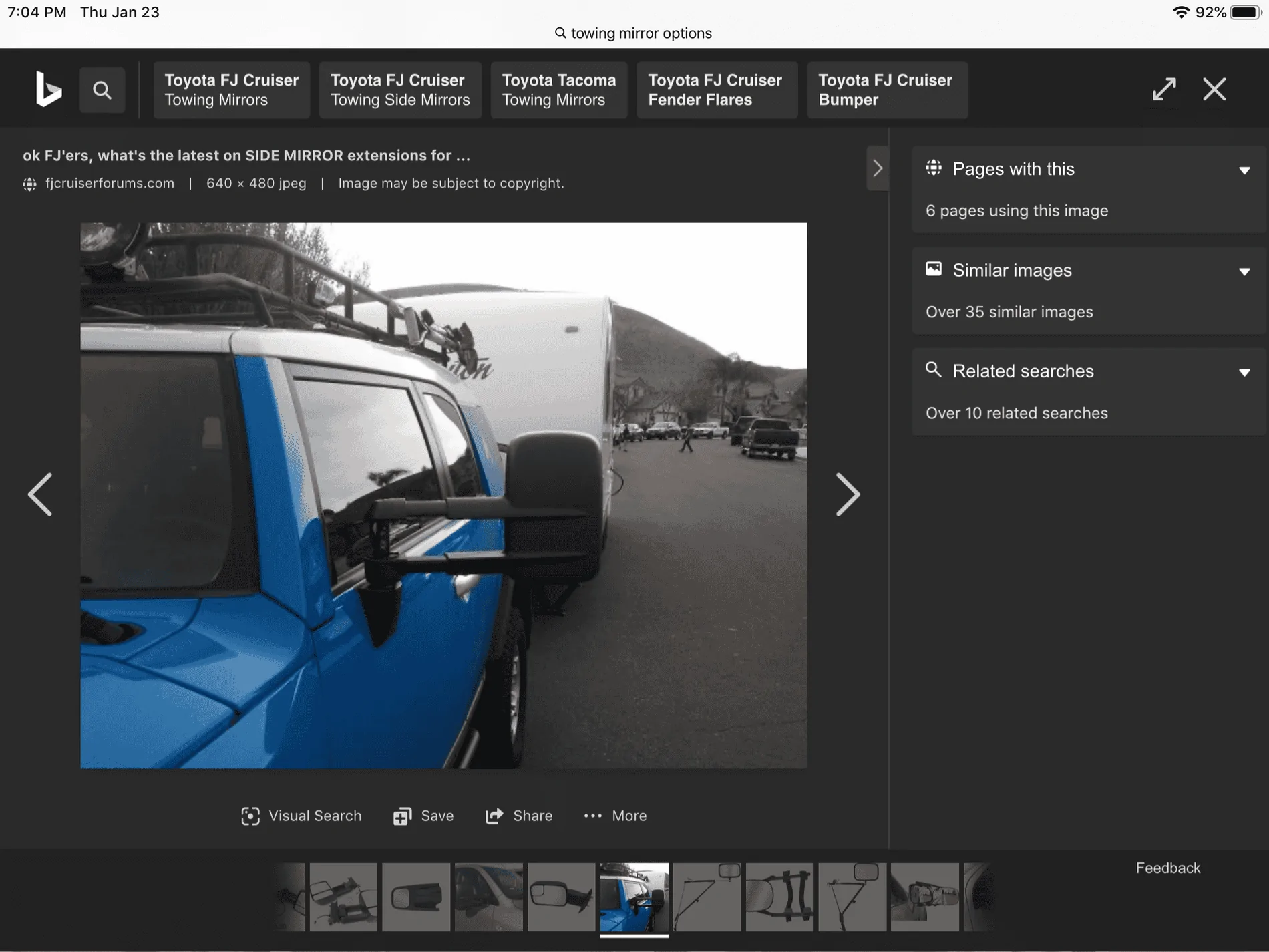

I am thinking of 2 options:
  1. Tap out the bottom of the door mirrors and install some type of quick connect rail (t-slot or something like it) that an auxiliary tow mirror can mount to.
  2. Create a adjustable secondary mirror that mounts off of the hood / window frame area for use while towing and when doors are off.
great idea! You could use a Picatinny rail mount for this. They make all kinds of lengths and are a very secure mounting rail.
