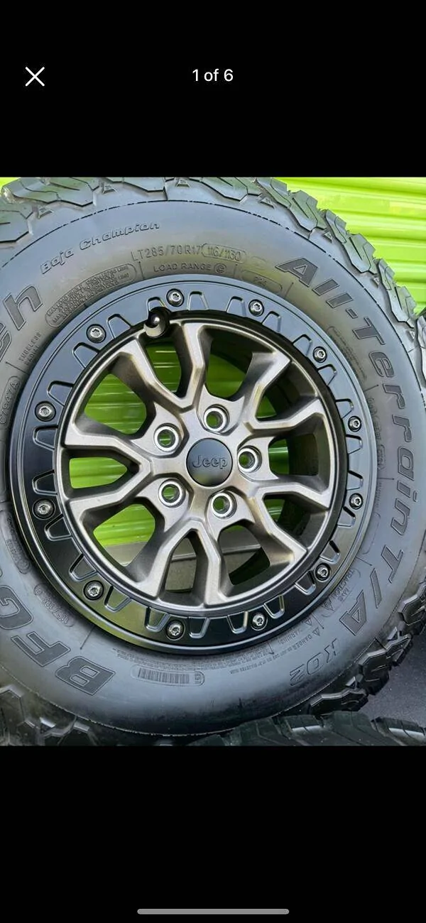

Does anyone have these extreme recon wheels on your rubicon gladiator? I like the look and wanted to see how far out they stick from the fenders. Thanks!

That would depend on the offset of the wheel

+12mm offset on the 8" wide Extreme Recon wheels vs +44mm on your stock 7.5" wide wheels.
So you have a 32mm (1.26") difference on offset and another 1/4" due to the wider wheel.
Outside face of the Recon wheel will be 1.5" further outwards than your current wheels.

This is what I was looking for, thank you!

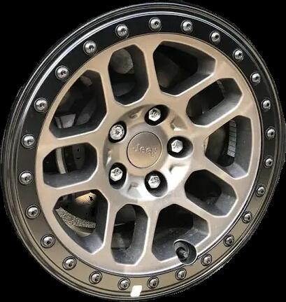

Do you happen to know what the offset is on these 392 wheels and how far they would stick out? Im also considering them since they are easier and cheaper to come by. Thanks!

Those are the same as what you have now. 7.5" wide and +44 offset.
