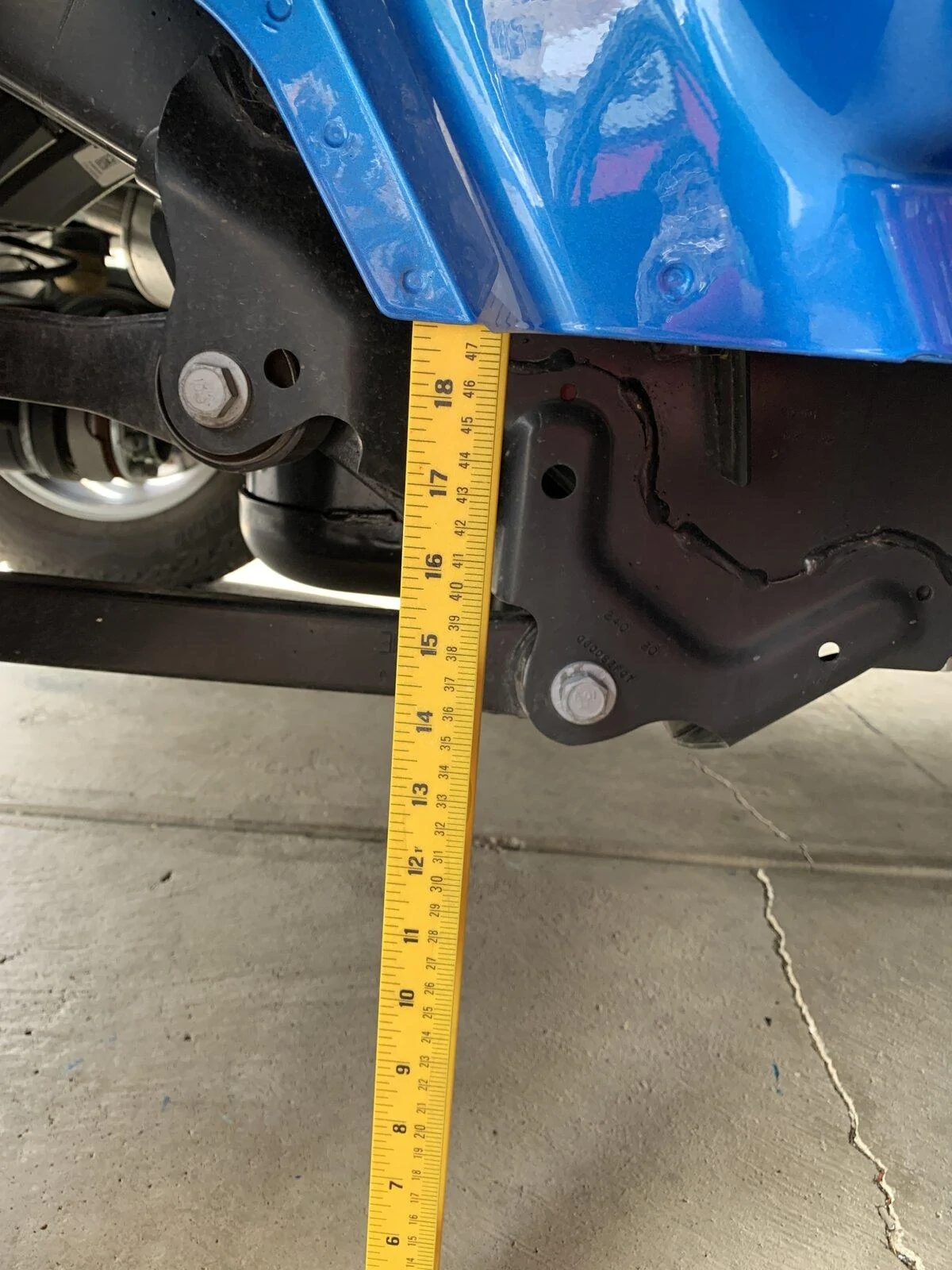

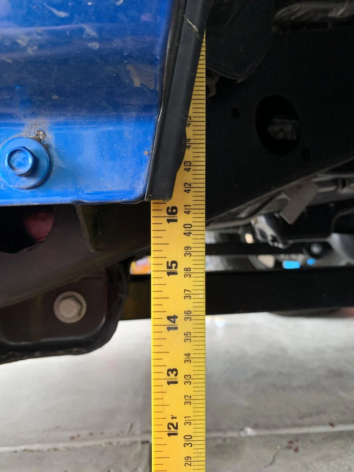

I'll get you my other numbers later but CURRENTLY, measuring at the bottom edge of the running boards which seem to follow that pinch weld line pretty closely -
17.25" at the rear
15.5" at the front
Keep in mind I put in Rubicon front springs and max tow rear springs. The max tow springs were a shade shorter than Overland springs.
It gets more complex because I added a winch and steel bumper, so I'll have to try to find my original numbers, but I bet we were not too far apart in rake before I started Frankensteining my truck.
Maybe mine isn’t as far off as I thought then. Just looks a hell of a lot more slanted then the others I’ve seen at dealers and on the road. Thanks.
Edit—-forgot I had pics.
Jeep Gladiator Factory spring mystery 3BA73E1F-443C-4A22-9C83-CED6D6FB4204
Jeep Gladiator Factory spring mystery 967D131F-29B4-4733-912B-0BABF85CA475
Those on dealer lots in most cases SHOULD be stock, but around here....... never know. On the road, we have no idea. Leveling kit, lift, load in the back, etc.

One reason I was even trying to figure it out in the first place is because I seem to have a TON of forward rake. More than the non-80thA editions I’ve seen around.
When measured at the front and rear of the pinch welds, I have 2.5” inches of difference.
I could find almost nothing on the new spring numbering either. I was looking at some Rubi takeoffs and wanted to compare to my stock setup before I purchased a set, but since I could only find write ups on the old spring numbers I took a chance. My rake was very close to that too around 2" IIRC. However, I just swapped springs and shocks yesterday from a JTR (339/340 & 449/450). The rake is 1 1/2" now. The ride is a lot stiffer than I thought it would be btw.
17.25" at the rear
15.5" at the front
I just measured the same on mine and I have 16 1/2" front and 18" rear on 33" tires. Stock bumpers no winch. Using the same measuring points, my previous 2015 Silverado had a 2" rake factory so I have less rake now than I did with that truck.
