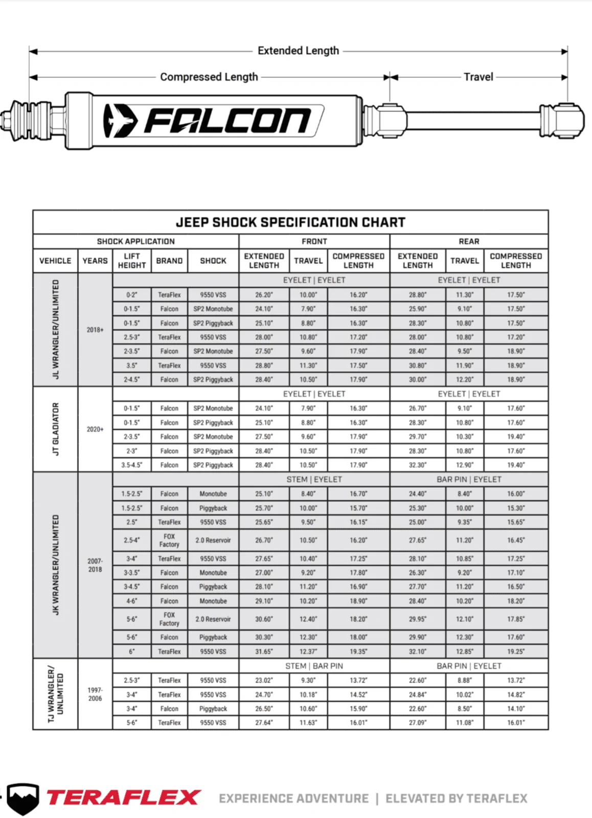

I am running the Falcon SP2 3.3 Fast adjust shocks with a Clayton 3.5" overland plus kit. Almost 30K miles, lots of off-road and rocks, and the shocks have been bulletproof. I really like them, best I have ever had. I got the 3.5"-4.5" spec'ed shocks and I recommend them for the Metalcloak lift because the rear shocks are nice and long, an extended length 32.30". Very impressive. That will give you additional rear articulation for your Gladiator. Here is the Falcon spec. chart.

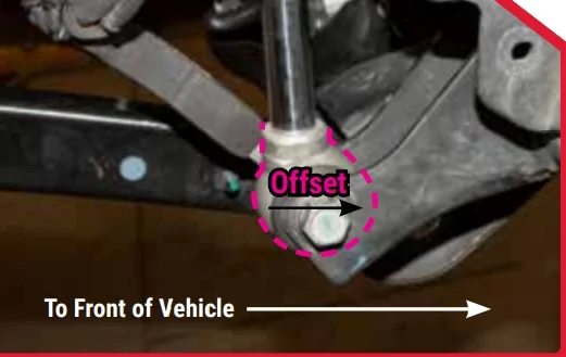

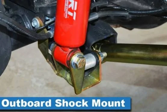

Just my two cents speculation but I believe it has to do with the front outboard lower shock mount included in the lift kit.
Falcon unlike most other shock makers uses a lower offset mount hole eyelet on their front shocks. When using the Metalcloak outboard shock mount kit on the front, it moves the mount outboard and up about 1.5". When installing the shock to this mount, it will move the upper shock body mount side forward. Falcon for their reservoir shocks have the reservoir hard mounted to the upper body and probably would hit the frame side of the upper shock mount area with the lower eyelet offset compounding things. A straight monotube shock or other shock makers that run a flexible line to their remote reservoir that is mounted separate, probably does not have this issue.
I have the Falcon SP2 2.1 monotube shocks and also installed the Metalcloak outboard shock mount kit and flipped the offset of the lower mount to make it fit, but it is whisker distance of the upper mount body of hitting the frame side when I exercised the suspension travel. I would imagine any Falcon shock with their piggyback reservoir setup and adjustable knob would hit.
