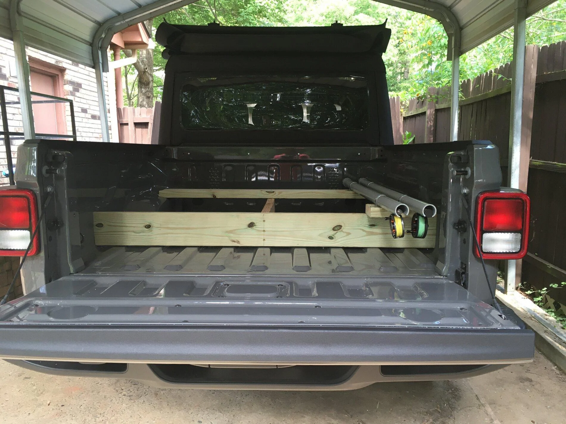

One of the first things I did when I brought my Willys home.
(1) 10’ stick 2” PVC
(2) Female adapters
(2) Clean-out plugs
(4) 2-hole straps
I cut a slot for the reel to hang down. Mounted to 2x6s in the bed. With the tailgate closed you can hardly see the reels.

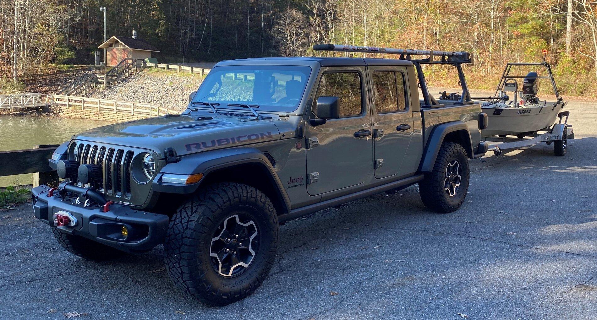

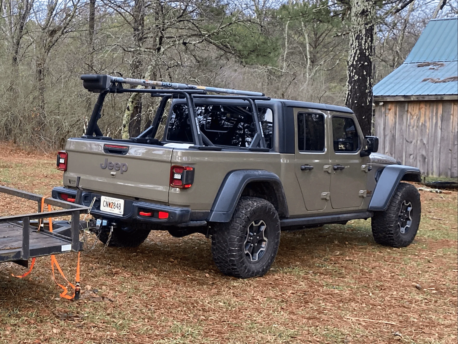

I have changed things up a lot since this post. I now have a Softopper canopy with a kitchen/sleeping platform and a fridge on a slide, so this doesn’t work anymore.
I mounted the 2 rod holders to plywood and used 2 U-bolts with wing nuts to attach to the @Softopper frame.
Jeep Gladiator Fly Fishing Rod Vault: anyone installed ? A314AD26-BE28-48EE-AC12-B56735F85794
I have lights on the frame too now, but no photo with both the lights and rod tubes.

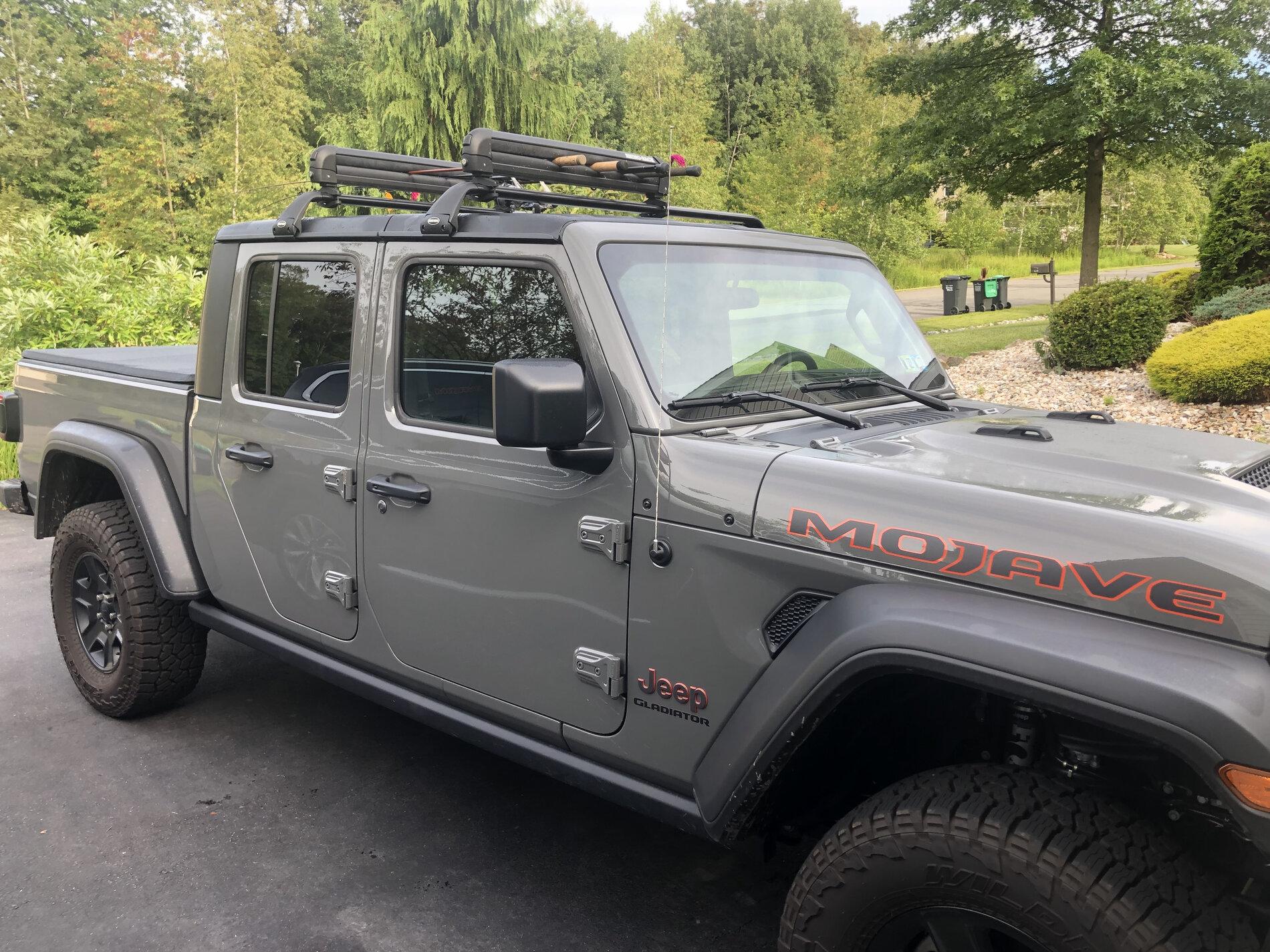

Not my Jeep, but talked to the owner while at the flyshop. he has had no issues. mopar roof rails.

Nice
Ideally I'd like to mount further back so I could use a soft top
But would involve a bed rail which I don't want or more likely but more expensive a rsi cap.
lots of ways to spend money and key can't have everything but good to explore the options
