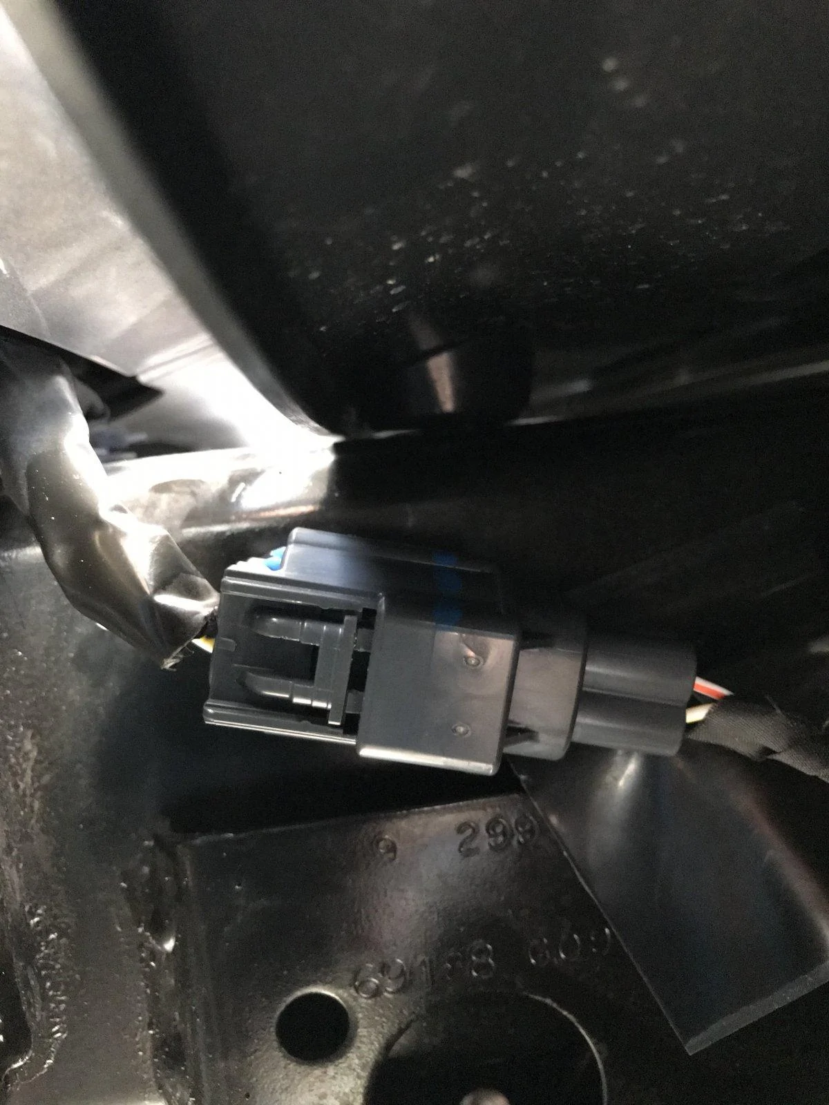

How to disconnect the fog lights?
Where am I pushing?
Which way am I pushing?
Jeep Gladiator Fog light disconnect? B8643A3D-90E5-4246-86CD-7D4B52E40210

It's been a while since I did this.. but there is a square hole on the front of the connector. (right side of your picture) Use a flat blade screwdriver inside the square hole. press in (I think). If you shine a light down the hole, you can see the catch.

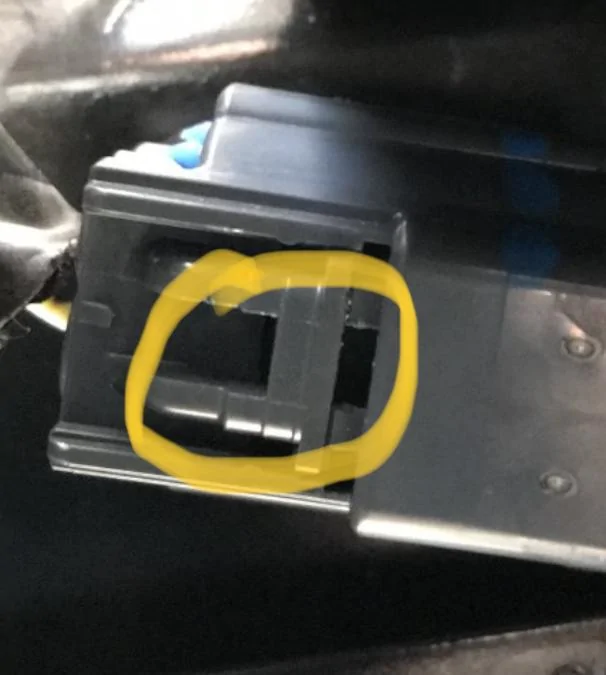

I did this a few weeks ago and if I remember correctly you are pressing the part on the left and the big square in the center stays with everything on the right.
From what I recall, press here, then pull apart.
I agree with this I did not need any tools when I did it.
