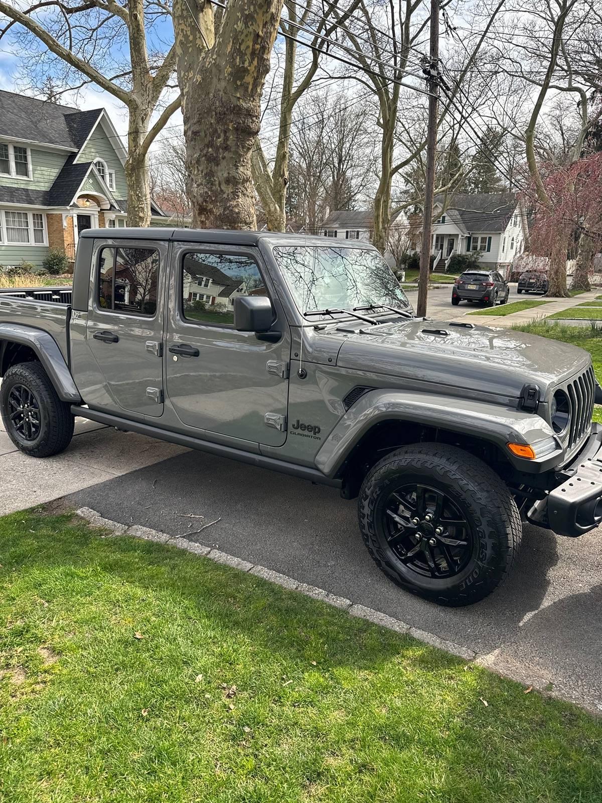

Hey all, just purchased a 2023 Freedom Edition Gladiator. Really like it so far, my 8th jeep and a real upgrade from my 13JKU. My question is regarding upgrading the tires? I am online with FB market and they have tons of tires and wheels for sale? I’d like to keep my wheels and just slightly (33”s) upgrade my tires? What are my options? Will a Willy’s size fit? Any help would be greatly appreciated!

The main question is, what size are your wheels? After that, 33's will fit and you can still flex. 35' will fit without disconnecting the sway bar.

If you don't have max tow, the diff is narrower and I would recommend a narrower 33" like the 255-80-17. I have them in Falken AT3W and prefer them to the wider stock Mojave tires.

I like actually prefer the narrow tire as well, thank you I will do some research on you reco!
I have this size:
I ideally only want to go up to 33’s to start.
Tires & Wheels
17 x 7.5 in. wheelsStandard
All terrain tiresStandard
P245/75R17 tiresStandard

Kenda kevlar at is another skinny tire.
