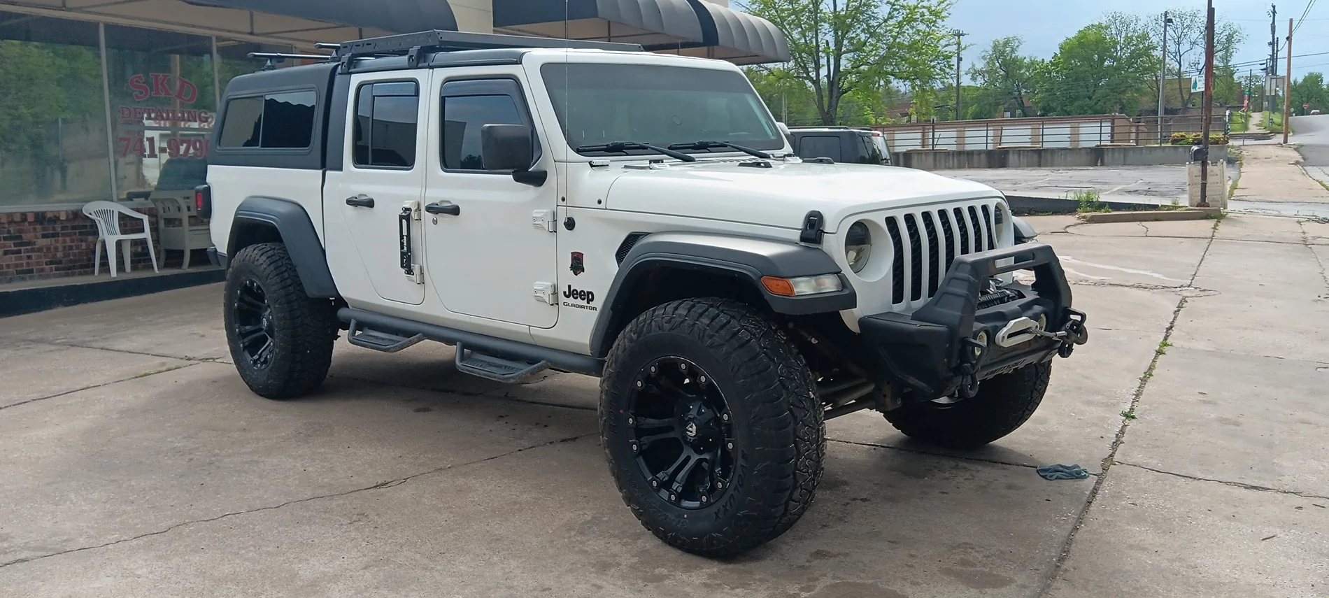

Have a Gladator that came with a JKS 3.5 inch lift and Fuel Vapor 20 inch wheels. Does not have a spare and I need one.
1. Would anyone know what width and offset these might be?
2. Anyone have an extra 20 inch wheel in the right bolt pattern and want to sell it?

That wheel, the Fuel Vapor, comes in three different configurations in a 20" size it seems.
20x9 wide with 3.75" backspacing
20x10 wide with 4.75" backspacing
20x9 wide with 5" backspacing
The wheels should have there size stamped / molded on them. For backspacing you can measure.
The standard bolt pattern for modern Jeeps is 5x5.
