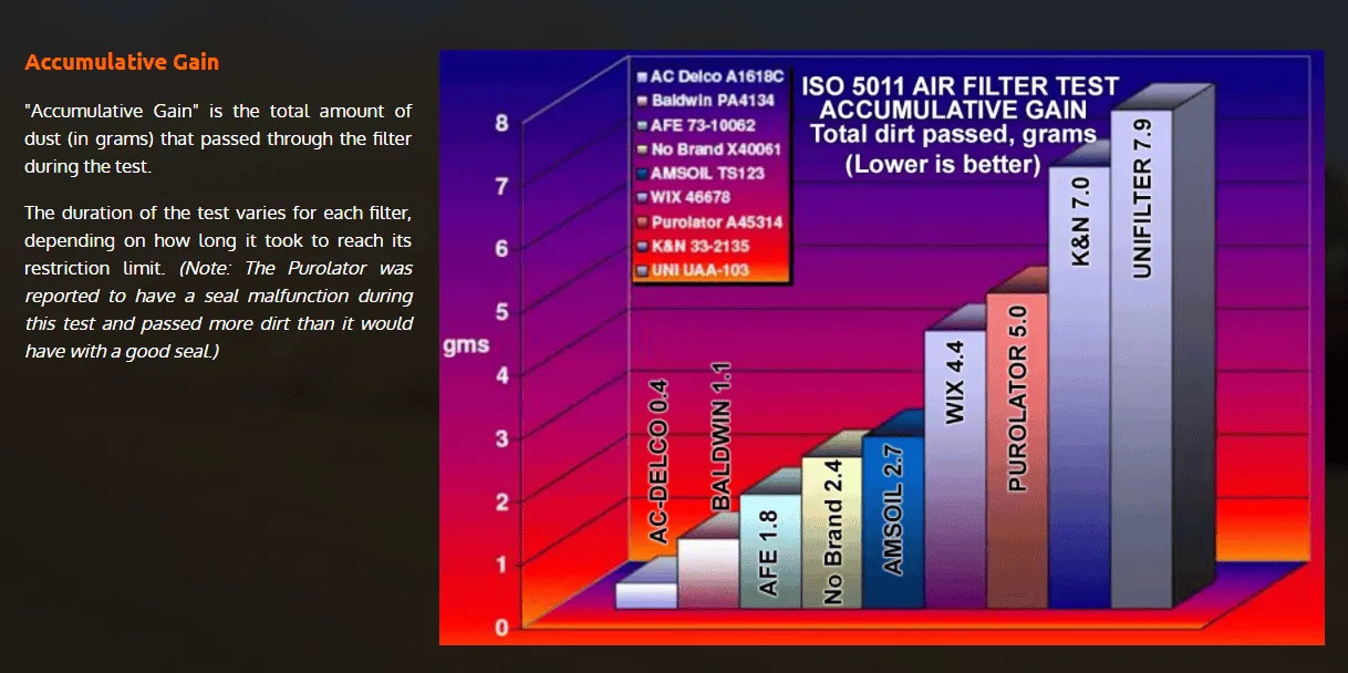

K&N passed more dirt over time. The top of the bar is the time, the dark zone is how much dirt passed in that amount of time. It was quick to reach "full" or getting to a restriction point while at the same time passing more dust.
Jeep Gladiator Future Gladiator Mojave owner total-dirt-passed-2
This is similar - shows the total amount of dust that passed through before the filter reached its saturation point. meaning - they pass a lot of dust, but plug up quickly vs. other filters which will last longer under really dusty conditions while passing a lot less dust and dirt.

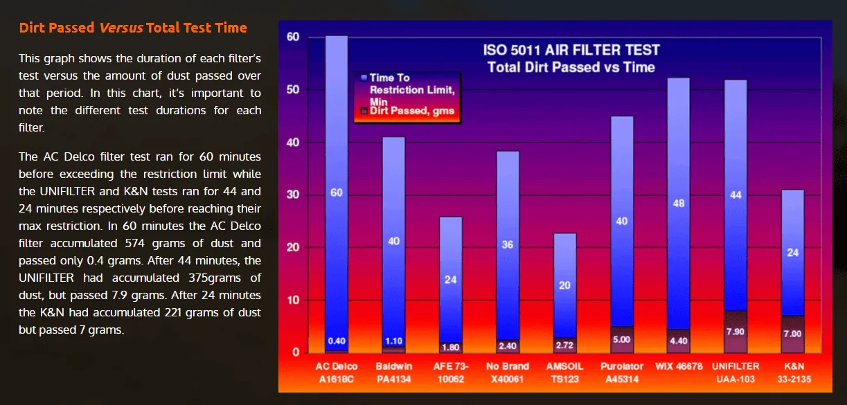

The above were not "flour dust" or home brew tests in someone's garage or shop. They were tests under standard conditions, ISO tests, performed under strict measured conditions.
In short - the K&N is wide open to flow more air off the line, but very quickly reaches a point where it's passing less air, passing more dirt in the process.
Testing showing any better flow is only with brand new filters - after an extremely short time they are actually restrictive (if they were cleaned and oiled properly to begin with)
I could say it sort of like this - if you used a K&N for racing performance, you'd want to wash and treat it after only a handful of runs, and hope the air around the track is clean of dust.
I have others, but people prefer to see marketing materials, youtube crap tests, bogus numbers and so on vs. scientific testing under controlled conditions making things fair to all filters being tested.

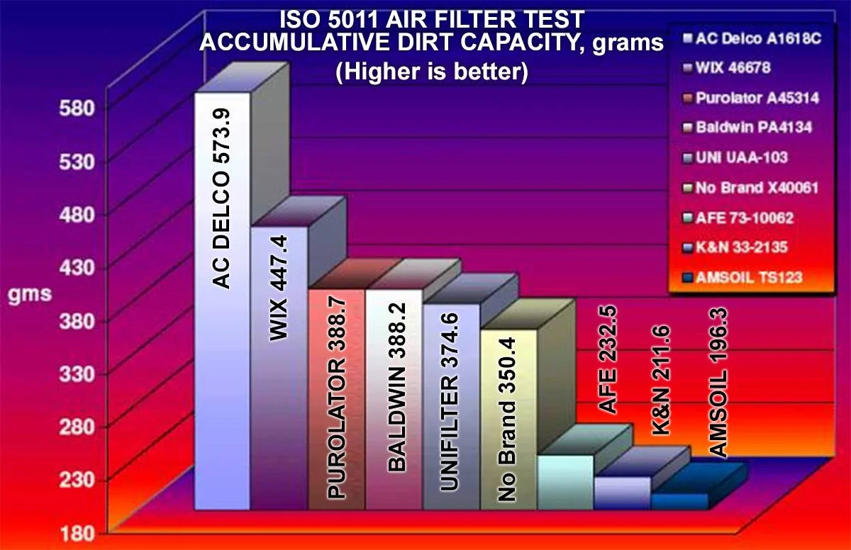

"Oh but I can wash and reuse it" - you'd better do that very frequently, then - because they have a very very low capacity for accumulating dirt -
Jeep Gladiator Future Gladiator Mojave owner ISO5011_accumulative-capacity

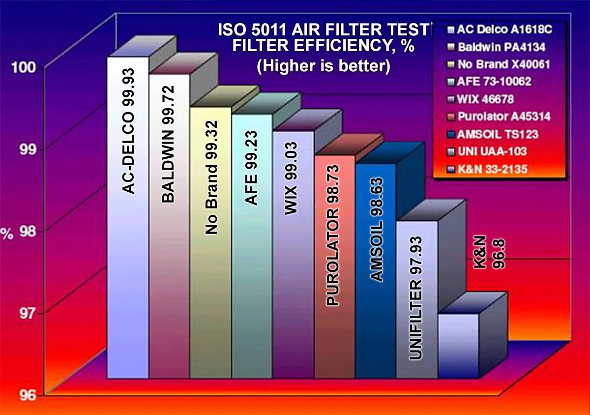

For efficiency - they are pretty much dead last -
Jeep Gladiator Future Gladiator Mojave owner ISO5011-efficiency
