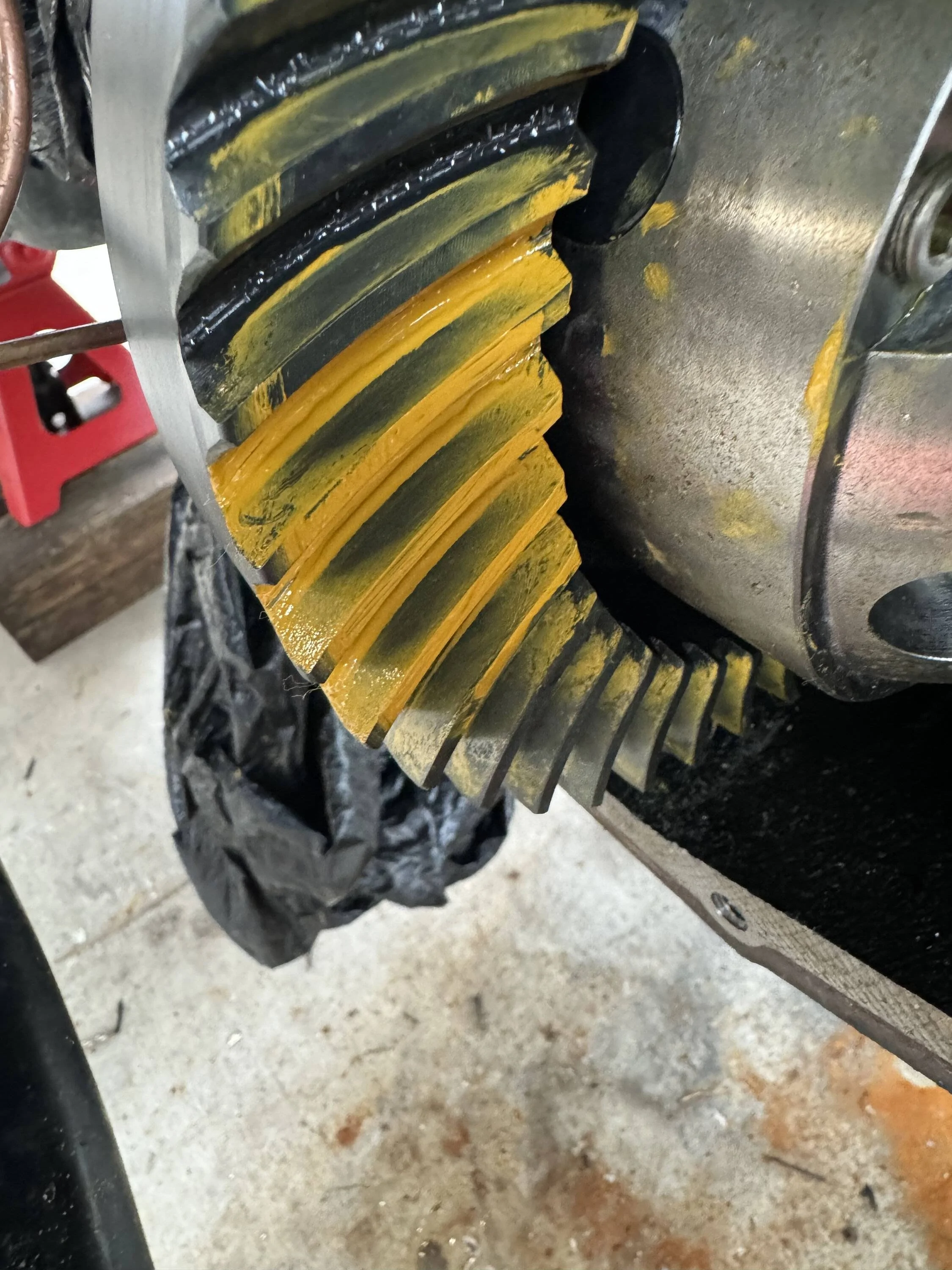

Is this too deep or too shallow? It still has the harsh line which indicates it's too deep, but it seems like the pattern is too close to the face, which indicates it's too shallow.

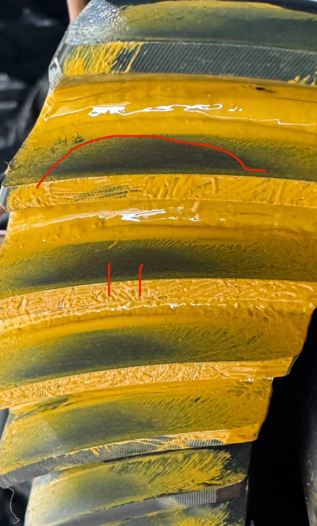

Jeep Gladiator Gear pattern check IMG_9202
This time the “harsh” line at the root/base of the tooth seems to be paint being thick down there, rather than from the pinion gear rubbing in a flat line at the root of the tooth, if that makes sense. The arc I’ve drawn shows the edge of the pattern the pinion is making, which is not a harsh flat line.
I cannot tell from the photo alone if it’s too shallow, but you can try this trick to determine: wipe a Q-tip outwards as if wiping between the two parallel lines I drew. If there’s a “gap” between where the pinion gear rubbed off the paint and the top edge of the tooth, then it isn’t too shallow.
