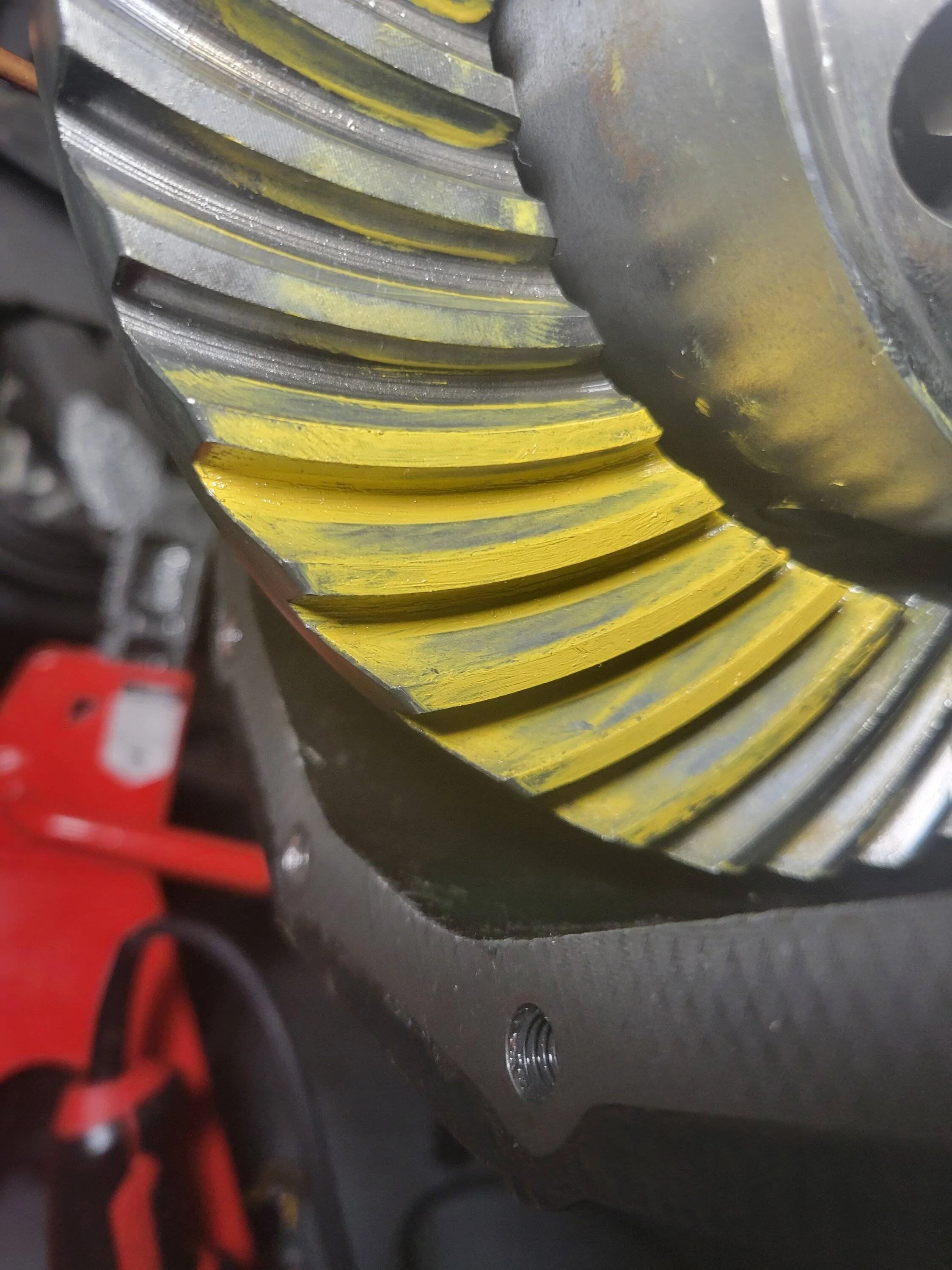

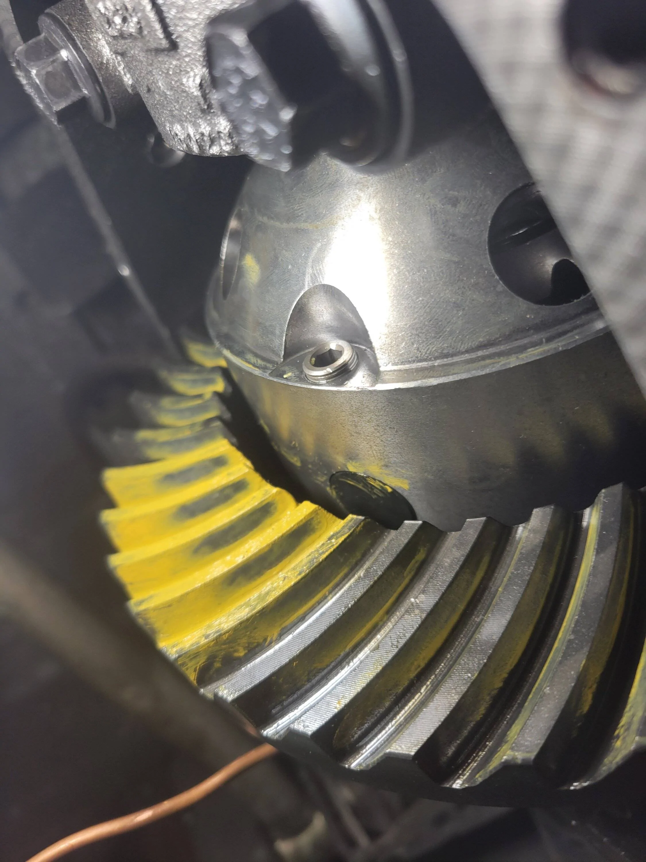

Checkout this gear pattern, why am I getting howling under load around 45mph?

Okay I increased backlash to 9.5 mil and the noise is better but still there. I did not change pinion depth. Do I need to change pinion depth with backlash? I didn't have much time today to try things, so I didn't run a gear pattern.

So if these howl with a good pattern/backlash...is there any issue just driving them as they are?
As long as the pattern is good and everything is in spec, sometimes aftermarket gears just talk to you. Not ever single gear set will be quiet, especially when you go above 4.56, the pinion just gets too small.

Interesting. I drove around for an hour or so this morning and find that it may get real intrusive on a family trip while towing a trailer. I'm going to drop it off at a local jeep shop on monday and see what's happening. I had my chance lol.
