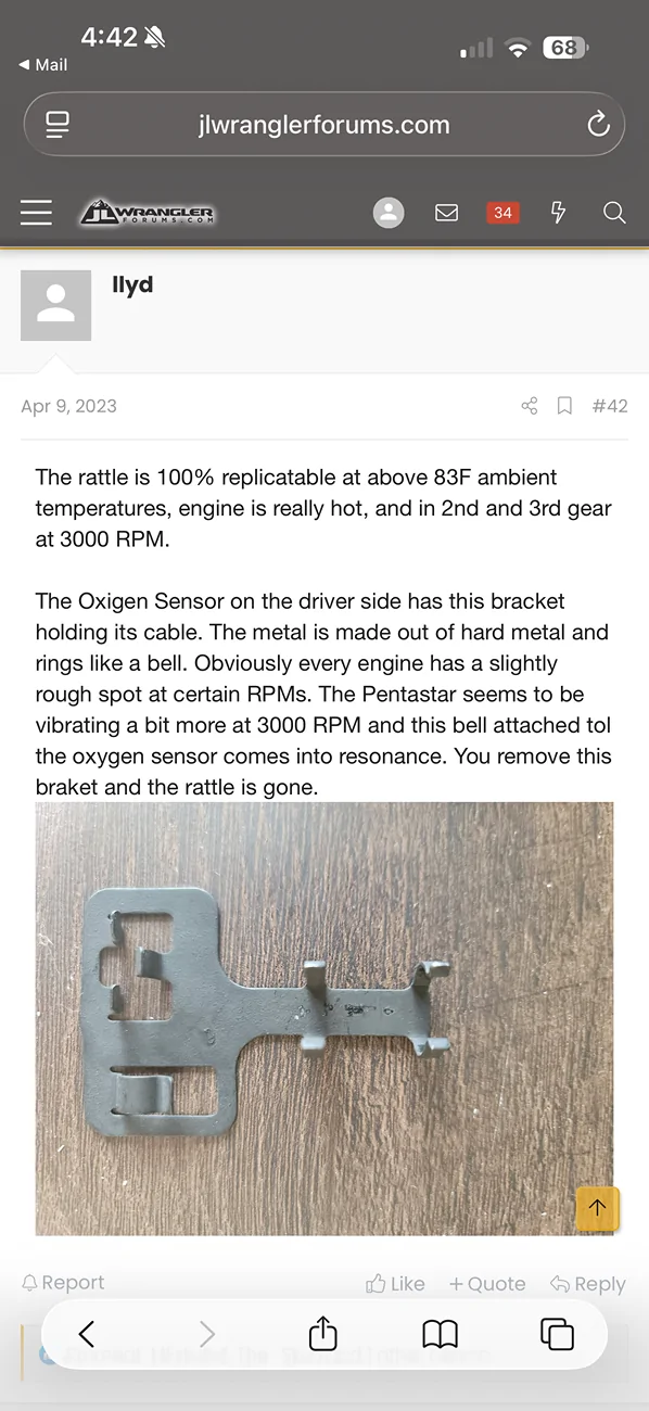

https://www.jlwranglerforums.com/fo...rattling-noise-with-acceleration.80407/page-3
this is the most commented one and here is the suspected o2 bracket culprit … all the talks are ultimately dead ends
I see it now, there is definitely some play on it. I am going to put some high temp tape/foam on it and see if that fixes it!
The only thing is, mine goes away once I push on the clutch pedal (an inch) and will come back when im off of it, which I don't think would be that bracket, but maybe!

I zip tied the 02 sensor bracket tight to the driving column for a quick straight way. It still made the noise. but there is some play in that 02 sensor so I would imagine it is a problem for some people. just not mine.
