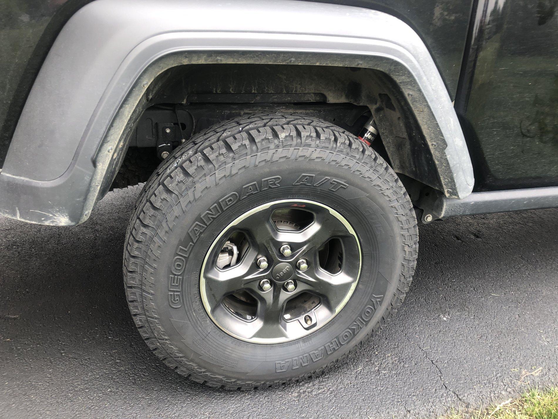

Love my old general grabber at2’s
they will fit fine on stock rims
I’m running Yokohama geolander at g015 at 285/75/17 and getting 19-21 mpg. Running them with a 2in spacer lift they loom proportional to the truck and don’t cause gear searching like 35/37 do. Feel and sound like stock tires but handle great on the sand.

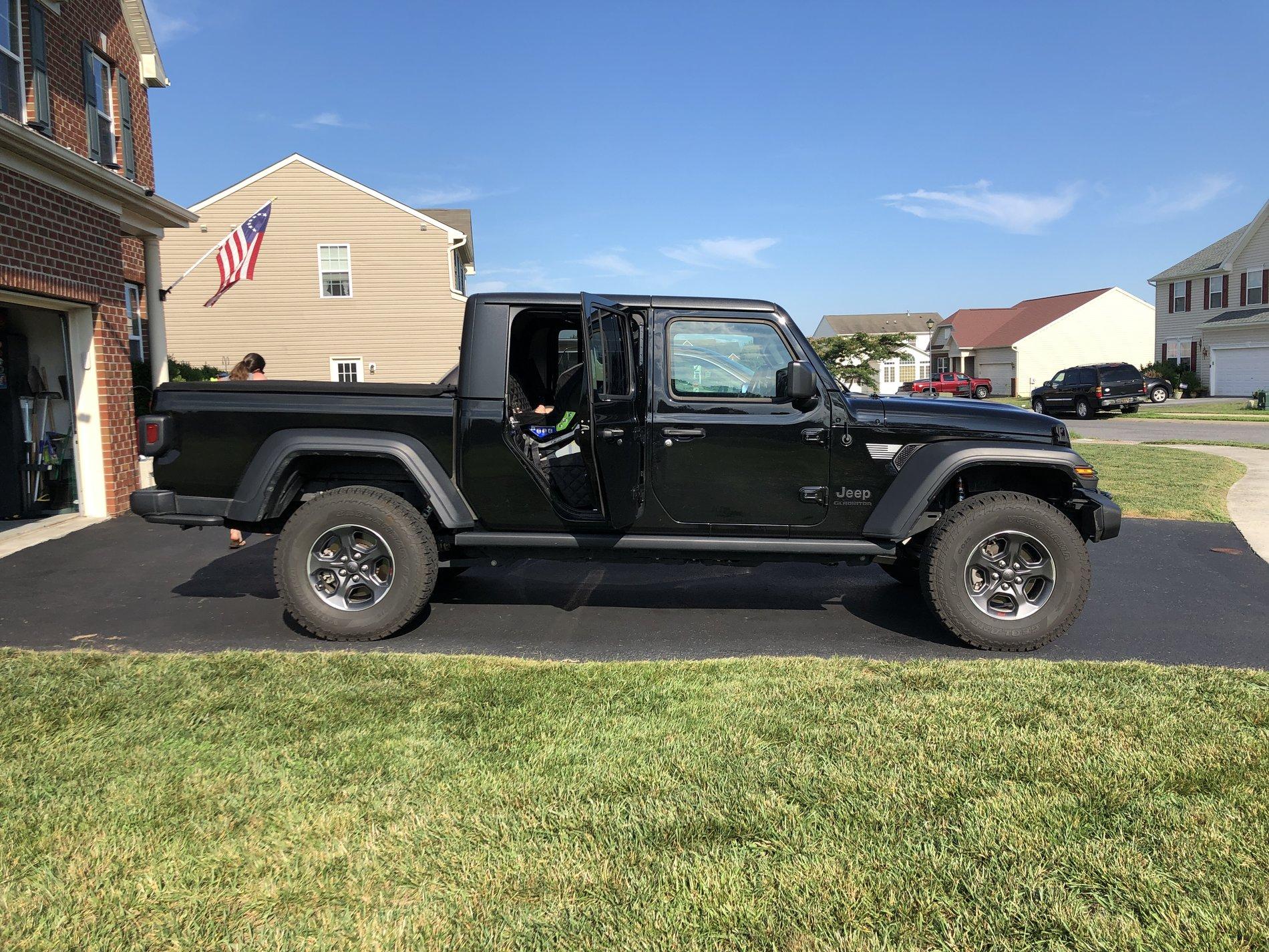

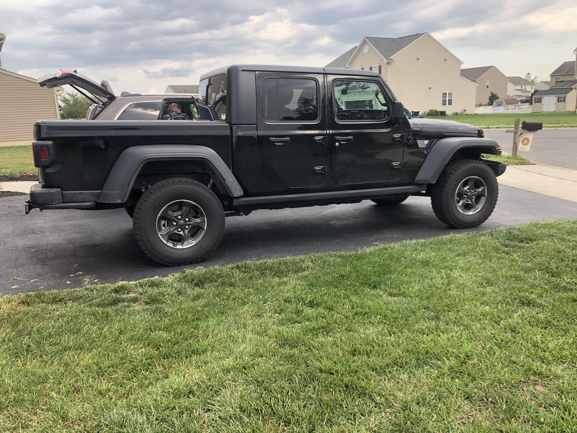

i like that. Can you post a side profile photo?

After install
2in lift front/rear
2.5in front / 2in rear
That looks dope. I think I’ll have to do a 2.5 or 3.5 and 33s. Just have to see which is going to be better for some Wheeling.

mine are 285/75/17 which is 33.8 un mounted. If you go 285/70 theyll look small Since they’re 32.7 un mounted. Theyll shrink to 32(ish) once on with the trucks weight.
