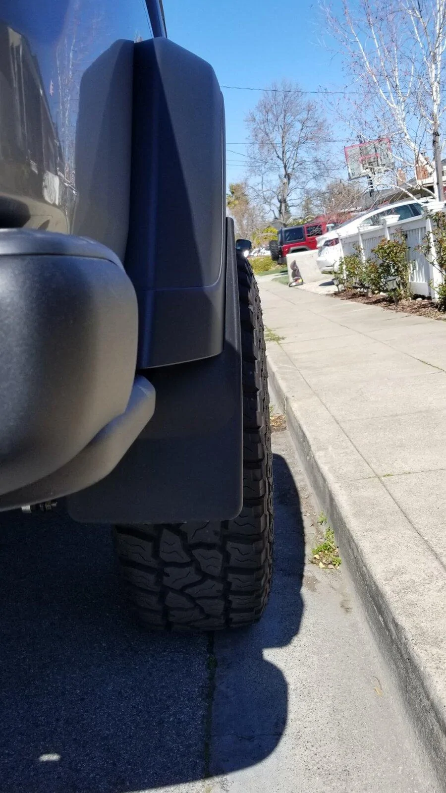

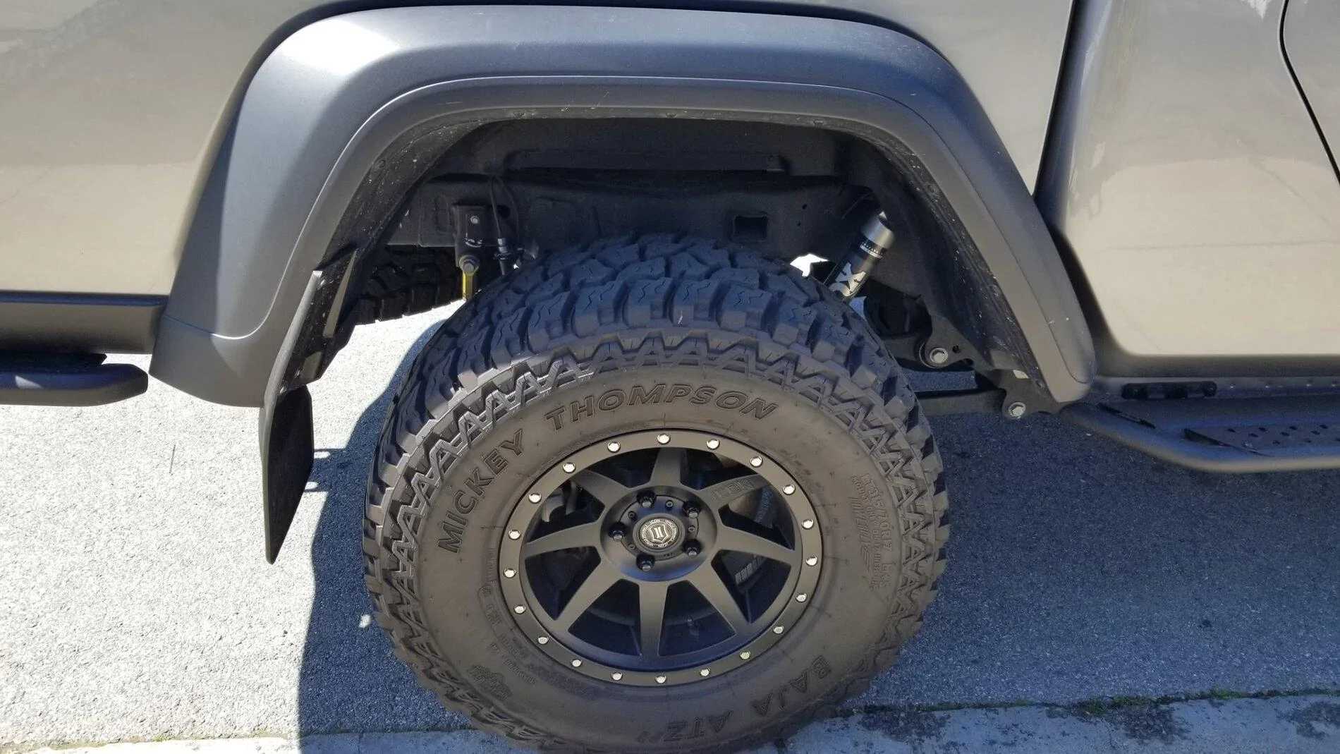

I have the Icon Rebound with a 4.5" backspacing and the TPMS system always shows an error.
I've taken it to the dealer 3 times and they changed out the sensor module and the TPMS sensors in the wheels and they say that this is due to the wheel being too far out of the fender so the module has trouble reading the sensors.
You can keep resetting it and it will be fine from anywhere from 20min to 2 days and then the TPMS warning pops up.
Has anyone else had this issue?
Wheel for reference - Rebound / Satin Black - Icon Alloys - Icon Vehicle Dynamics
Tires - Mickey Thomson ATZ P3 - 315/70/R17
I've disabled the TPMS system via Flashcal for now.

Shouldn't be an issue and your wheel is barely out of the fender I think mine is about the same and no issues at all. I would find another dealer
