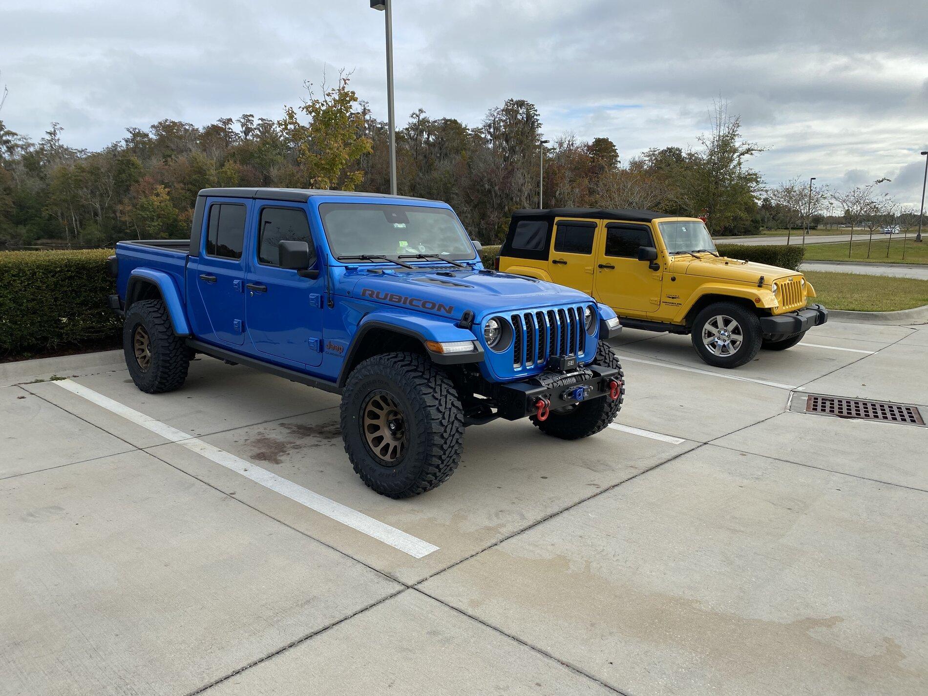

Just got these put on and currently have no lift. I have a 2.5" Icon Stage 4 lift back ordered until the beginning of January that will also be put on when it arrives. It was a hard decision, but decided to put 37s on the next list as I want to regear and do it properly as this a daily driver. I got these as a package from CarID and love how they look with the Hydro Blue. The only issue is they came with (PDQ I think) programmable TPMS sensors and they all read accurately and reflect changes in tire pressure, but the light won't go out. I have almost 500 miles of letting them self learn and most of it is 75MPH. Is anyone else having this issue? I have tried every combo of pressure and setting the TPMS warning pressure with the Tazer Mini. I have tried driving it with the pressure matching the setting as well as 2/4/6/8 pounds over and had a good 30 mile drive each time. I really don't want to pay to have the factory ones swapped in and these swapped to the factory wheels as I am selling them and not trying to put the buyer in the same situation. I saw in another post someone mentioned maybe they are different if you have the selectable tire fill alert? Any tips or pointers would be appreciated. I also had discount tire read them with the tool and they all showed the pressure and all checked out good.
