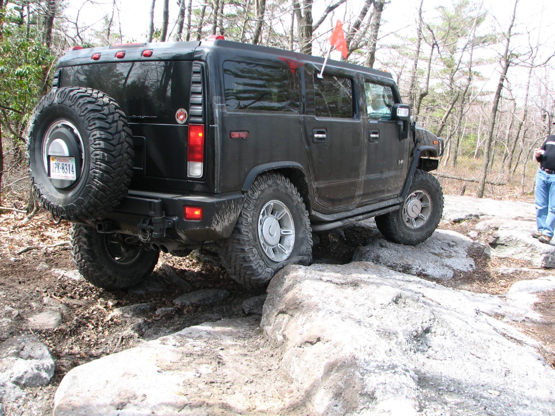

I'm just saying, for example, you can do this https://www.youtube.com/watch?v=5zZMOt4_W6k with 33"-37" tires on 17" wheels. If you tried it with 33" tires on 20" wheels, I think you would damage the wheels. Stock F150 Super Crews wouldn't make it through that type terrain because of limited clearance and wheel articulation. So, there's not much of an issue with going with 20" wheels on them.

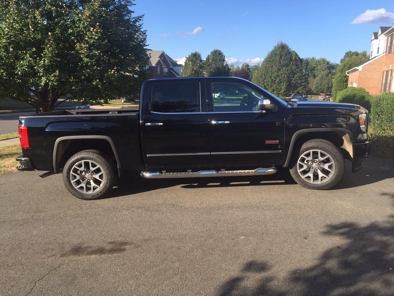

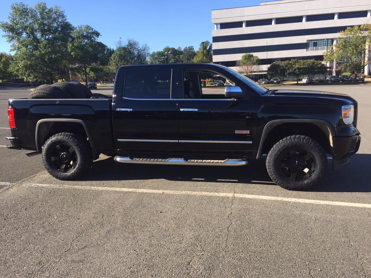

That being said, when I bought a 2015 GMC Sierra CC, it came with 20" wheels BECAUSE I got the All-Terrain package with skids, rear locker, etc. ..., which is absurd. The first thing I did was take them off and sell them.
I actually got a decent price for them because some people like that sort of thing on trucks.

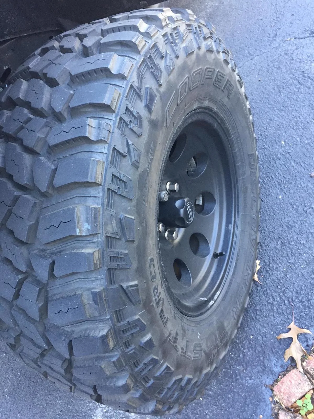

EDIT: For example, these are just 35s on 17"x9" wheels, and you can see how much tire there is there (9") protecting the wheels and the bead.
These can take A LOT more abuse than could that setup on the first Sierra pic.
I think if you tried this with a 20" wheel on anything less than 37s, you could not do this without damaging the rim:
