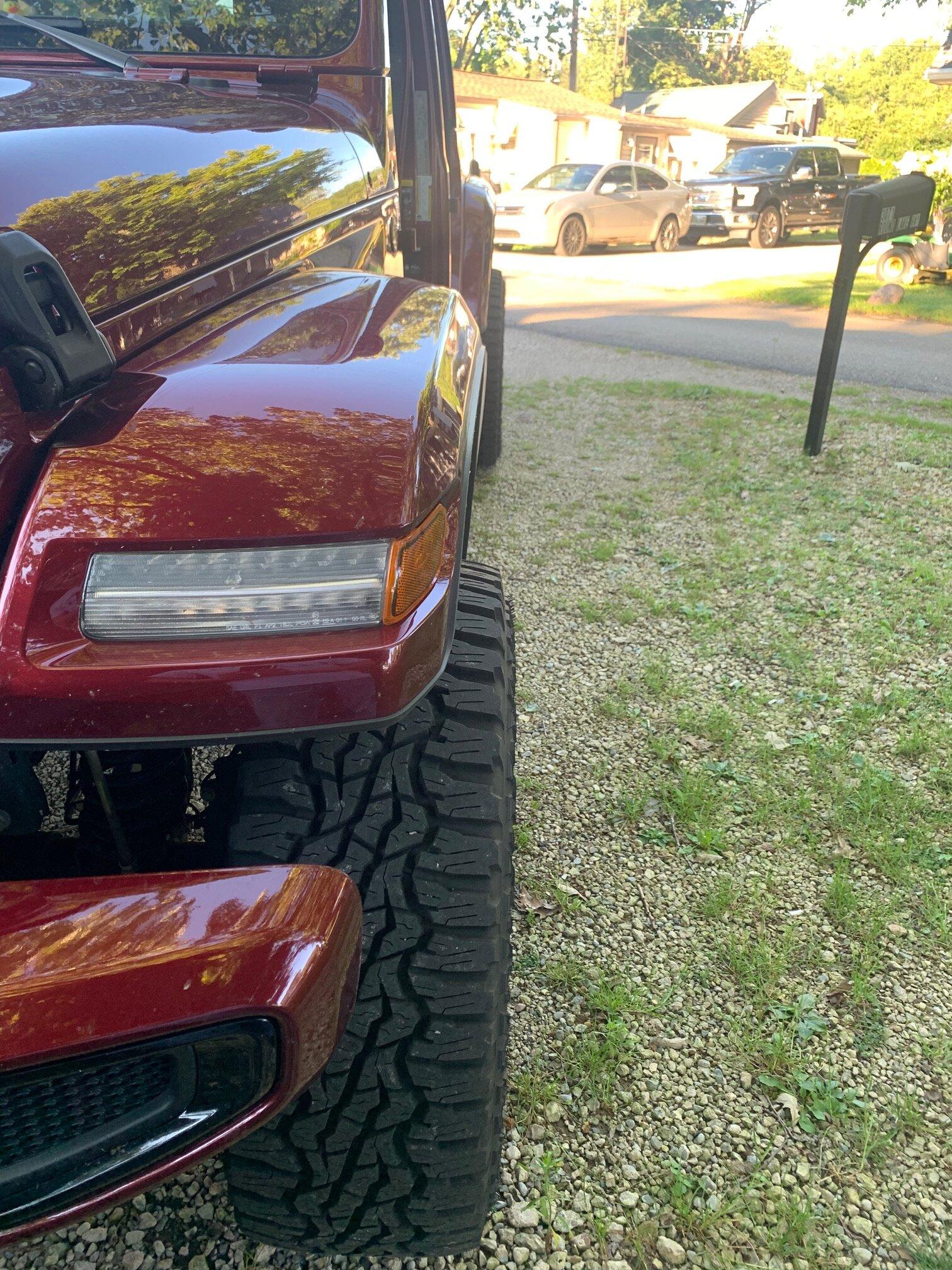

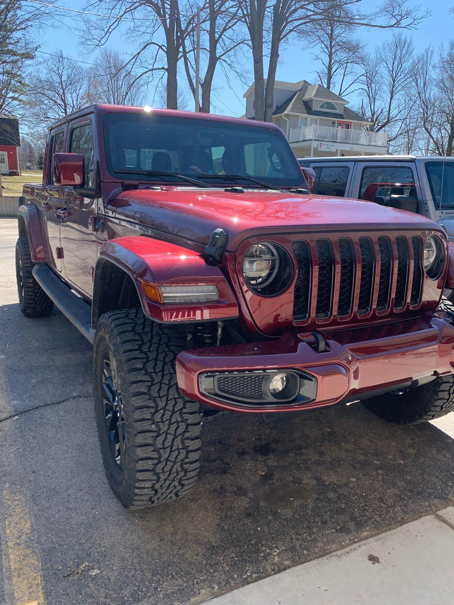

35x12.50
Stock 20x8 wide wheels
1.5" wheel spacers
Wide axles
What I am running is equivalent to an 8" wide wheel with +6mm offset.
