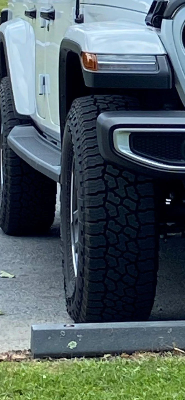

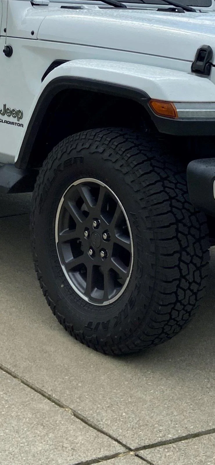

I have 35's on stock ( 18x7.5 ) Overland wheels. 285/75/18 are actually 35x11.50.
Jeep Gladiator Anyone have 18x9.5 -18 or +0 offset wheels on 35” tires? tir
Jeep Gladiator Anyone have 18x9.5 -18 or +0 offset wheels on 35” tires? tire2

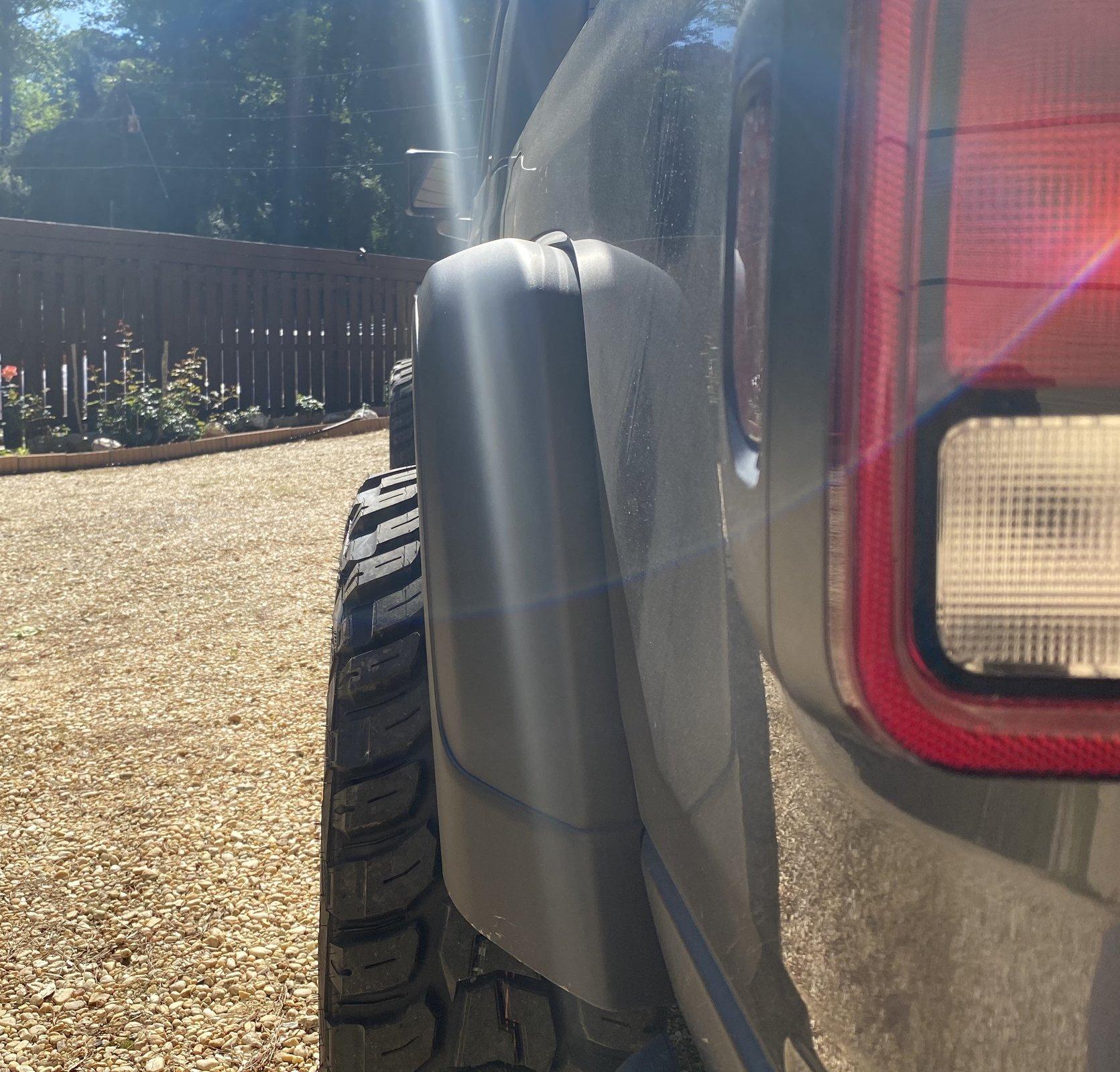

17x9 with -12 offset
35x12.5 tires
1-1.5 inches outside fenders
Obviously the -18 will sit out further and the 0 will sit inside further.

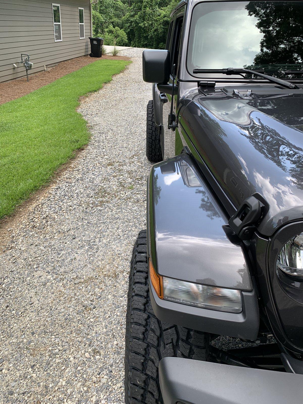

Lake Martin, Alabama
Rubicon with 37x13.50 on 20x10 with 4.56" BS, and -24mm offset
Jeep Gladiator Anyone have 18x9.5 -18 or +0 offset wheels on 35” tires? IMG_1103
