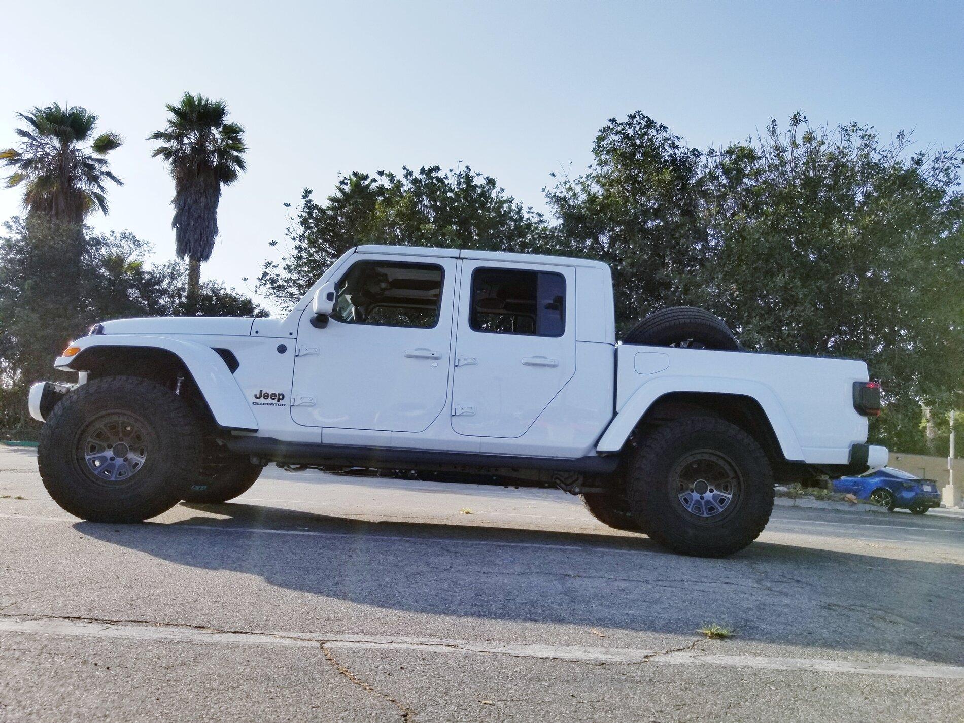

285 70 17 BFG KO2 3.73 gears. Black Rhino Wheels and 3/4" front level. I think I will stay with this setup for awhile.
They look amazing but stick out quite a bit which is a no no in NH. Big backspacing?
yeah the Black Rhino wheels are 4.56 backspace . The white wheels from Quadratec were not in stock but those had more backspace. As I understand , less backspace will push the tires out. So you would want something with more backspace , closer to OEM rims which are 6.25 backspace.
There are probably other white wheel options with something closer to your liking.
Thank you for the explanation...I do like yours looks they just wouldn't be legal here in the "Live Free or Die" state. lol.

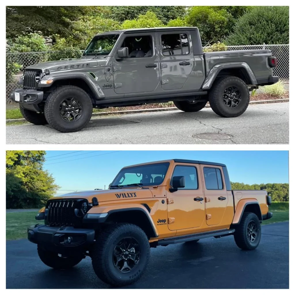

That size in Falken Wildpeaks Is what I have on my 80AE. On the tire, they are labeled as 34x11.5. Oddly enough, they are taller mounted than the 315/70R17 on my daughters JKU.
As for the gearing issue, the 8 speed auto picks up a lot of the slack when it comes to gearing.
For a comparison, the wife’s 20 Willys JLU came factory with 255/75R17 and 3.45 gears. It drives perfectly.
My JT was equipped with 255/70R18 and the 3.73 gear. Swapping to the 295/70R18 changed my effective gear ratio to 3.49, which is still a bigger gear than hers has from the factory. After recalibration with Jscan, I have zero drivability issues. I still see 8th gear on the highway.
I have the same color JT and was wondering what it would look like on bigger tires. Good looking rig.
