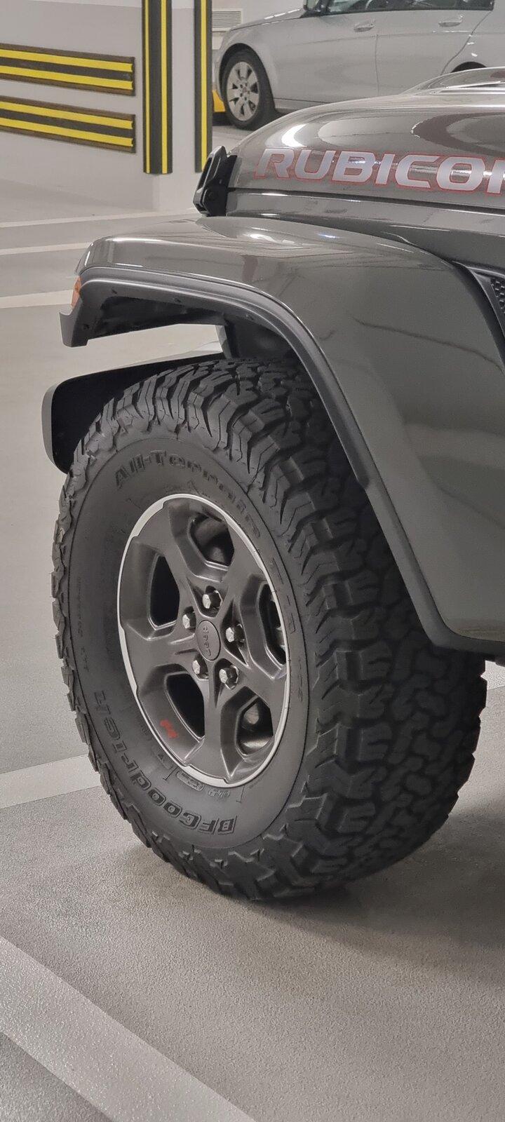

Anyone have any issues with 35's and the 4.10 gears that come in a Rubicon?
Running BFG 315/70/17 which I think come in about 34". Not heavy at 63lbs. tazered and drives as it did on the original 32" tyres.

Yeah but the Ruby doesn't run 3:73 gears, that's a great tire!
I run the same, after running Rubi takeoffs on my overland for 1000ish miles. 315/70 K02 weighs a pound less, and I haven’t noticed much of a difference in daily drivability. I wasn’t hitting eighth going up to the mountains on the stock duelers or the falkens anyways ¯\_(ツ)_/¯

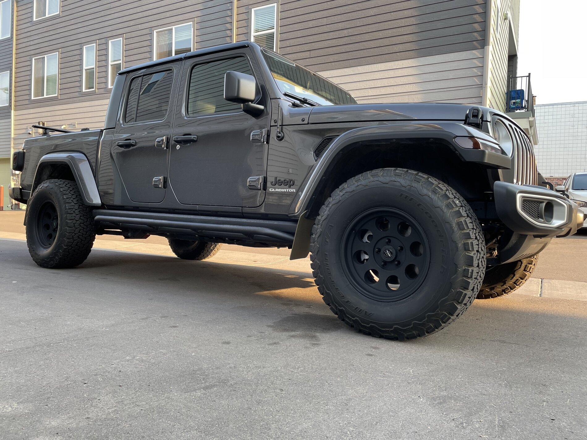

johnparjr
Sep 5, 2020
36
1,174
1,400
New Caney, TX
2020 Jeep Gladiator Mojave
I have a Mojave came with 33’s and I switched to 35’s and my gas mileage tanked so for me I’ll go back to 33 when these wear out

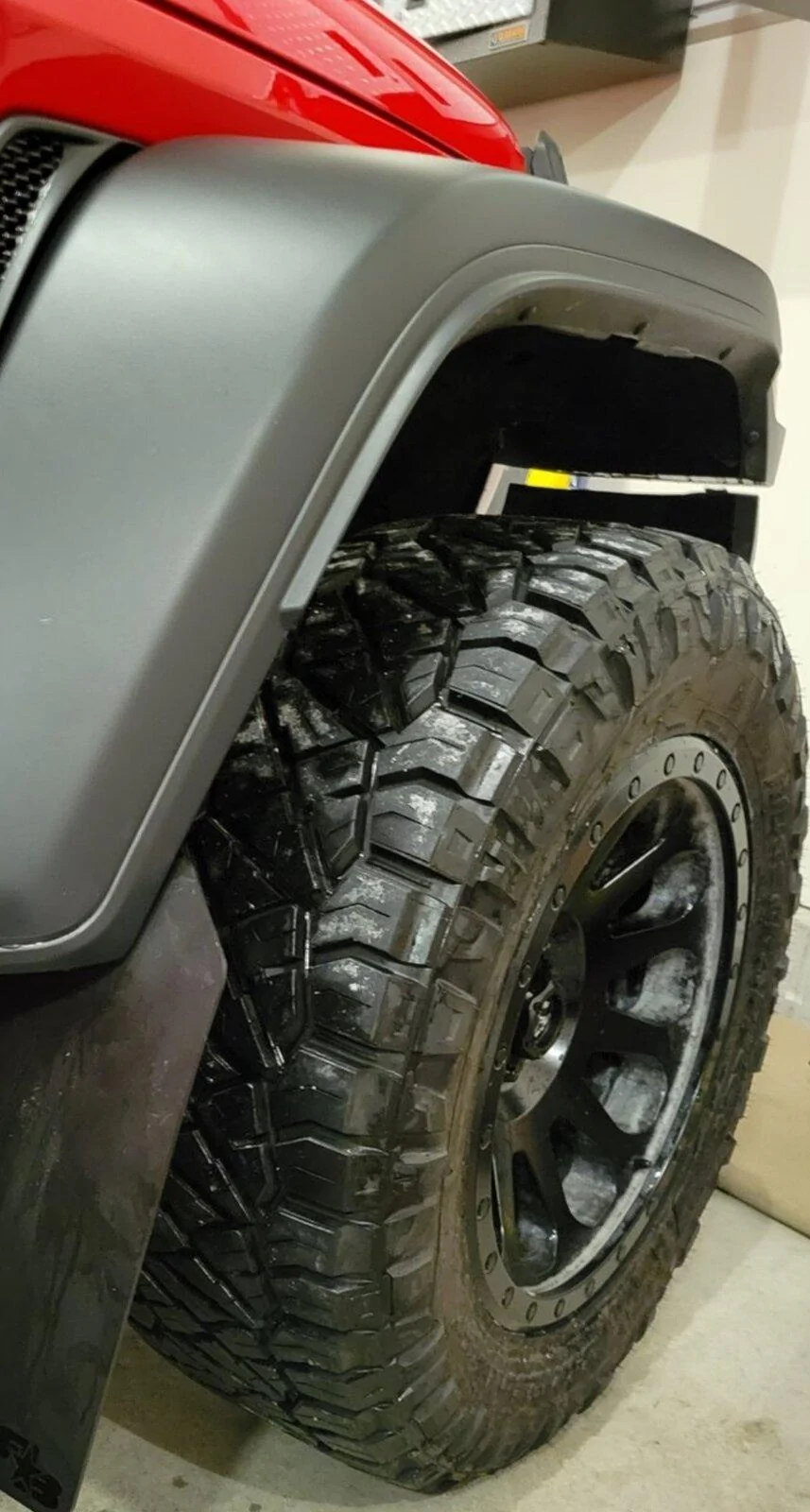

Rares
Rares
Dec 6, 2020
Kansas City
2020 Jeep Gladiator
You'll regret not getting 35's. I got the Ridge Grappler with 3.73 gears. I lost 2 MPG's and no problems keeping 8th gear on flat ground. If you have alot of hills or if you tow alot then re-gear or stay with factory tires. The difference in weight between 33's and 35's is not that big.
