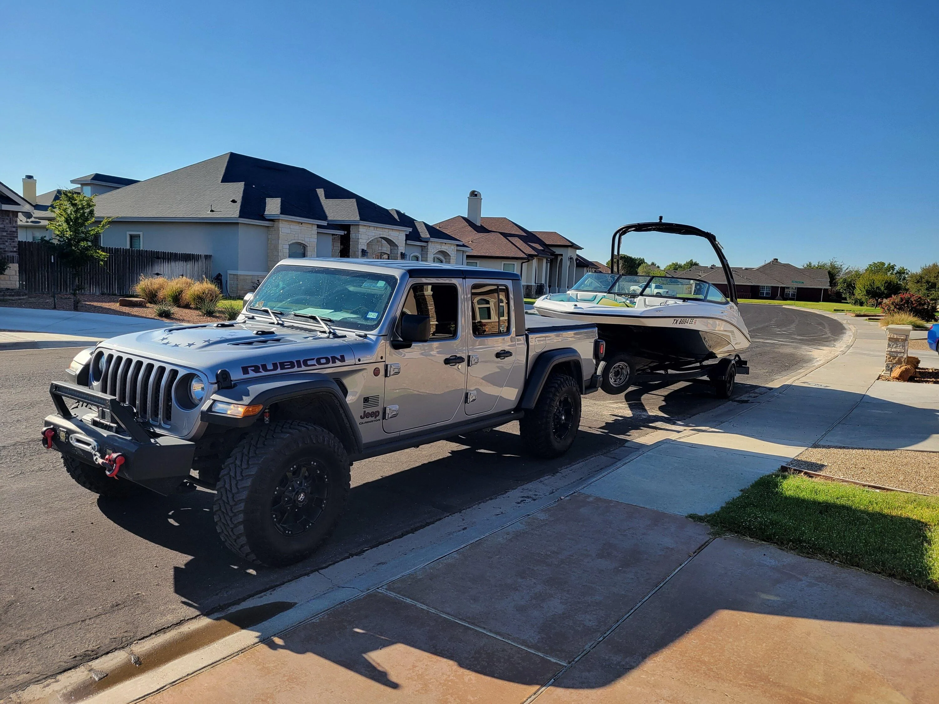

I have 35 x 12.5 x 16 atturro m/t. I still get 22 on the highway at 80. 20 in town. I get 14.5 pulling my boat. I have a diesel so the torque makes the difference unnoticeable. The atturro tires were not my choice. I used run grabber x3s. But these came with the vehicle. I will say that after 6k miles I love the tires. They are very balanced and smooth. They have a little wine at highway speeds but nothing the radio doesn't cancel out. They have been smoother and better balanced than any mud terrain I have ever ran. You might give them a look as they are more affordable .

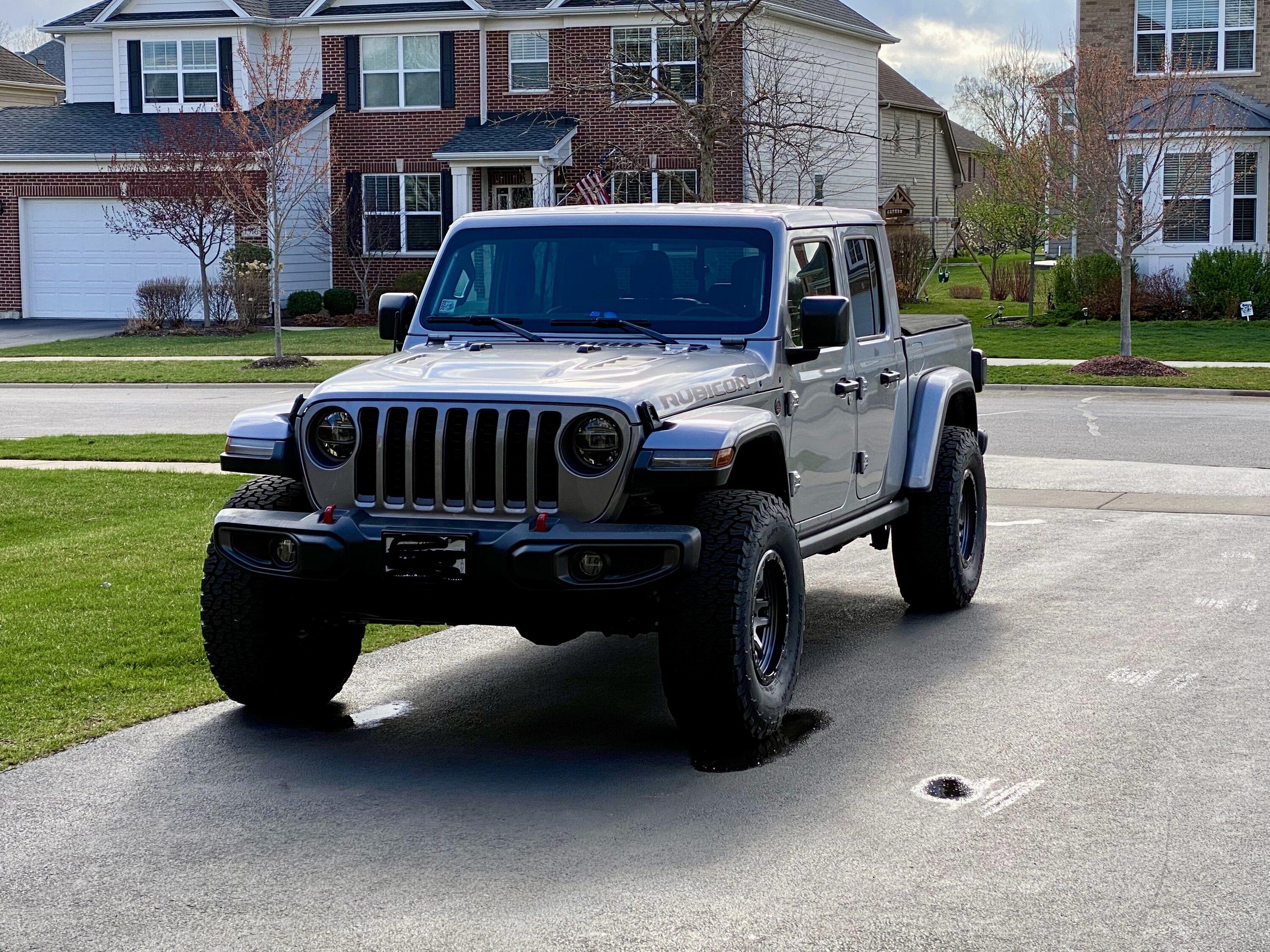

I replaced the stock 33" on my Rubicon with 35" KO2s, I also went with a slightly wider 17" rim. No issues moving up a size on the Rubicon, the speedo is off 3-5mph depending on speed so will update that eventually. The only thing I would reconsider if I did this again was to look at
Jeep Gladiator Stock 33’s vs 35’s Pros and Cons DC187170-D260-4665-ACA8-B5E71EA3747F_1_201_a
an 18" rim for slightly better on road handling.

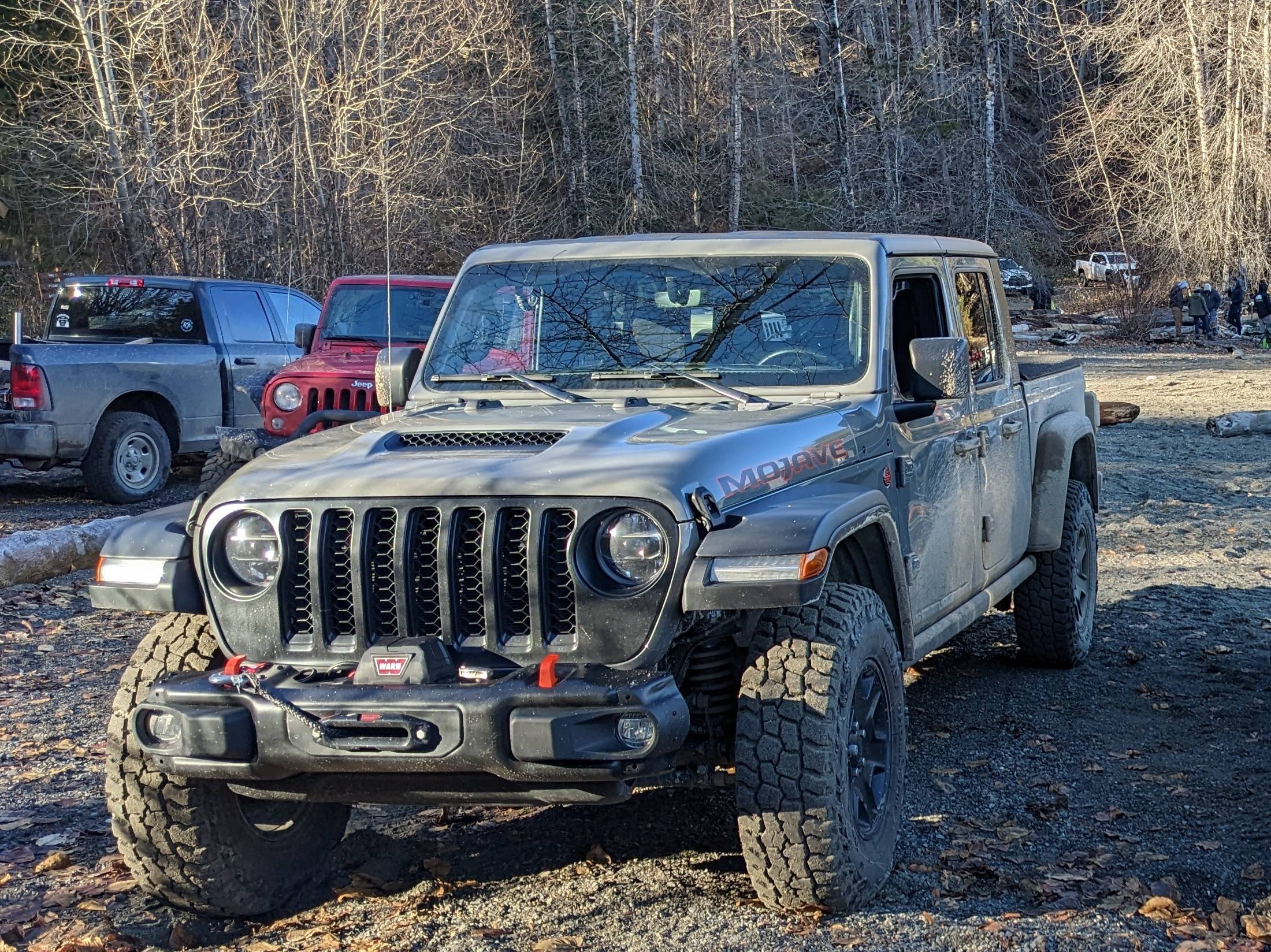

Another option for a 35 inch tire is the Mickey Thompson Baja Boss AT 255/85r17. If you like the wide tire look, it isn't for you, but it has advantages.
There was a slight power loss going to the larger diameter tire, but not much. I used Jscan to adjust the speedometer.
The weight is lower than any other 35 inch tire I could find, even as an E rated tire.
The handling is better. Especially in rain and dry.
No rubbing.
Fits on stock rims without issue.
Adds an inch increase to clearance. Doesn't seem like much but I noticed a difference on trails I ran with the 33' tires.
I got slightly better fuel economy with the Wildpeak AT's. The increased off road ability offset this for me.

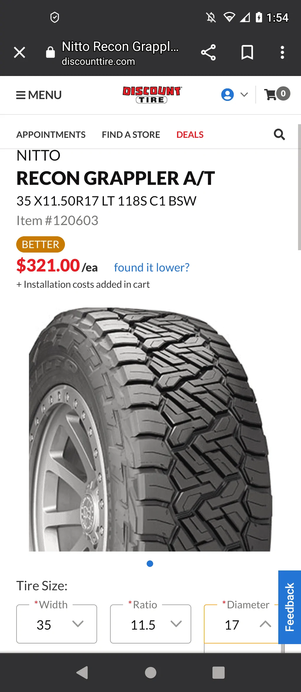

Which metric tire is closest to a 35/11.50/17? @Discount Tire
Also it shows on your website I can order a 35/11.50/17 in C1 rating in a Nitto Recon Grappler if you punch it in on the website
https://www.discounttire.com/buy-tires/nitto-recon-grappler-a-t
In 17-inch metric, there really isn't a flotation equivalent. 285/75R-17 or 305/70R-17 would be the closest.
On a side note, I looked into availability for the 35x11.50R-17 Recon Grappler, and unfortunately this tire is sold out and on back order. For some reason our site is showing this model available and it's not. The Ridge Grappler and Trail Grappler are available in this size, however.

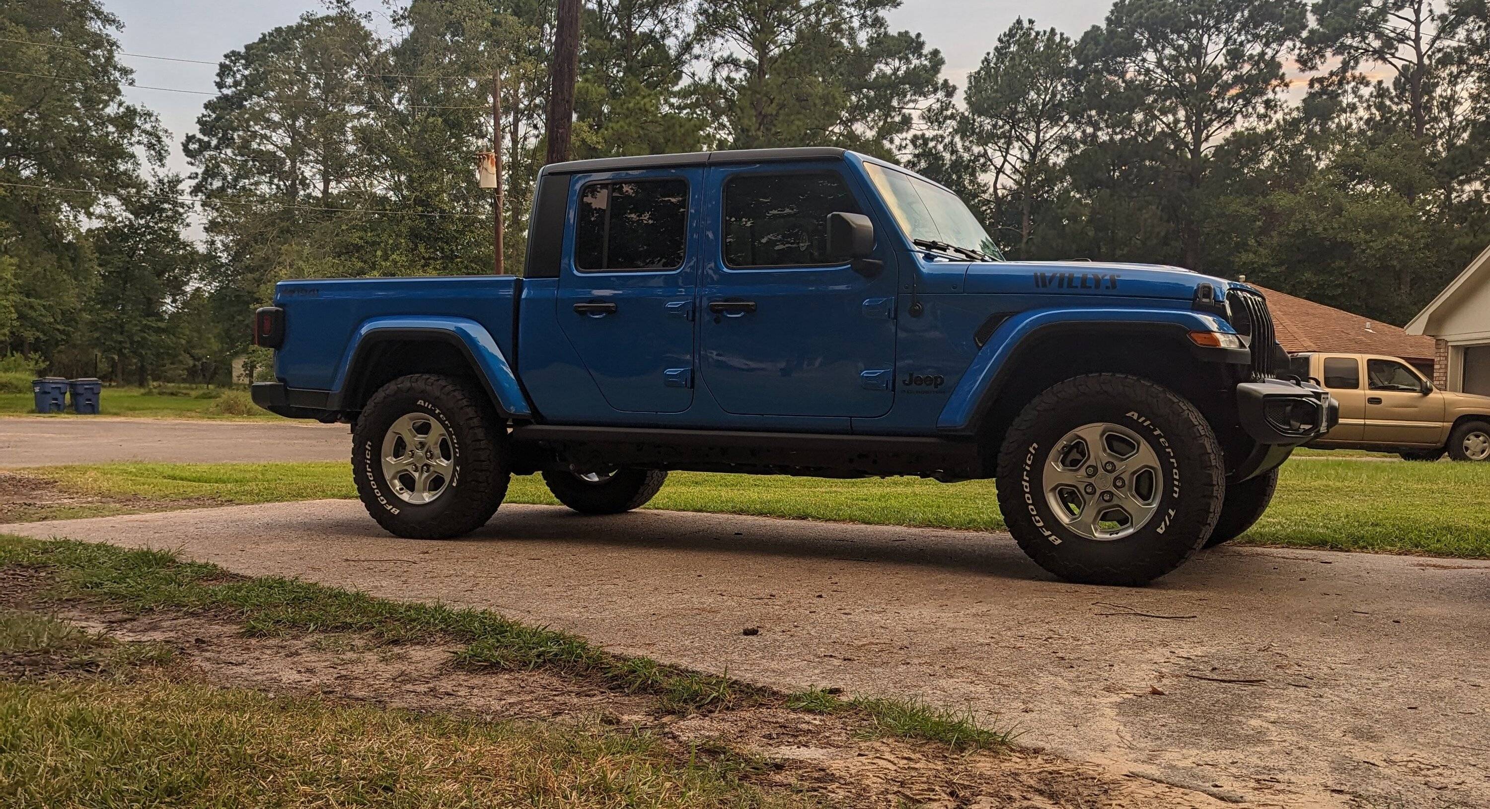

I went with BFG KO2's in a 35x12.5x17. Cons are speedo will be off a little and with 3:73 gears it falls out of 8th gear more. Pros are looks much better and makes the truck look more proportional. Still has plenty of power on take off and to haul stuff.
