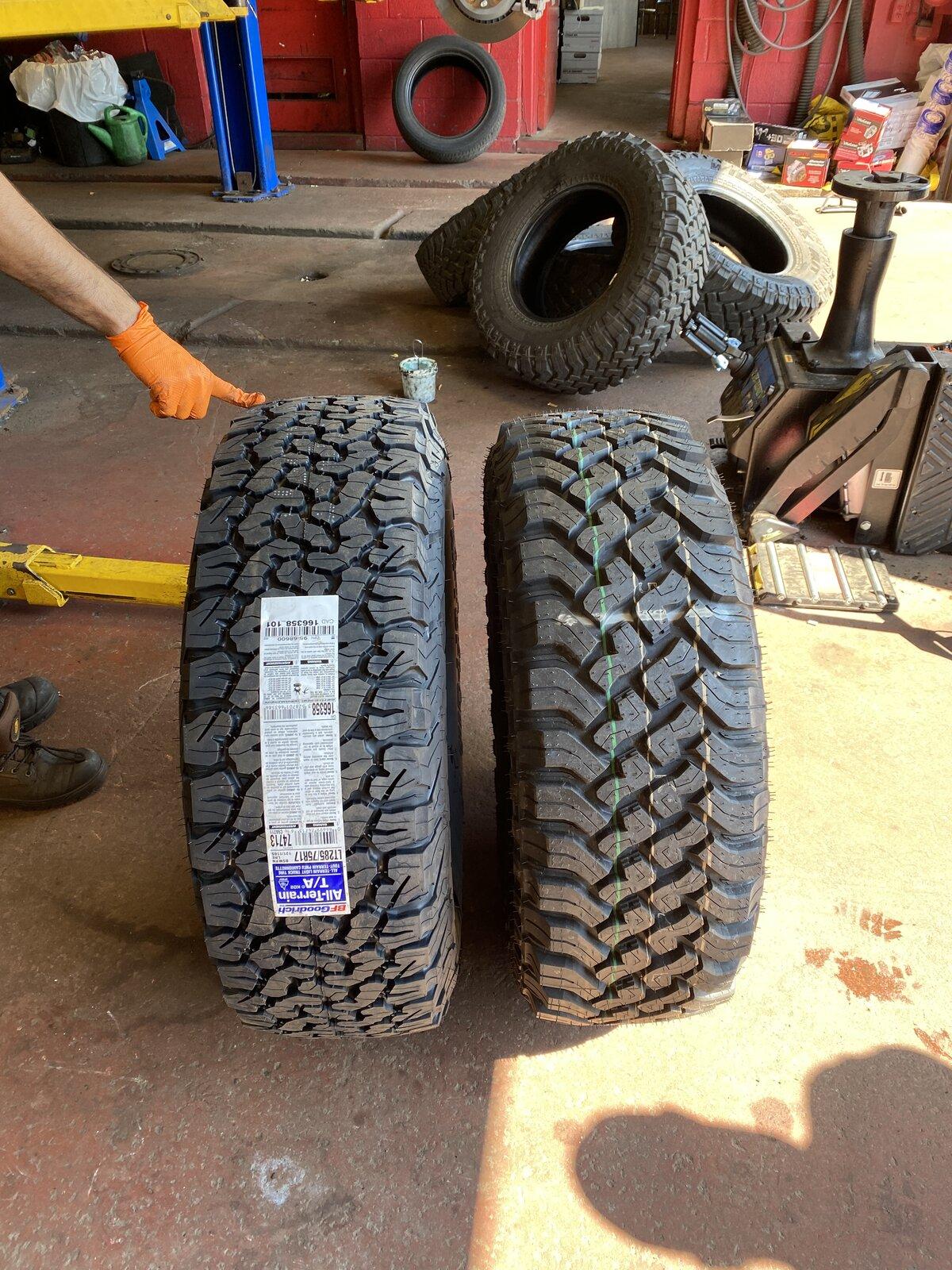

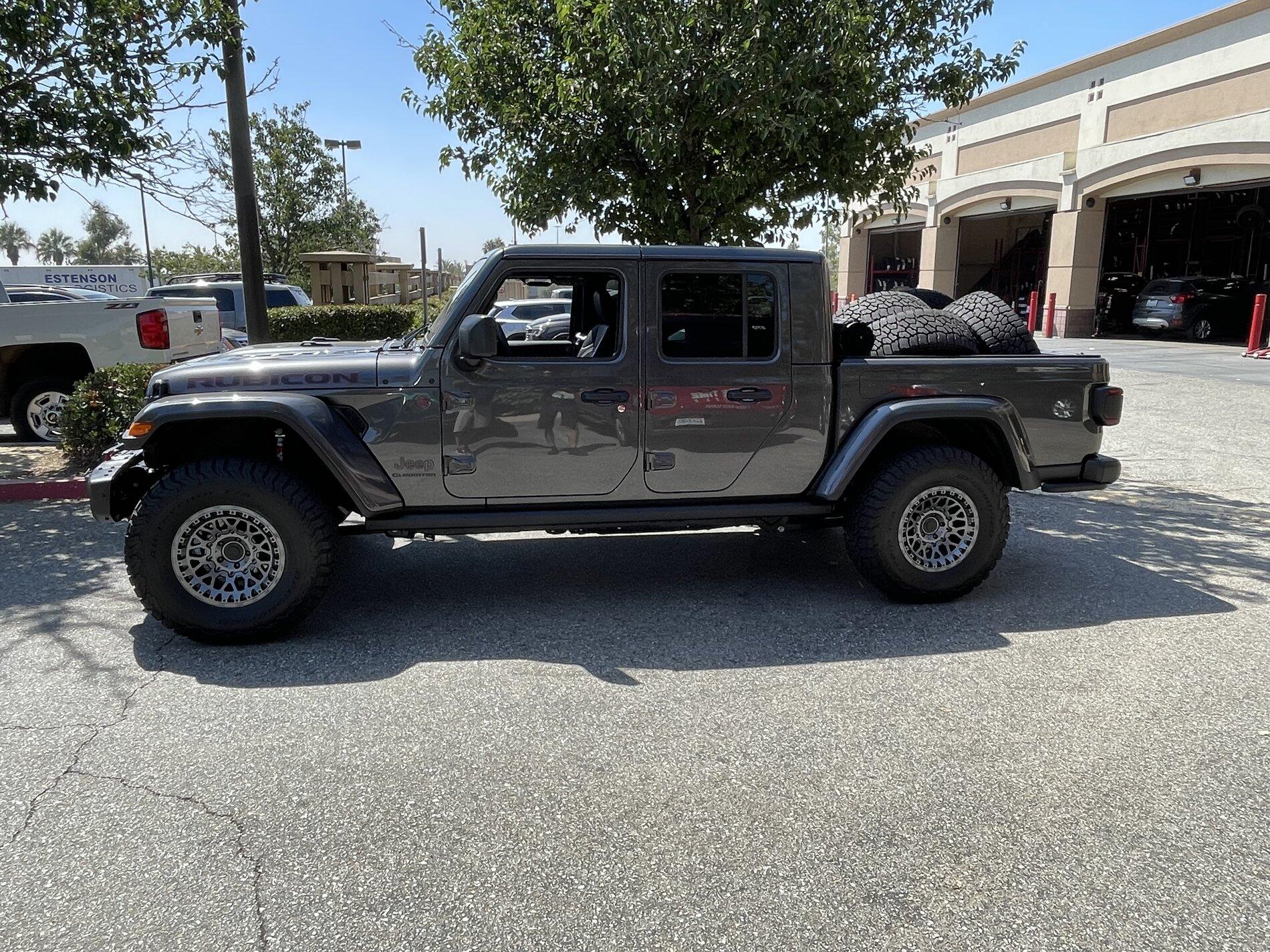

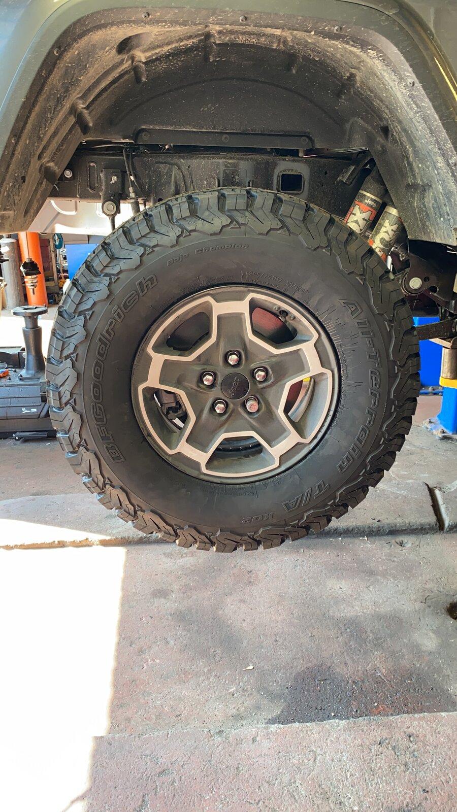

I have a Mojave so 4.10 with 285/70/R17 from factory, upgraded to 285/75/R17 because i changed from the MT tires it came with ( Falken Wildpeaks) to Bf Goodrich Ko2’s .. Tire is a bit bigger, looks like a narrow 34, but its lighter than the stock one, so at the end I lost 2% in mpg’s but the truck drives exactly or even better than Oem.

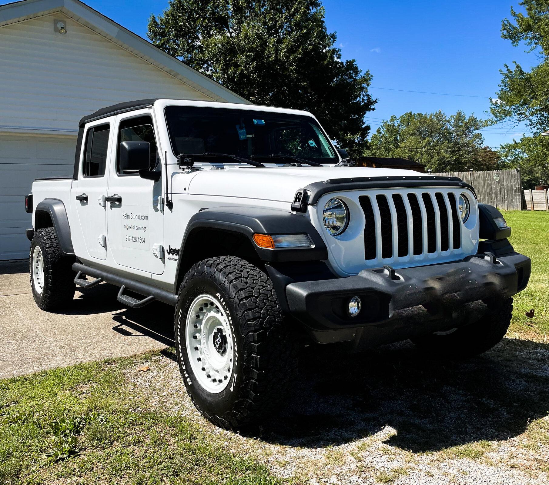

So I have a Sport, 1.5 Tereflex front level. New 17x9 wheels. 4.53 backset. -12mm offset. Want to buy tires this week and read a lot of different things. Are 35x12.5 17 pushing it with the 3:73 gears etc? Looking for best option so I'm torn between 315/70/17. 33x12.5 17. 35x12.5 17. Looking for the experience of others to help with this so I don't regret my pick. Appreciate anyone's opinion!
Go with the 35’s. I have them on my 21 diesel and love them

I just went through the same dilemma: 33, 35 or 37???? What will I be happy with??
I took a leap and picked the 35's. I am extremely happy with my choice. I did loose some off the line performance and a little drop in MPG (measured). I expected that but it is minor.
My rig is a '21 Gladiator with the 3.0 diesel. Other than wheels and tires it is stock. I do plan on a 1.5"-2" lift at some point but so far, they fit perfect. No rubbing at all with the driving I have done in town and on some mild trails. I expect that I will need the lift when I start doing some more serious wheelin'.
If your power train is stock I don't think that I would go larger than a 35.
