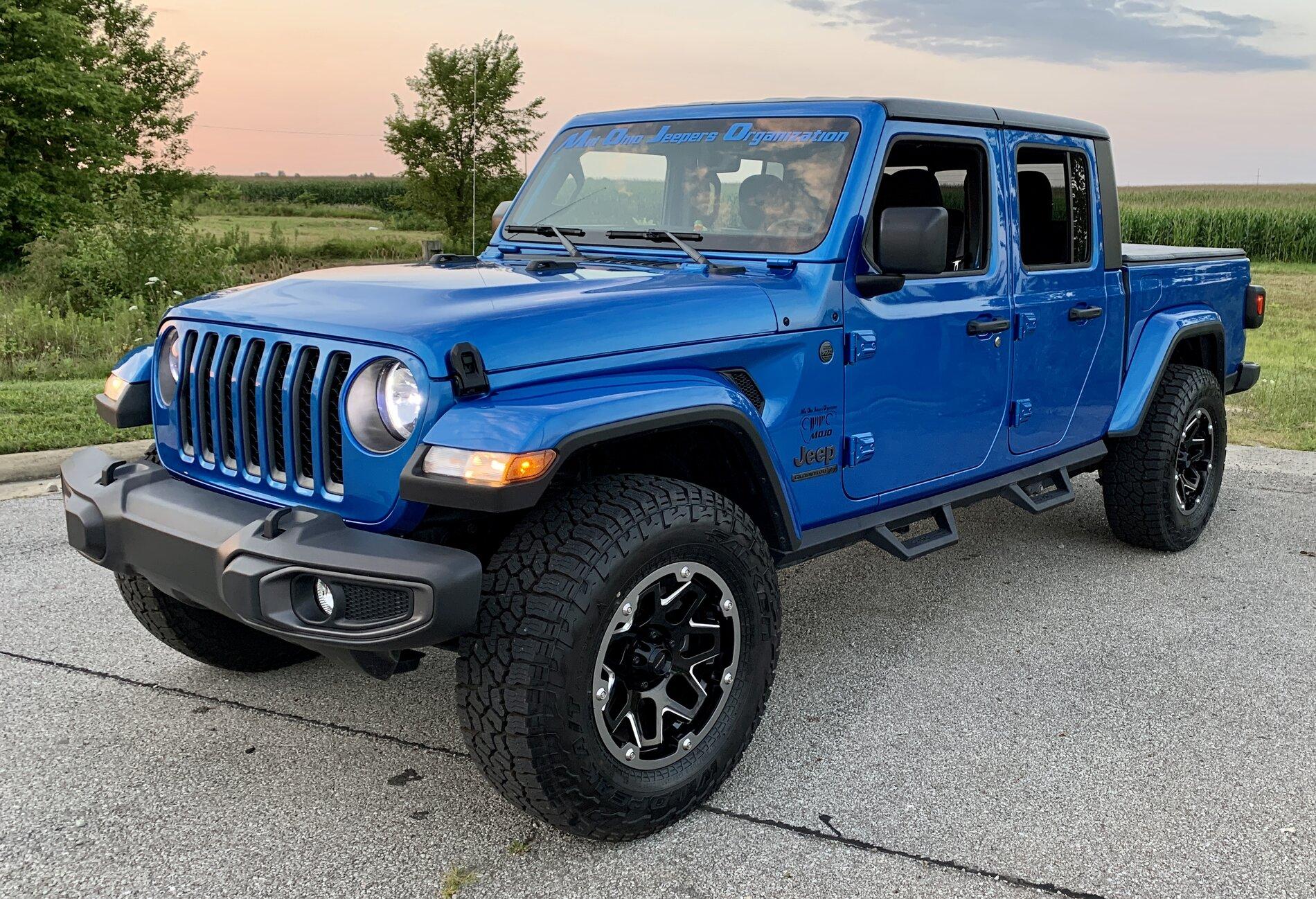

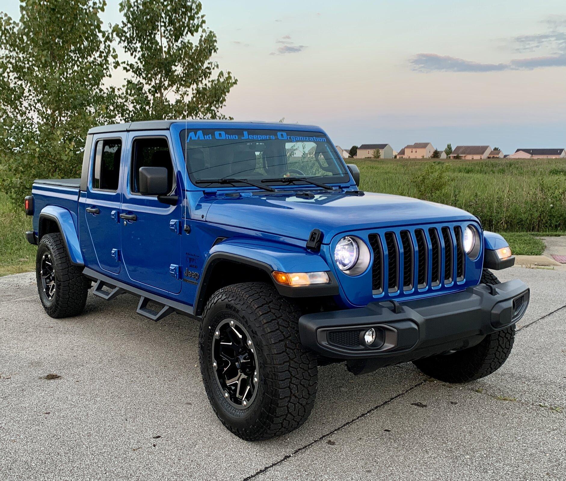

I’m getting an Overland and pondering 295/70/18s, which are essentially a 34 inch tire. Hoping that isn’t too aggressive for the stock 3.73 gearing.
jjdustr340
Jason
Nov 5, 2020
458
825
Ohio
2023 Gladiator Mojave
Crime fighter.
That size in Falken Wildpeaks Is what I have on my 80AE. On the tire, they are labeled as 34x11.5. Oddly enough, they are taller mounted than the 315/70R17 on my daughters JKU.
As for the gearing issue, the 8 speed auto picks up a lot of the slack when it comes to gearing.
For a comparison, the wife’s 20 Willys JLU came factory with 255/75R17 and 3.45 gears. It drives perfectly.
My JT was equipped with 255/70R18 and the 3.73 gear. Swapping to the 295/70R18 changed my effective gear ratio to 3.49, which is still a bigger gear than hers has from the factory. After recalibration with Jscan, I have zero drivability issues. I still see 8th gear on the highway.
