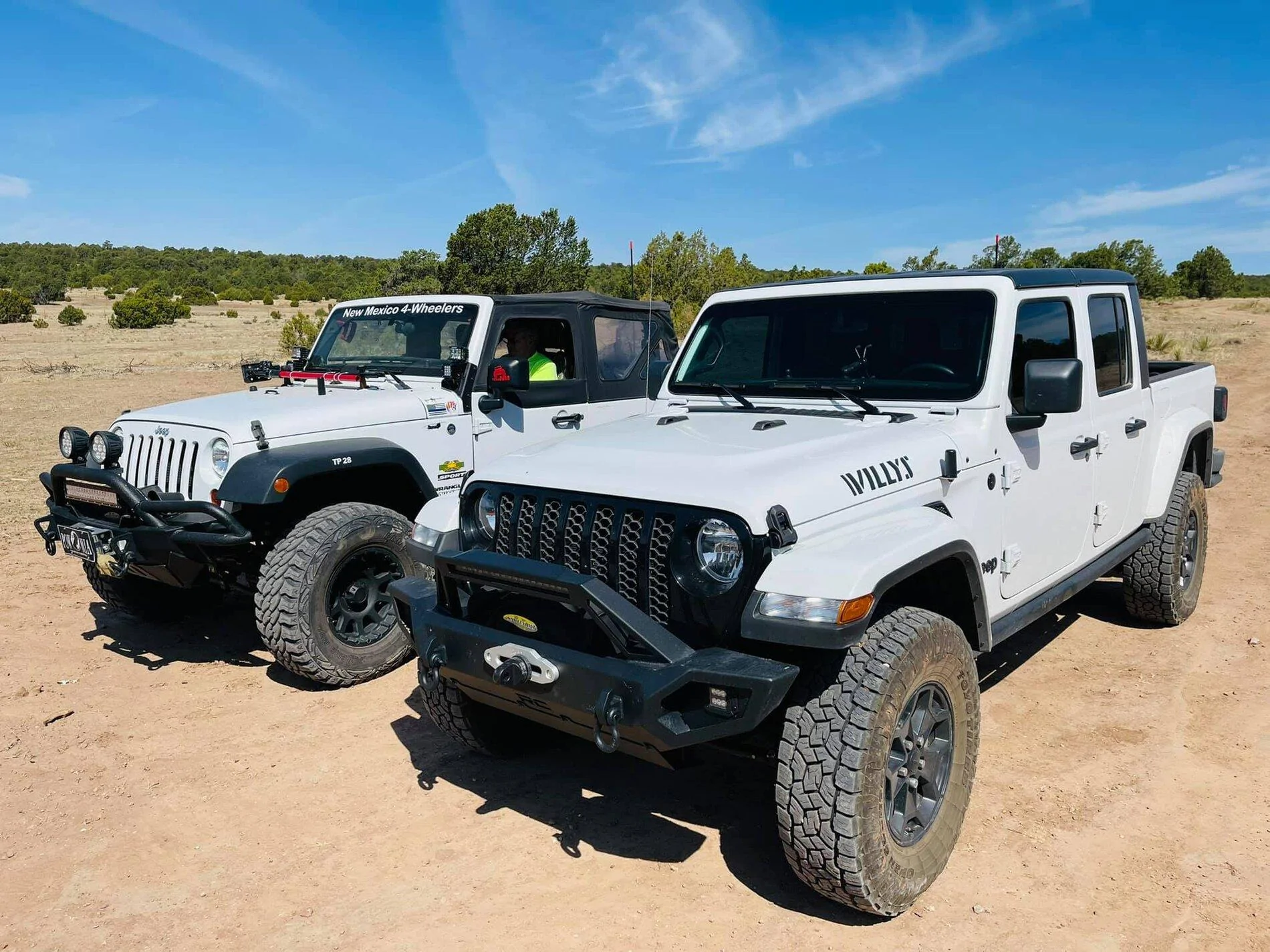

I run a 35x11.5x17 Toyo AT3 on stock rims and 2" Mopar lift. No issues, no rubbing. Barely stick out past the fenders.
Jeep Gladiator Anyone running 35s on stock wheels without issues? 195052648_824002185212880_6805821344078840941_n
