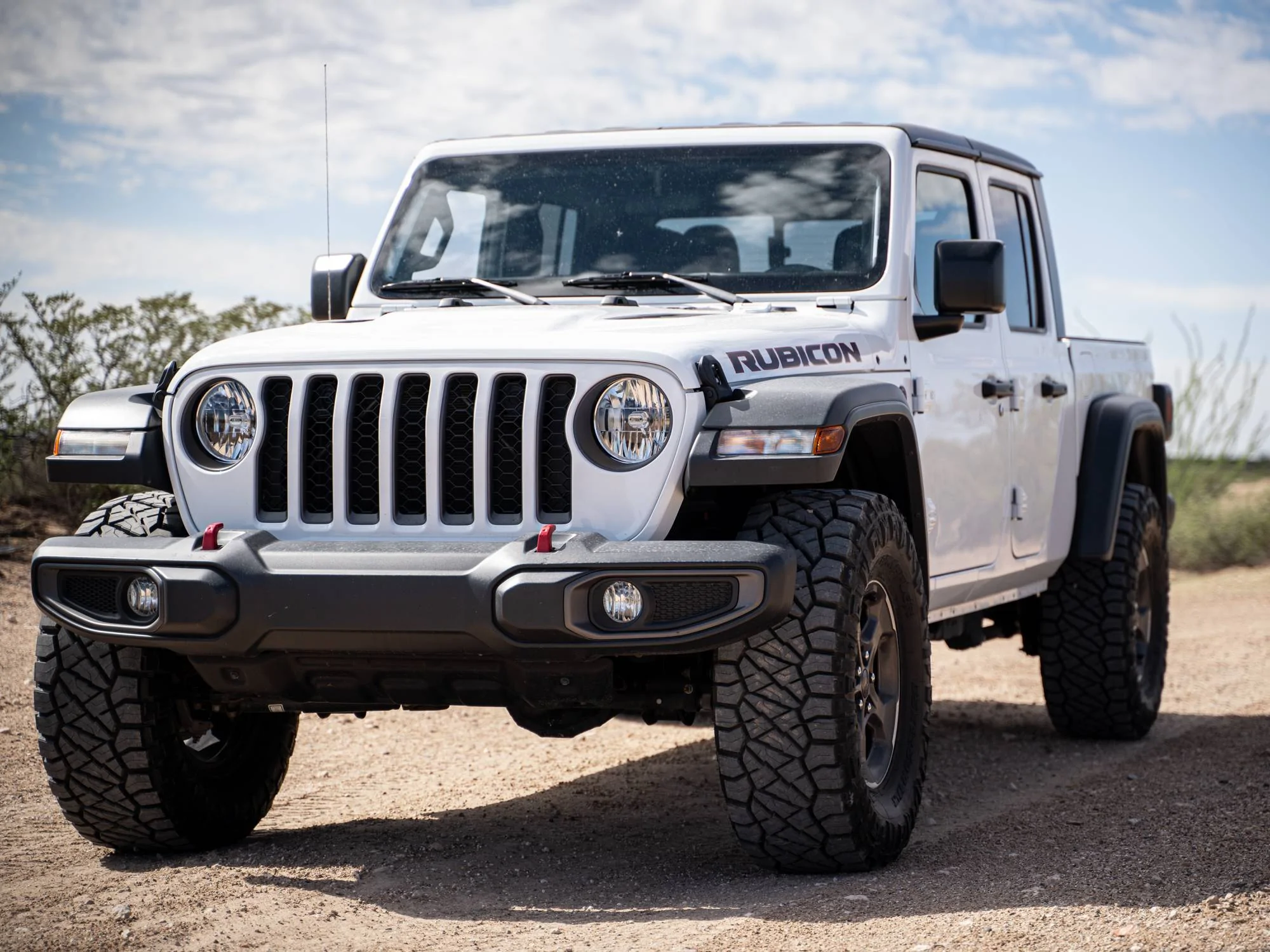

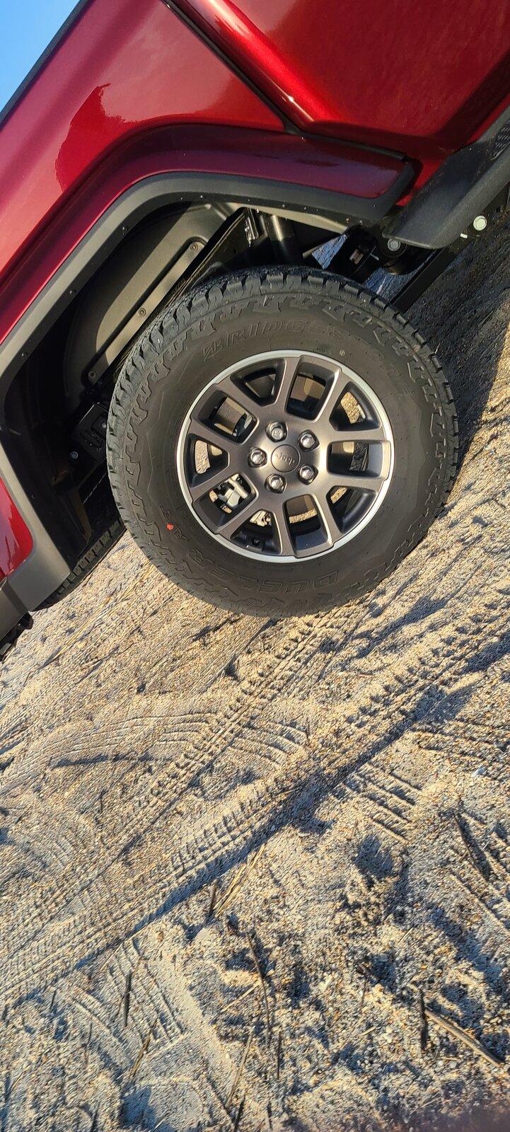

Ok, I don't have the budget to replace my tires and my wheels at the same time, and since the Granite Crystal Metallic Aluminum wheels don't look too bad, I'll keep them for a while. What 35s do you guys recommend that will fit on my stock 18" wheels AND won't kill my bank account?
So... nice, budget friendly... but as much attitude as I can get. I understand I haven't given a dollar amount and that's because I'm not sure what it will be, but 5 tires, even at $250 a piece, is $1250, and to me that's a significant investment. I am up to hear what tires y'all suggest. Thanks, in advance.

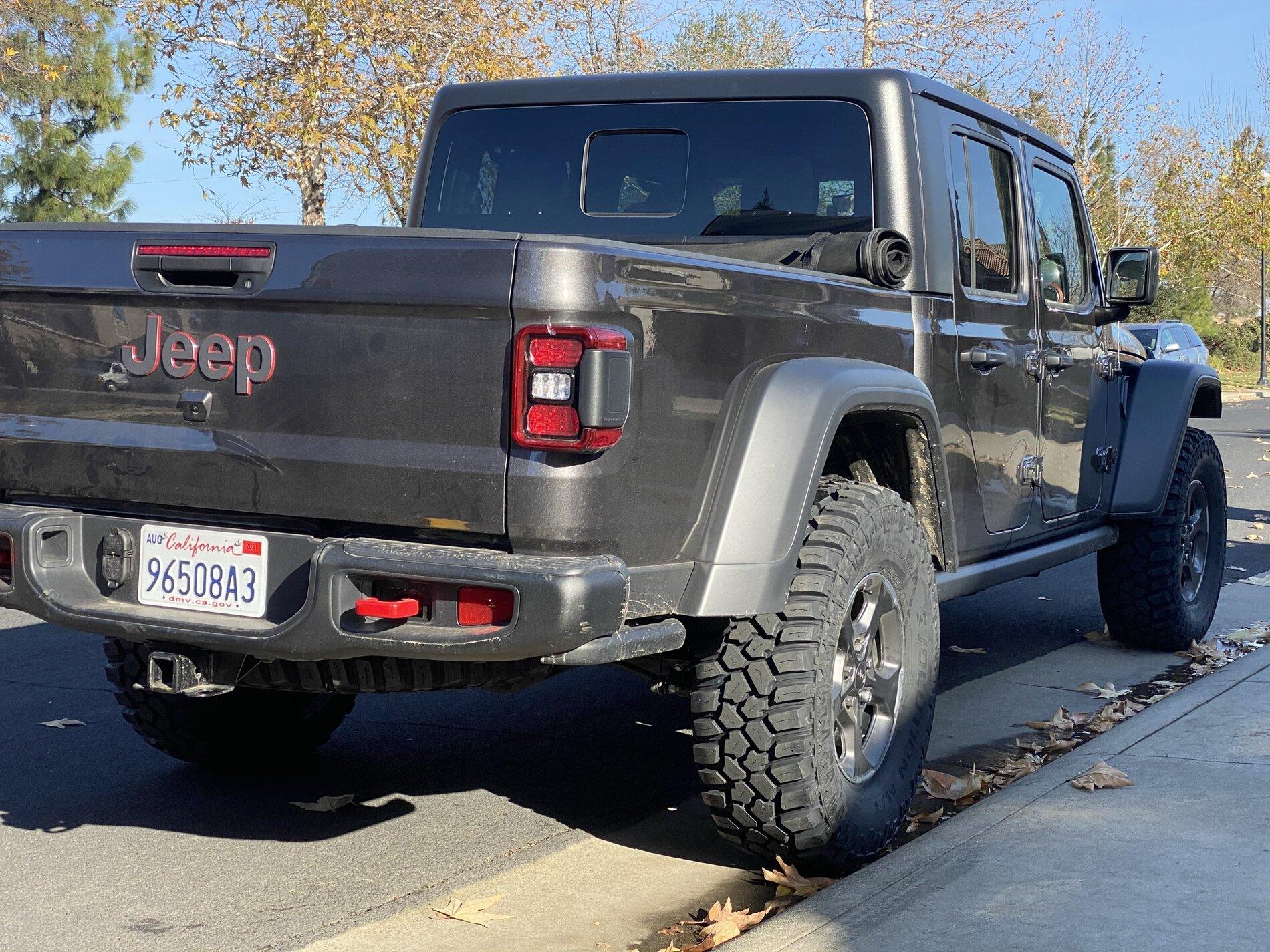

Im running 35x12.5x17 cooper evolution MTs on my stock wheels. The tires are inexpensive and are not heavy at all.

I believe the only 35” tire that you can run on the stock 18”x7.5” rim is a 285/75/18. There are a number of brands that sell this size, downside is most if not all are load range E and fairly heavy.
