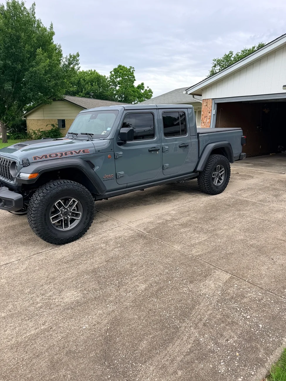

35 12.5 17 Goodyear Ultra Terrain AT
Stock with no lift.
Also curious what psi everyone else is using.Currently at 35 psi and it seems to ride ok so far.

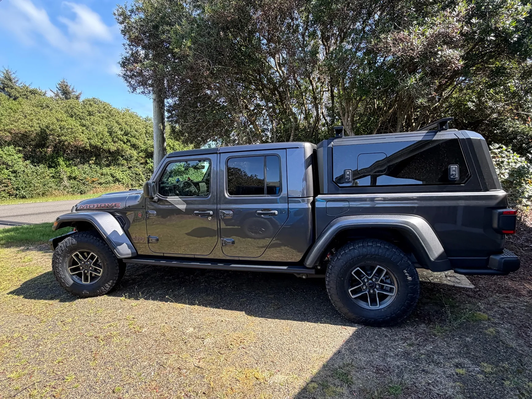

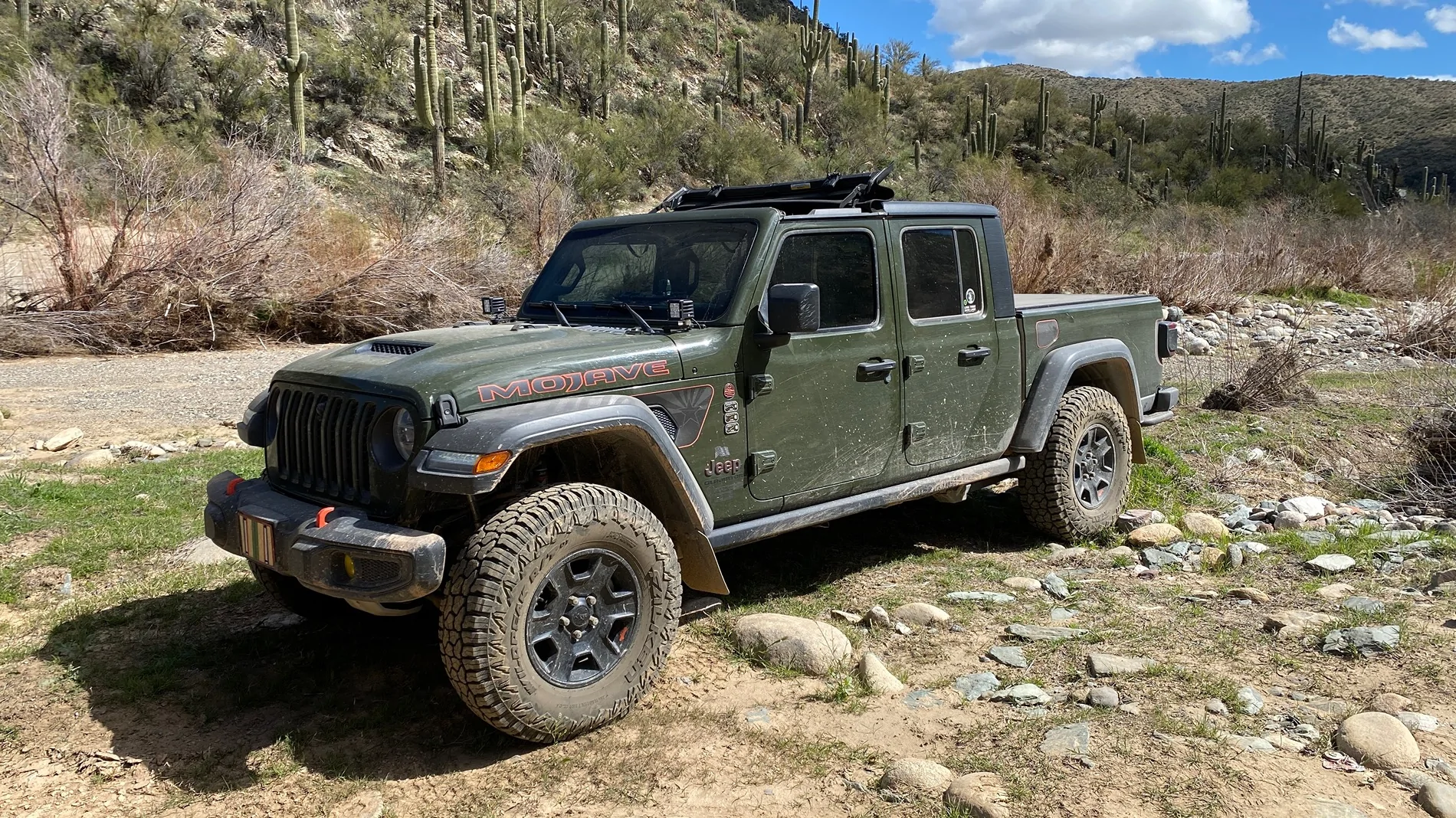

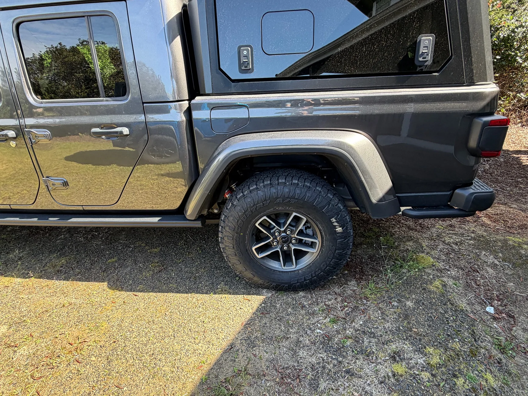

Stock, no rubbing on light trails with Toyo AT3 35x10.5R17. I have a small lift if needed, but they’ve been great so far.

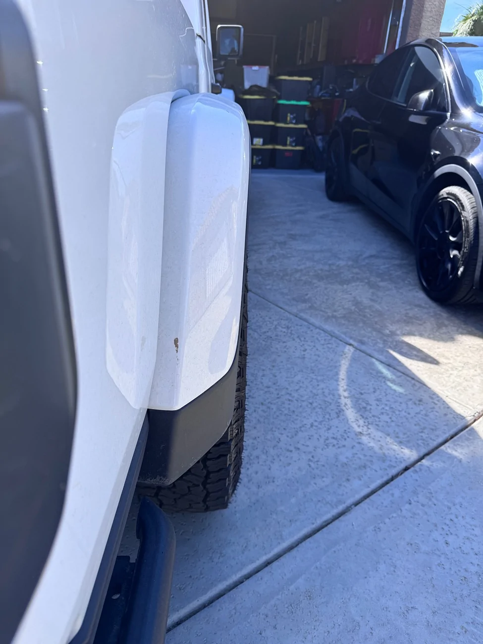

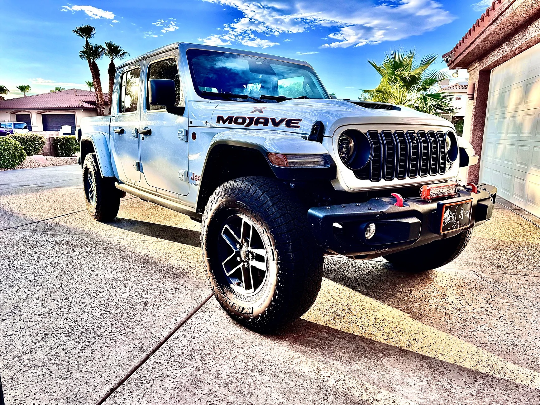

C1 Rating? Any photos from the front ? To see how much these stick out?
SECTION WIDTH 35ASPECT RATIO 11.5RIM DIAMETER 17"OVERALL DIAMETER 35"RIM WIDTH RANGE 7.5" - 10.0"WEIGHT 68.5 LBSTREAD DEPTH 18/32"LOAD INDEX 118LOAD RANGE C1MAX PSI 50 PSISPEED RATING Up to 106 mphSIDEWALL DESC. Black Side WallWARRANTY 60000

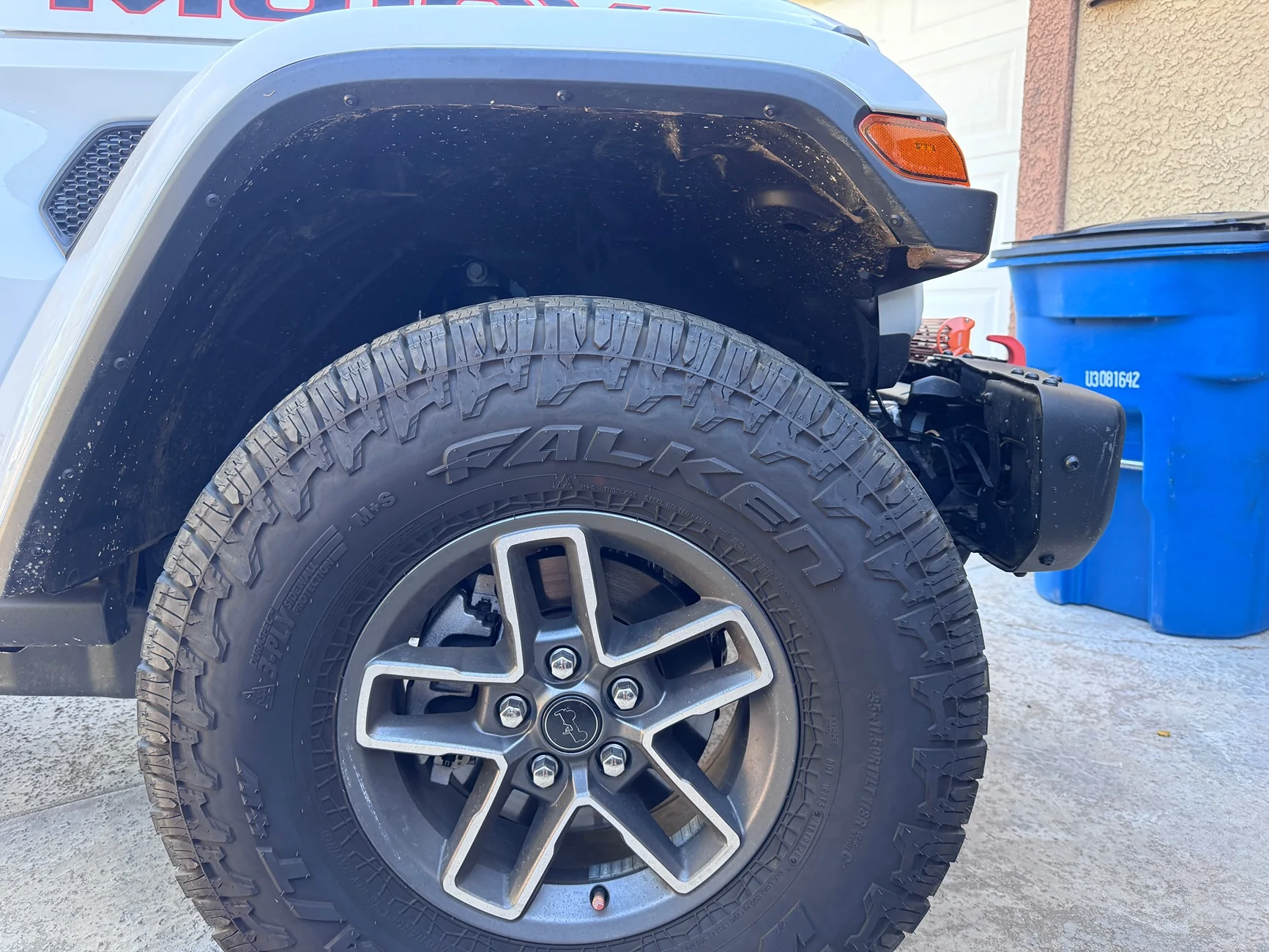

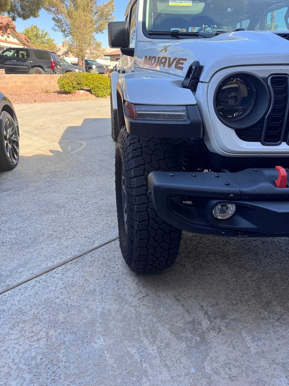

Yes C Rating, I see no need for an E rated tire for my uses. Super comfortable ride at 37-42 PSI (variations due to extreme desert temp changes during an average day, not me playing with the PSI) on road. Combined with the Mojave Fox shocks great shock absorption on paved roads AND trails. Haven't found a reason to air down these at all so far. Washboard desert roads are totally negated and my wife laughs when I take on speed bumps at full speed because "they don't apply to me". 🤣
The threads on the 11.5s totally tuck under the fenders of the Mojave X (and I'm assuming the Rubicons too. I was running the same tire in 285(11.22" wide)x75x18 on my Overland and they did not stick out either. The actual sidewall sticks out just a hair, in these pictures the front wheels were turned just a little to the left so you get a better idea from the pictures of the rear tire.
Jeep Gladiator 35s on Mojave with stock wheels. IMG_8705
Jeep Gladiator 35s on Mojave with stock wheels. IMG_8707
I like this look better and it was the main reason (besides doing my best to avoid ANY rubbing) I went with the 11.5 vs the 12.5. and I also figured an extra inch of width would buy me nothing with my actual uses.

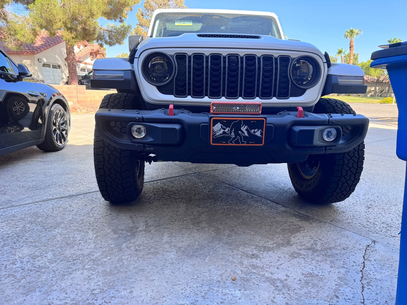

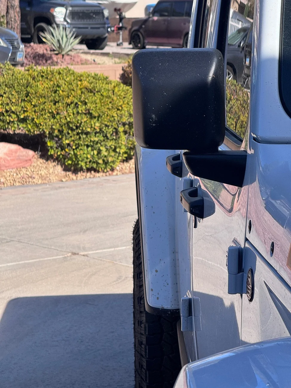

These are pictures from the front
Jeep Gladiator 35s on Mojave with stock wheels. IMG_8706
Jeep Gladiator 35s on Mojave with stock wheels. IMG_8710

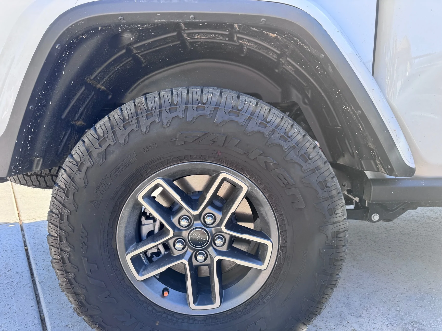

And this is how much clearance I have in the wells.
Jeep Gladiator 35s on Mojave with stock wheels. IMG_8708
Jeep Gladiator 35s on Mojave with stock wheels. IMG_8709
Actual height of the tire is roughly 34.5" fully loaded on the ground.

That is awesome!! Thank you for the additional photos!! Yes, mine is also a Mojave X. Ride is great with the stock suspension.
