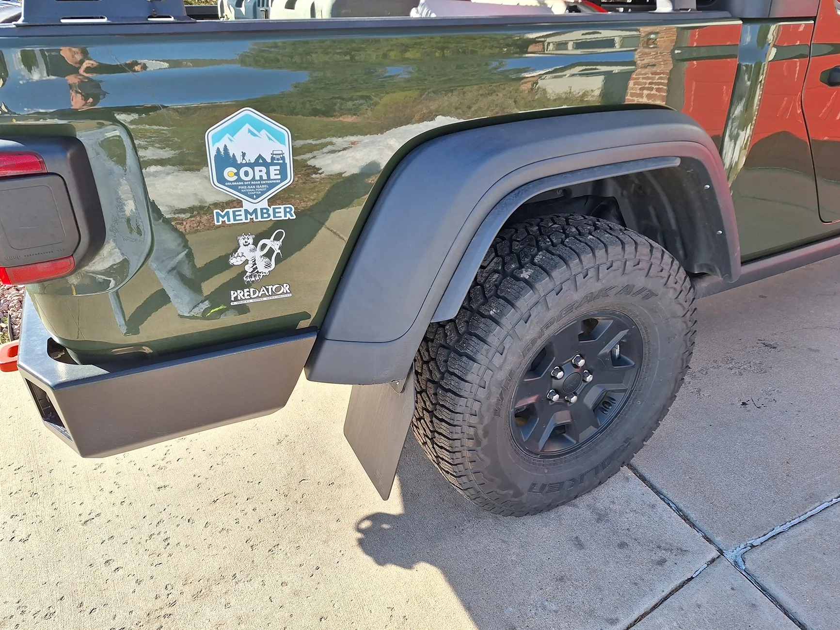

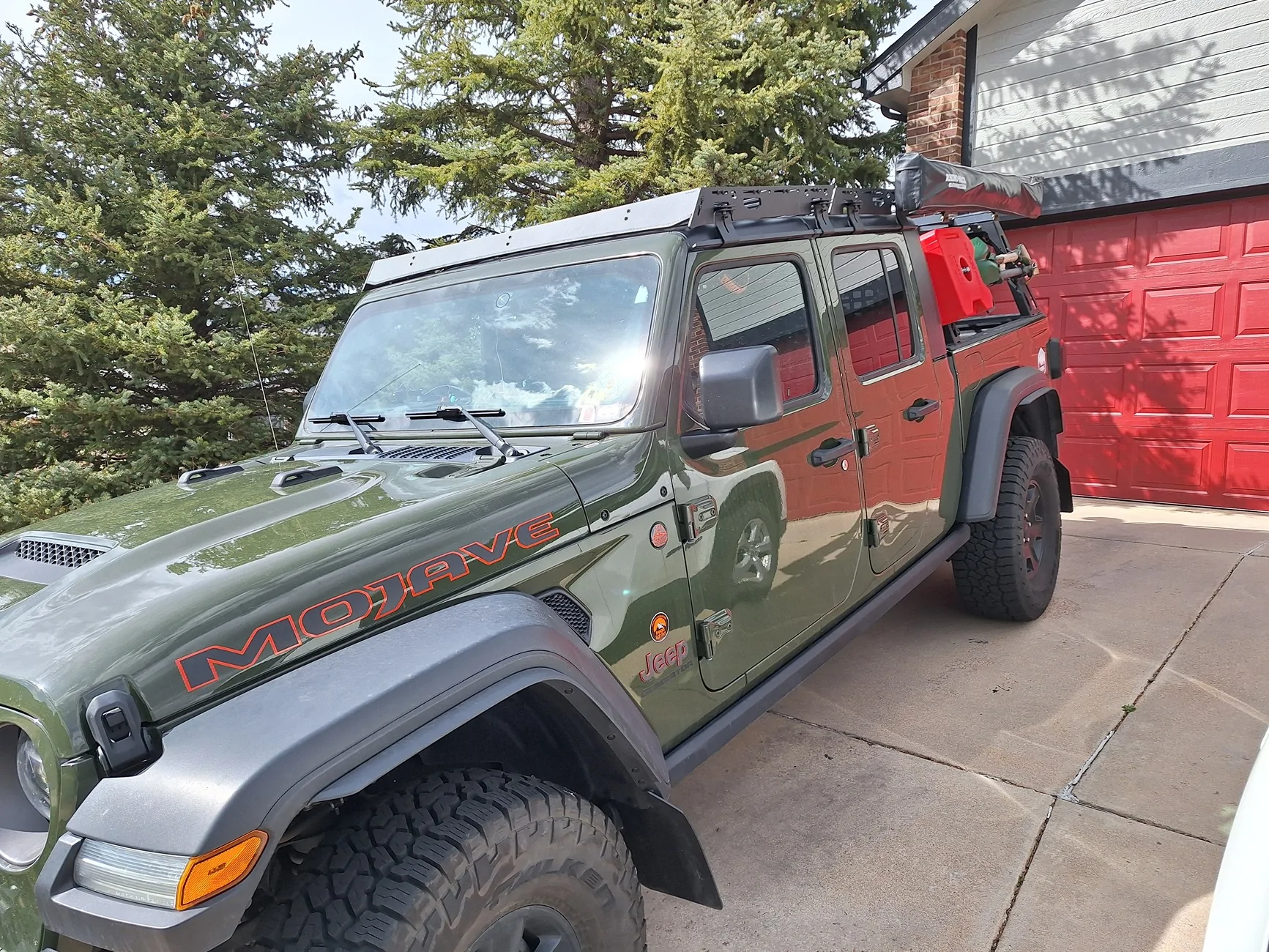

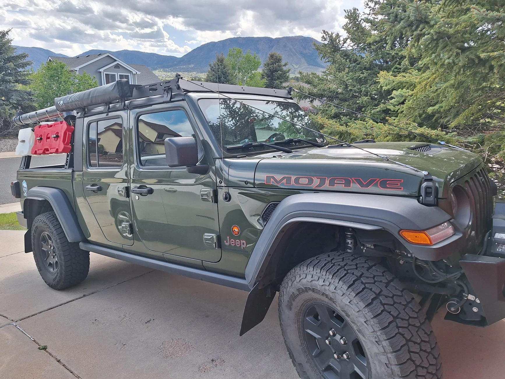

I have 35"x12.50" Falken Wildpeaks mounted on the stock Mojave rims. I do have an AEV Mojave 2" spacer lift and I added the Mopar fender flare extension and Rokblokz removable mud flaps which keep my side winter clear during winter months.
Jeep Gladiator 35s on Mojave with stock wheels. 20240319_173820
Jeep Gladiator 35s on Mojave with stock wheels. 20240422_161831
Jeep Gladiator 35s on Mojave with stock wheels. 20240527_155635

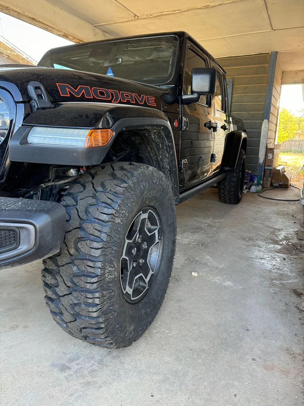

I’m running 315/70s here on stock rim, stock height with no rub and very minimal poke almost exactly flush
Jeep Gladiator 35s on Mojave with stock wheels. IMG_4335

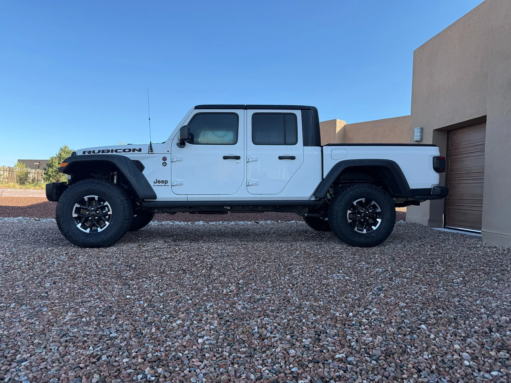

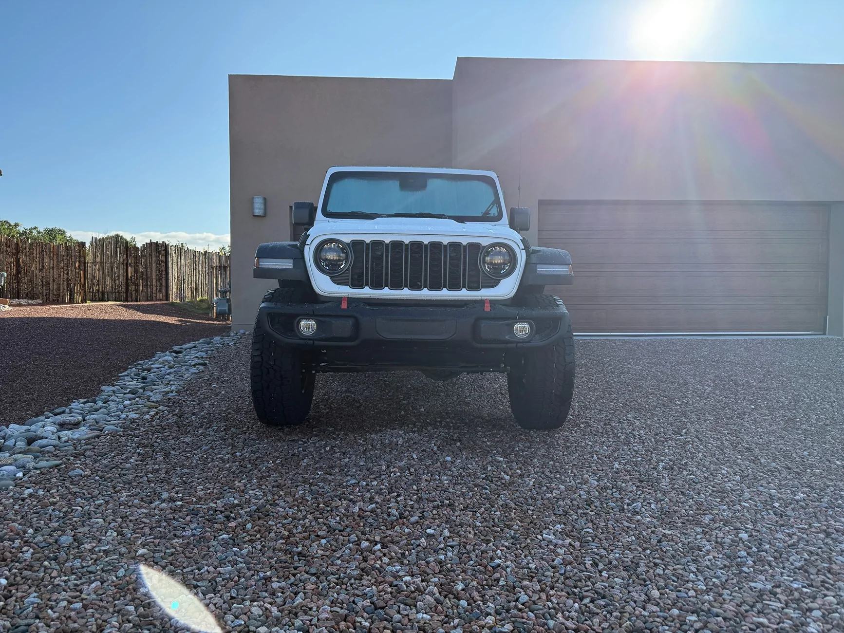

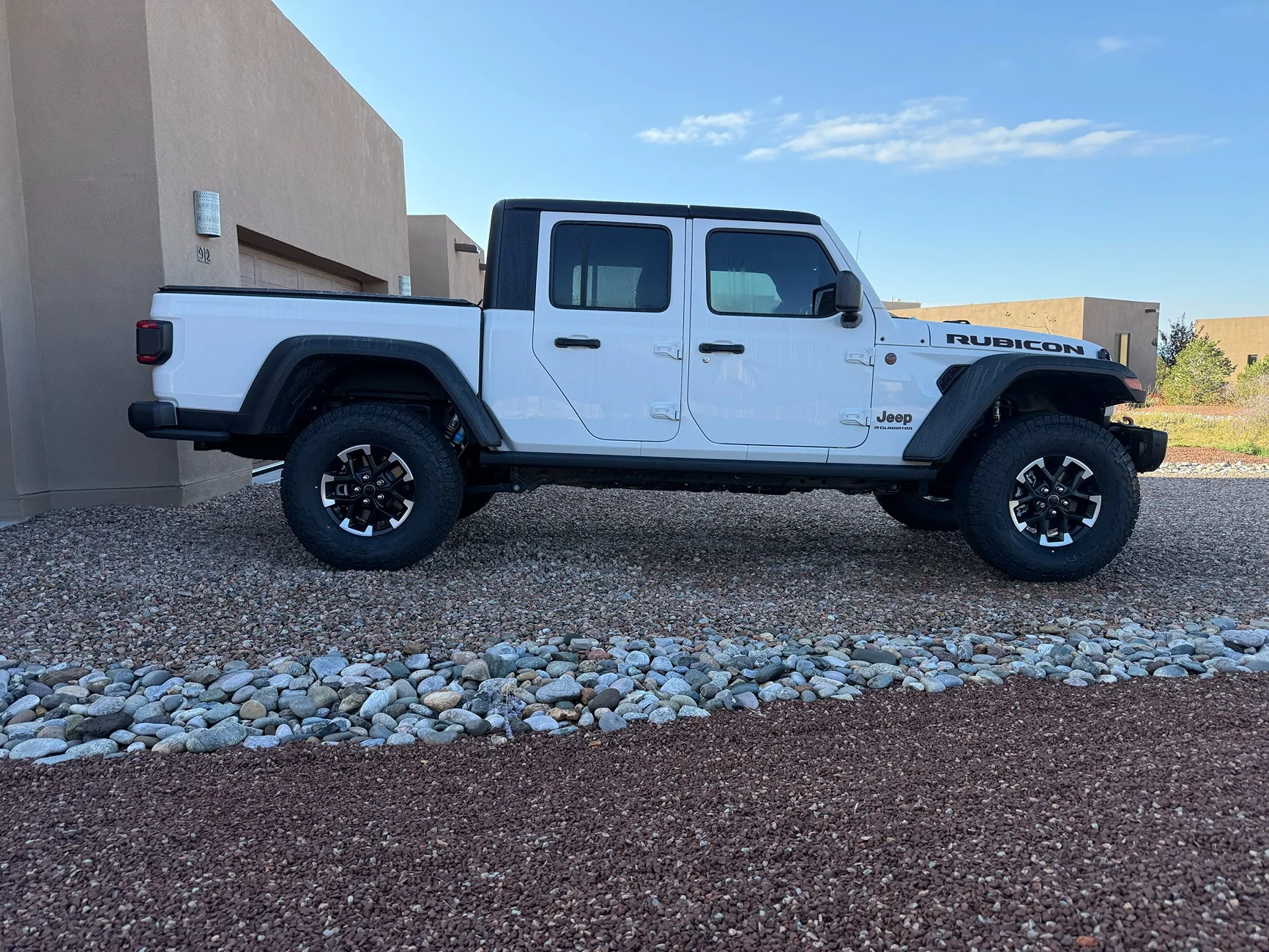

Jeep Gladiator 35s on Mojave with stock wheels. IMG_2792
Jeep Gladiator 35s on Mojave with stock wheels. IMG_2791
Jeep Gladiator 35s on Mojave with stock wheels. IMG_2790
scout327
Aug 12, 2025
42
Santa Fe, N.M.
2025 Gladiator Rubicon
That looks great!
Did you go with the Bilsteins or Fox Shocks with the Mopar lift?
Bilsteins, I'm pretty sure that's all they use now.
btw, I'm from NJ (Monmouth County), where are you in that madness?
