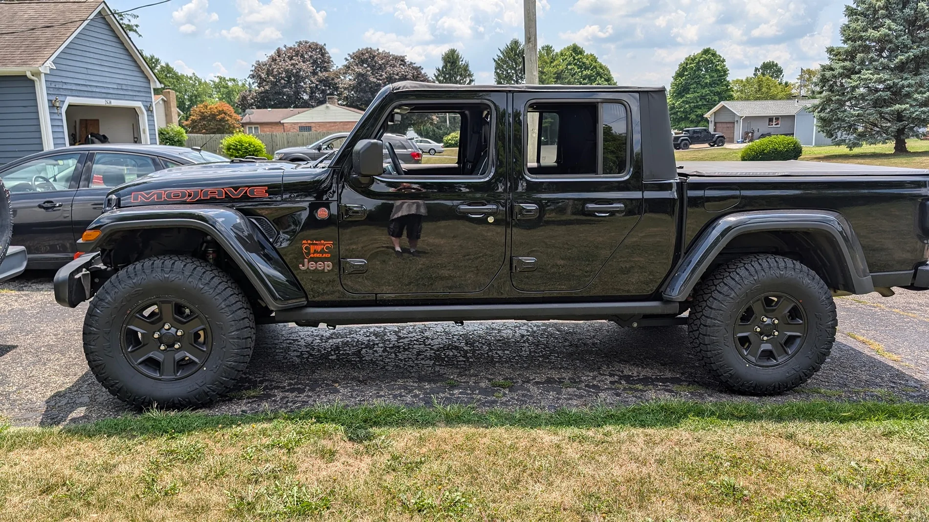

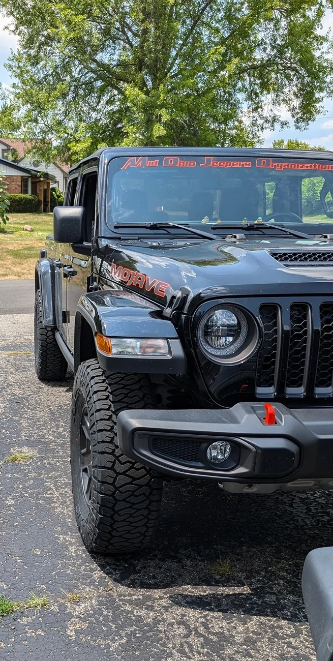

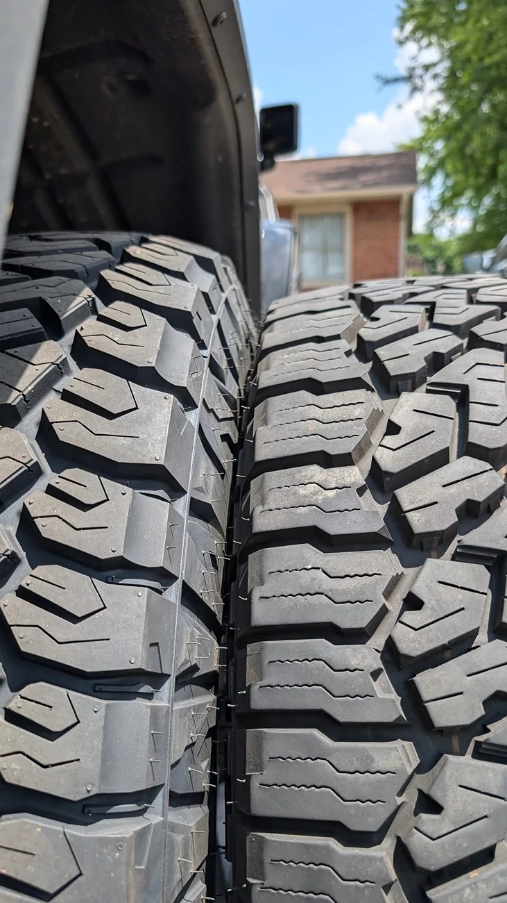

MT Baja Boss pizza cutters. Do it. They'll be about 34.5" naked... but a true 2" taller than your stock tires when mounted.
Mickey Thompson Baja Boss AT 255/85/17 (35" Pizza Cutters). | Jeep Gladiator (JT) News, Forum, Community - JeepGladiatorForum.com https://share.google/L1QhgENjdPMPOc0tu

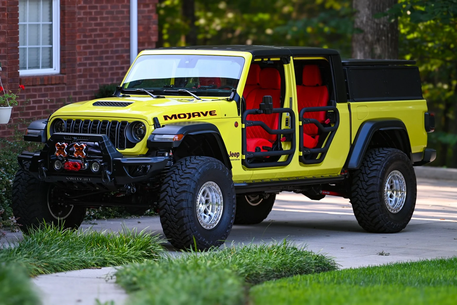

For sure - just wanted to touch on that. A quality spacer installed properly is perfectly fine. If my truck had the narrow axles I would not hesitate to run spacers and keep my stock wheels as Ive done before. Since I have the wide axles I don't have to this time around, though.
Yep! Same here. I have the wide axles and -38 offset wheels, so I got lots of poke.

See my post above. No spacers, no rub.
