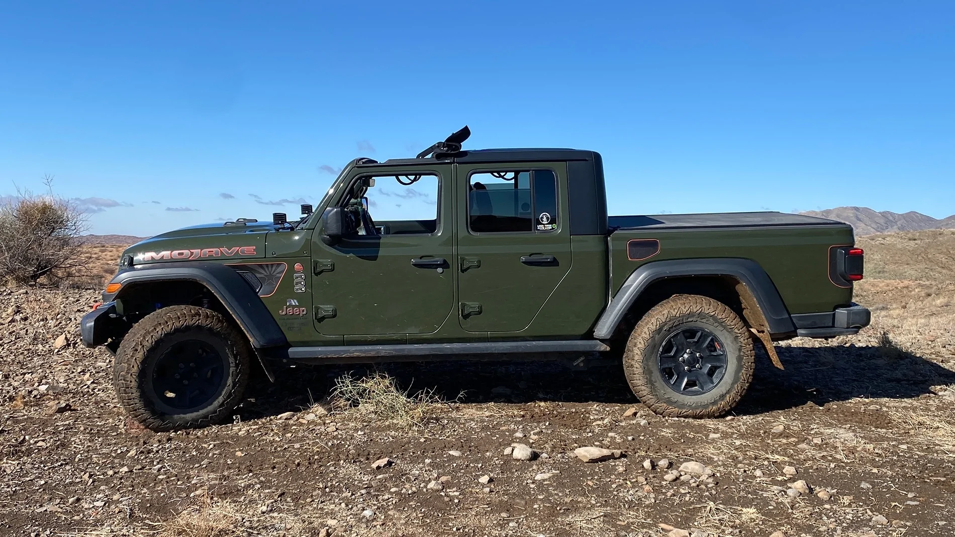

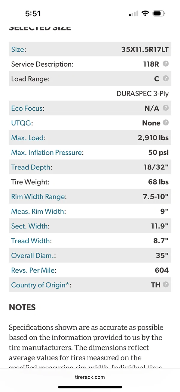

I have a 2022 Mojave and replaced the 33” Factory WildPeak tires with 35”x11.5” WildPeak tires. I’m very happy with the 11.5” width as it is lighter and in my opinion, it rides better than the 12.5” width.
